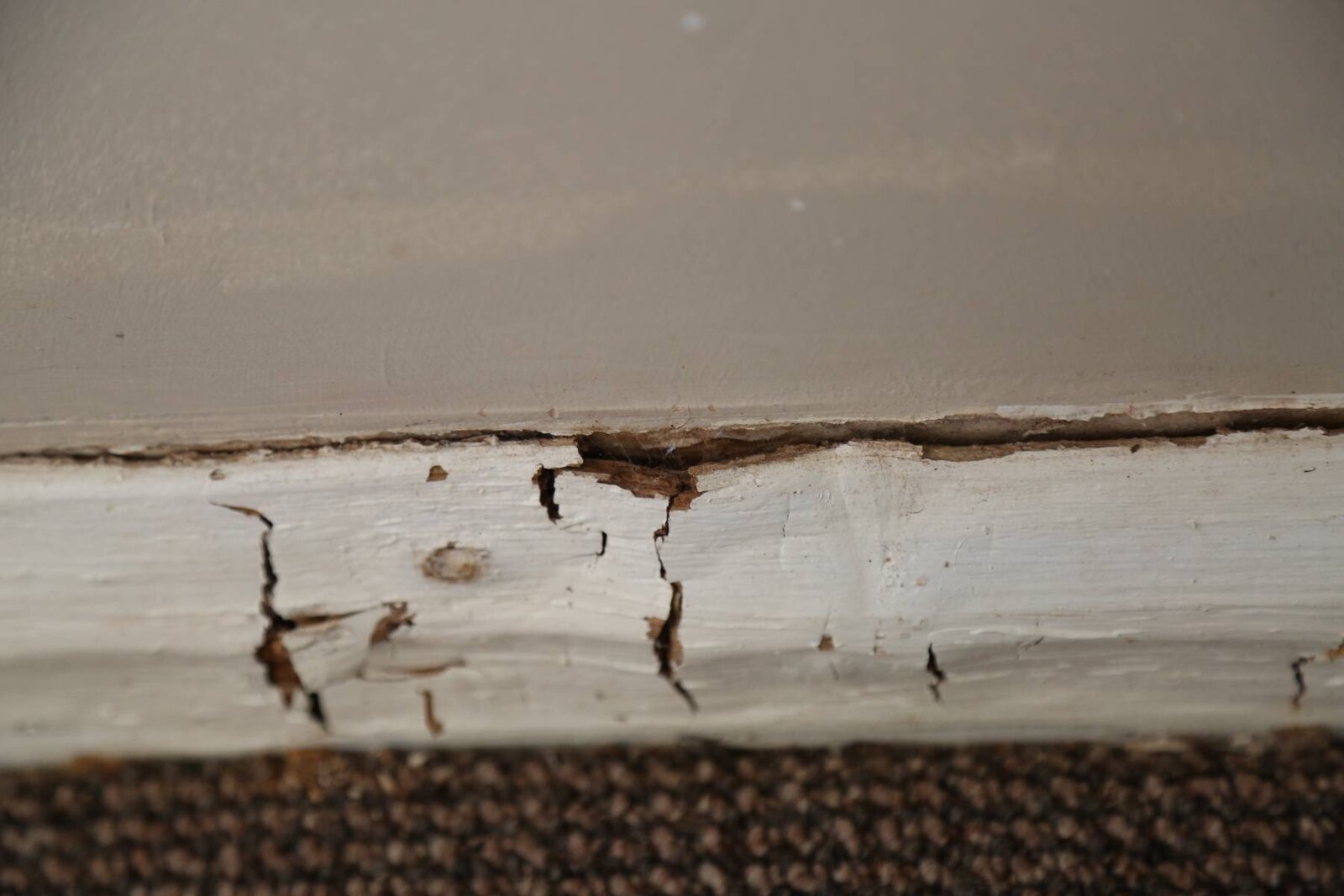

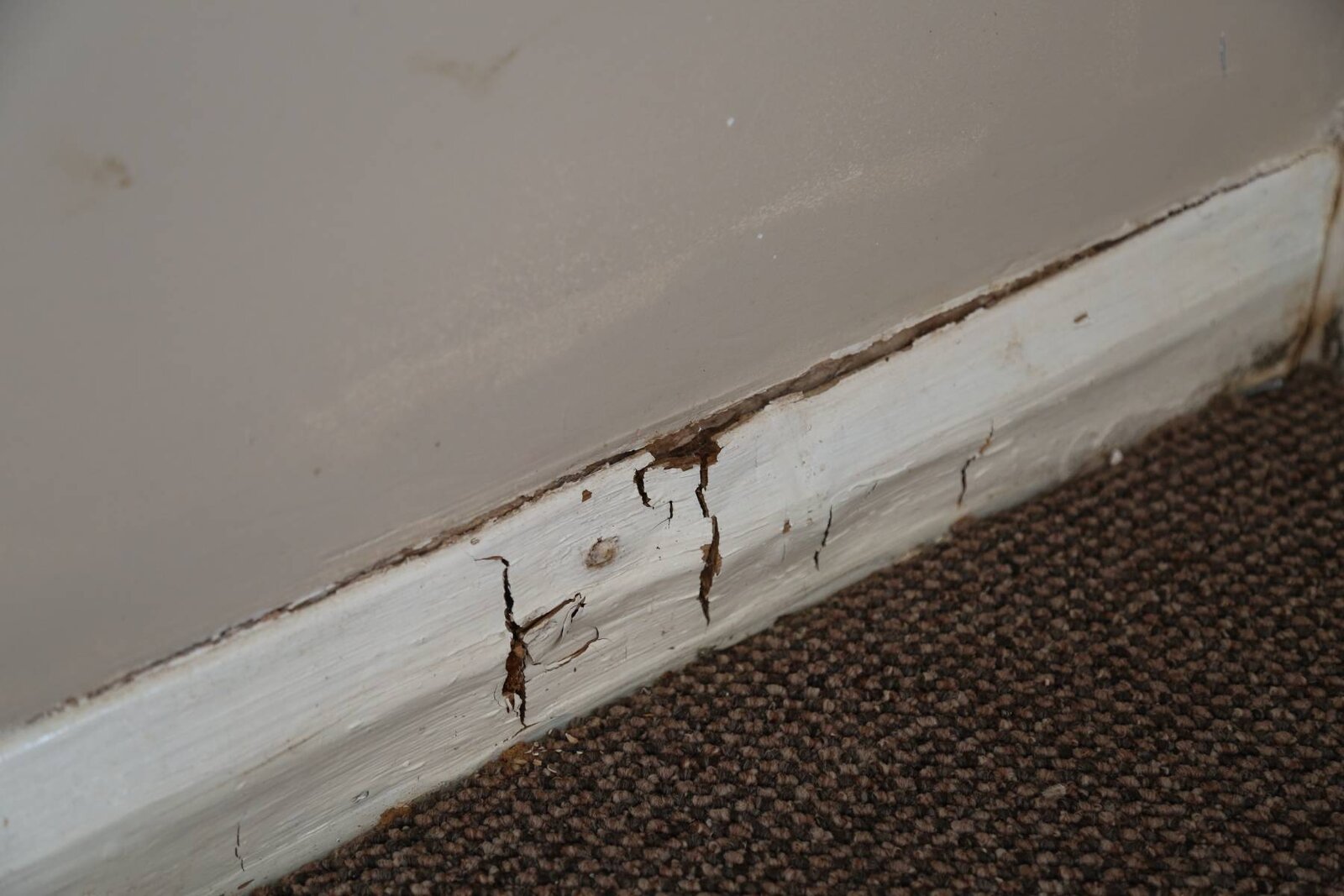

I looked around an auction property and saw that one of the skirting boards in the kitchen was rotten. Do you reckon it's wet or dry rot?
The affected skirting board is against the wall adjoining the neighbouring property. To the right is the outside rear wall. None of the other skirting boards seemed affected.

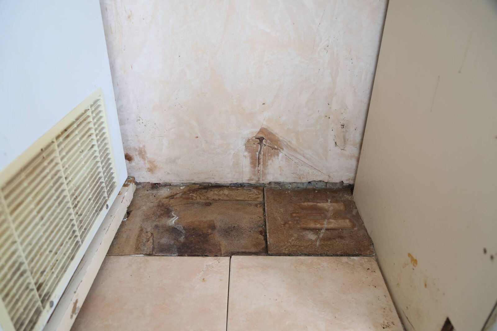

I've also included a picture of the flooring on the other side of the kitchen; might be nothing, but I wondered if there was a bit of white bloom on the top and side which might suggest problems below:
Thank you very much for any advice.
It does have a slight look of dry rot about it, but you need to open it up to be sure. Is there a floor void below?
Thank you for the reply. I'm not sure if there's a floor void; I wish I'd checked, but we only had a 15 minute slot to dash around so I just tried to shoot as many pictures of anything unusual as I could.

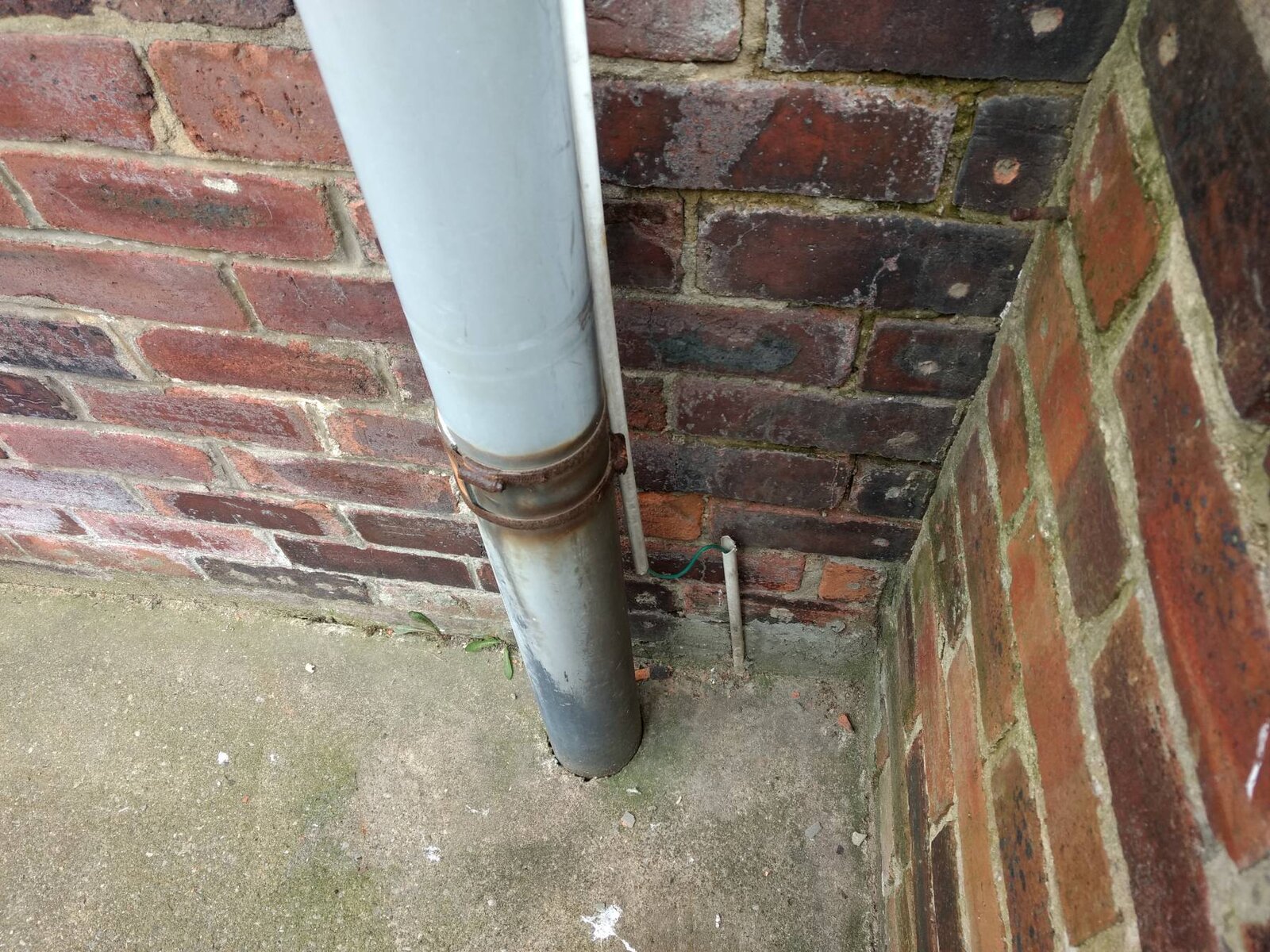

There were no other obvious signs of damp inside the house (except for black mould behind the cupboards on the rear wall), but the outside did. The property's rear wall (at the right hand end of the affected skirting board) had signs of a damp proof injection, as did other properties nearby, and below it was algae. Here's a pic of the rear wall from outside (the wall to the right is the garden wall)
The front of the house had lines of efflorescence, either from the broken downpipe or because there was no damp proof injection.
