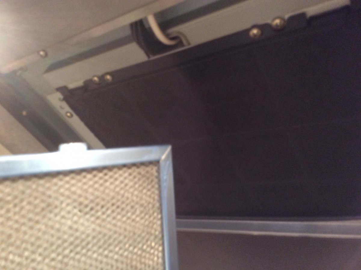

1) in the pic you can see silver filter which goes at the top - this is what I cleaned in dishwasher - is this the right method to maintain? Maybe every month?
2). Then you have this black thing under that as you can see in pic
Sorry I thought it was empty but is this charcoal filter? Why do I have this if mine has an outside vent? And how do I maintain this going forward? How often do I change?

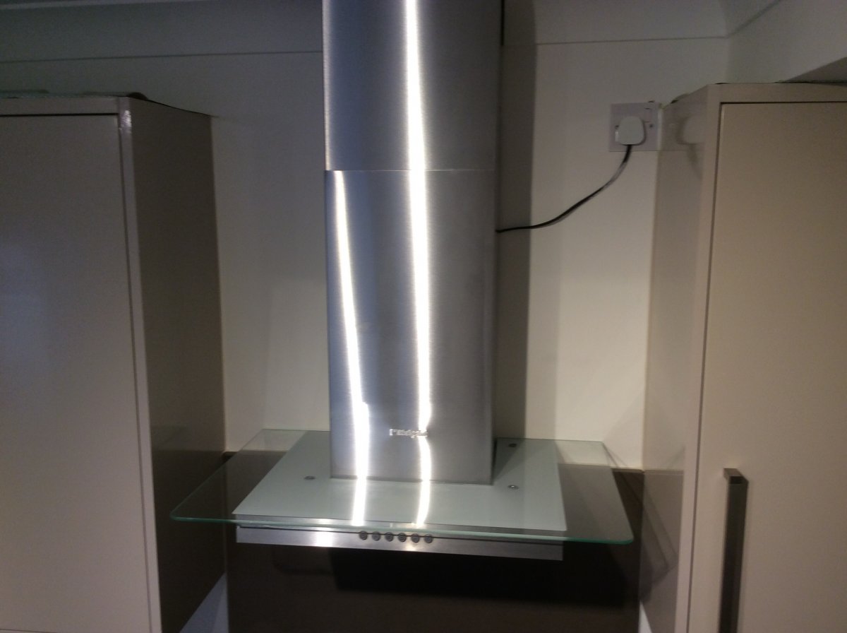

Can you please just let me know if it's safe to cover the glass top so it doesn't get gressy plezde
Hi guys can I cover the glass top bit of my hood so it doesn't get greasy or is this a fire hazard pls can you advise?
Depends what you mean by covered? I'm sure if you wrap it in paper it'll be a bad idea. And whatever you cover it with will get greasy anyway so whats the point? Might as well just clean the glass and have it look nicer.
