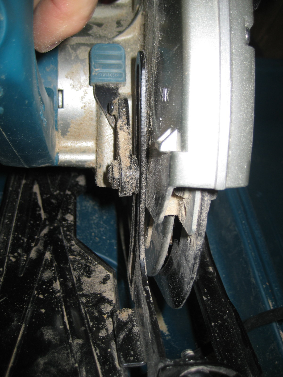

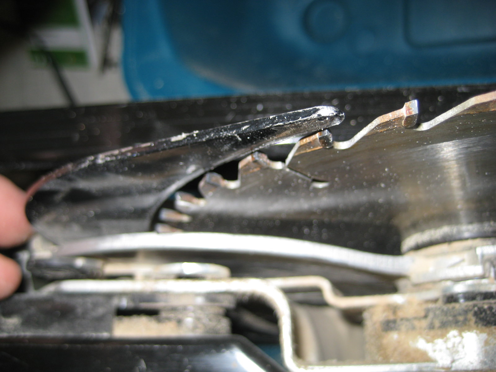

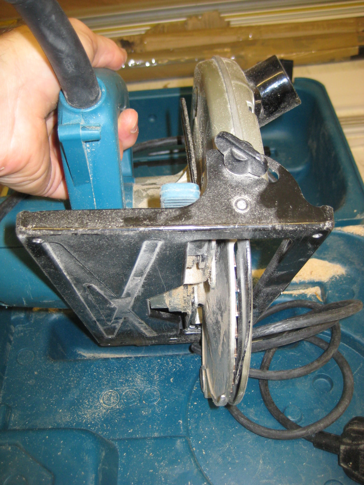

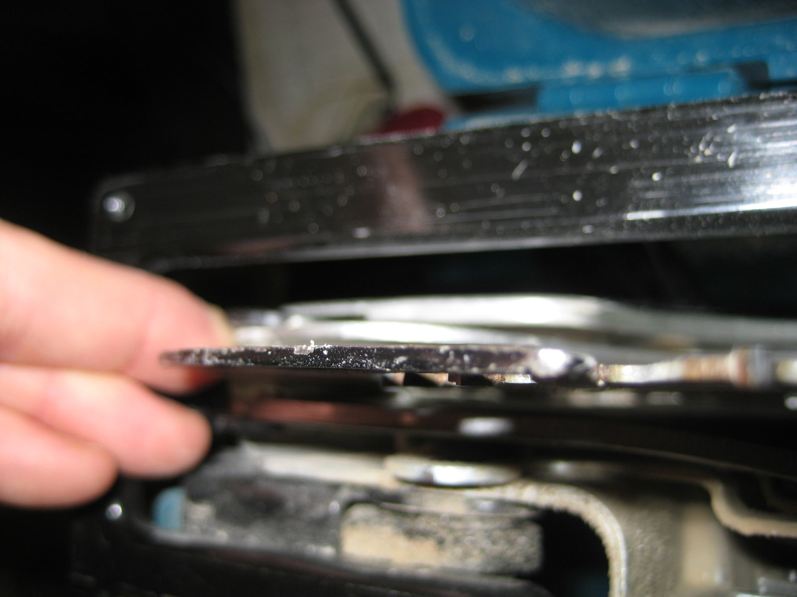

I have a Makita circular saw, it was a lovely bit of kit - until it was trodden on (not by me).
As a result the plate/rest bed appears warped, and now when cutting it wants to wander off the line - (quite a bit).
I have tried re-aligning things but had no joy, wonder if anyone else has solved such a problem.

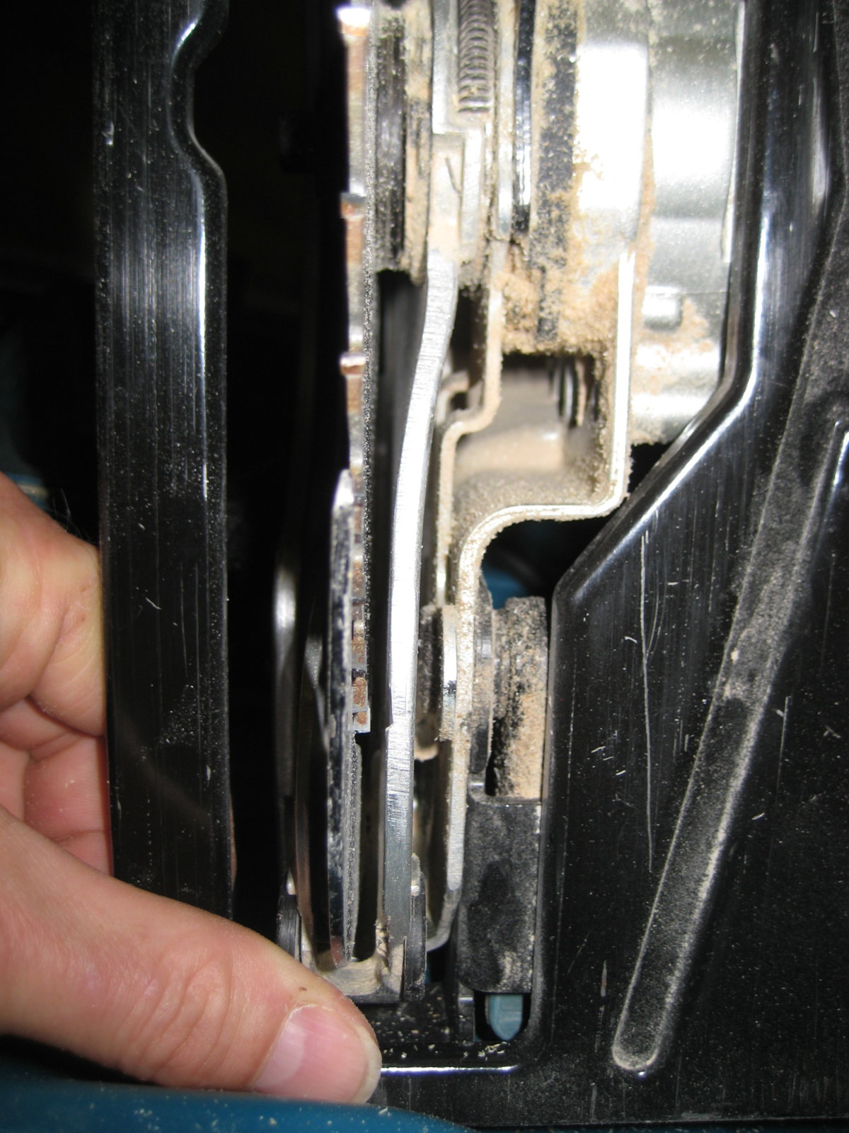

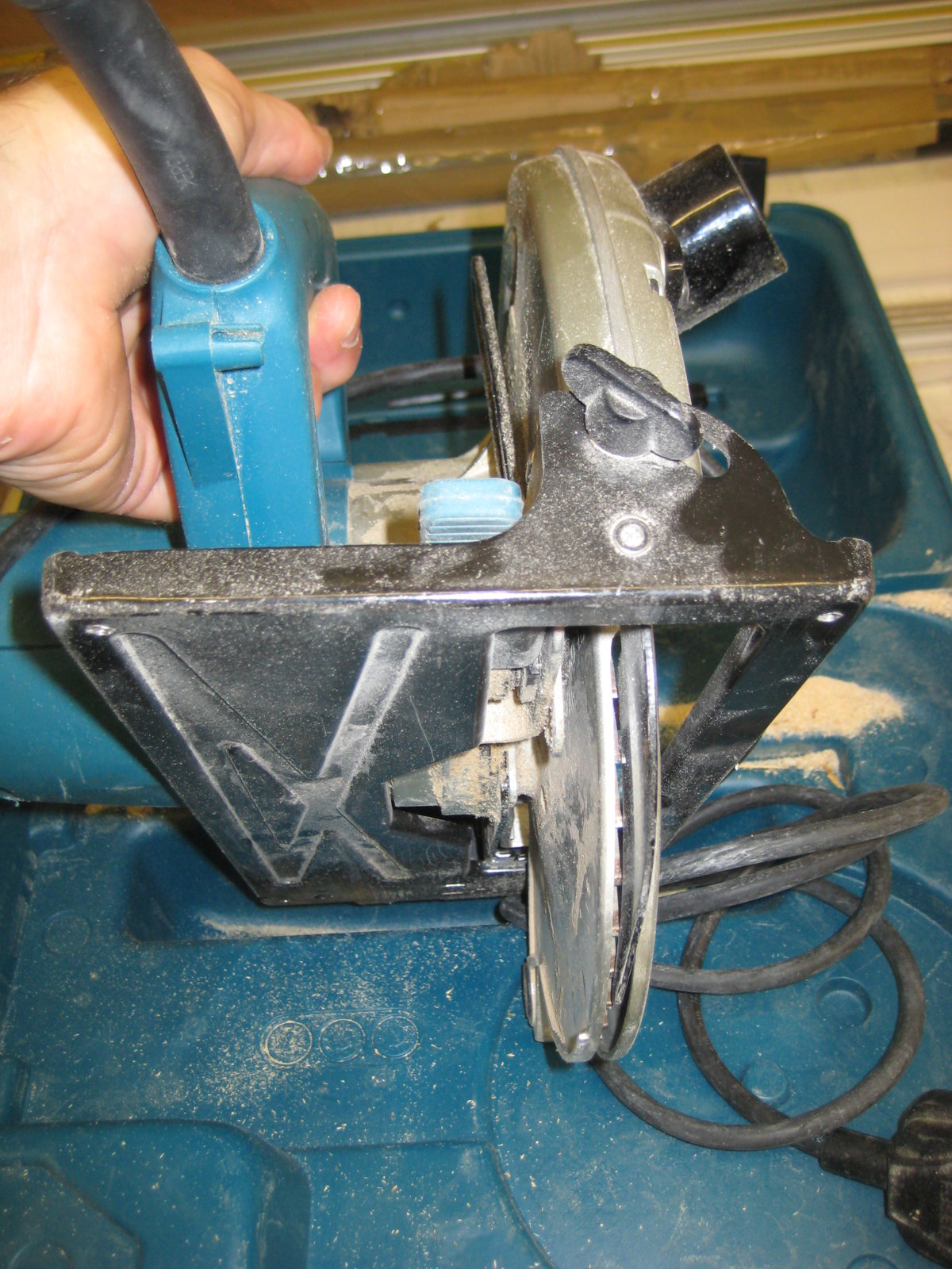

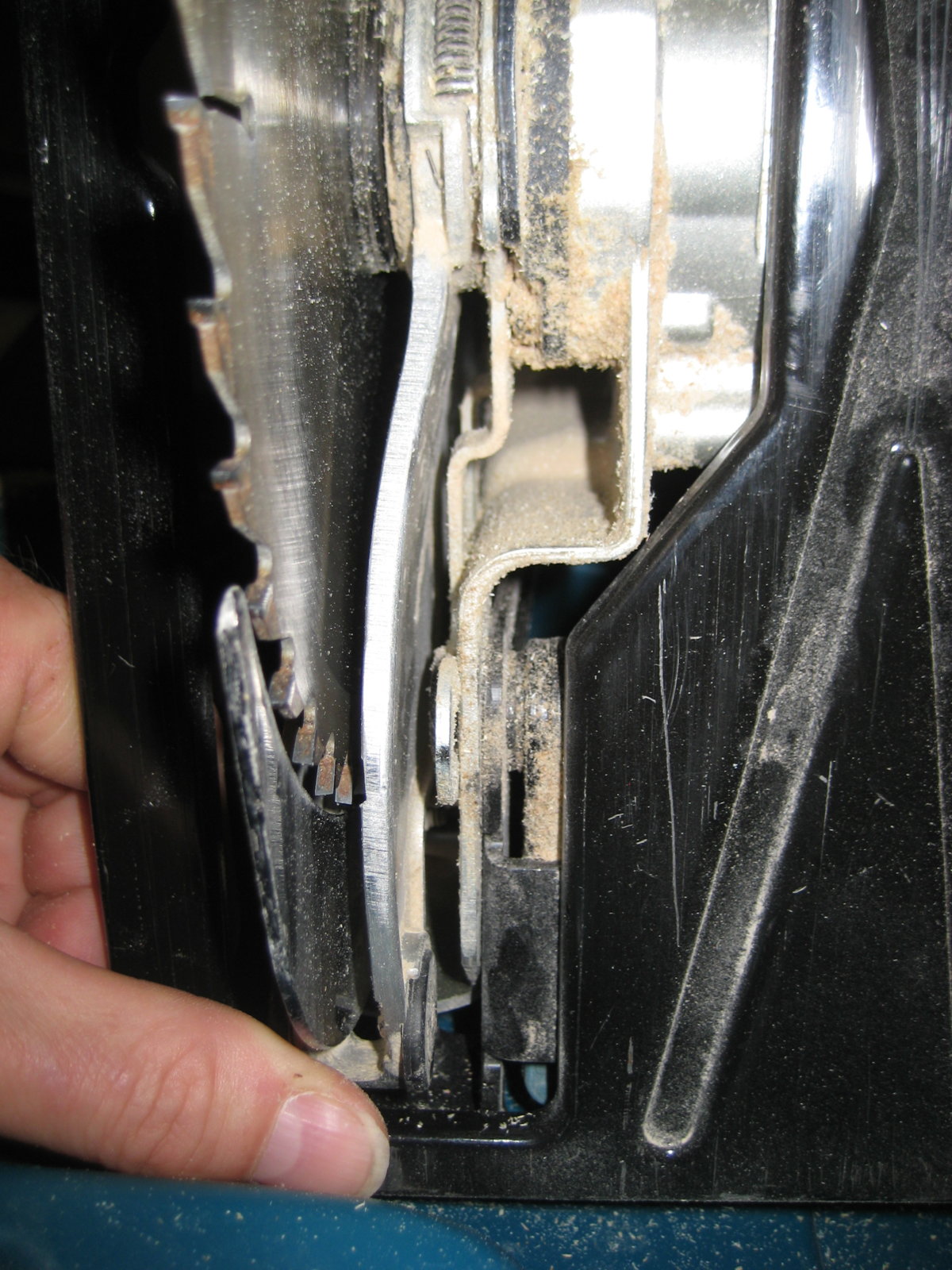

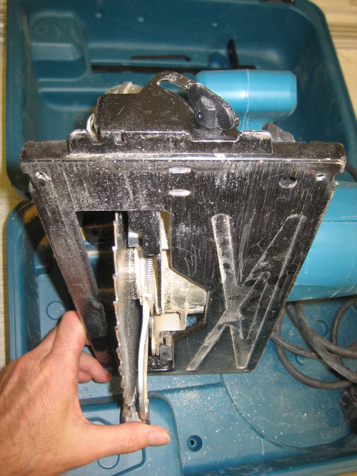

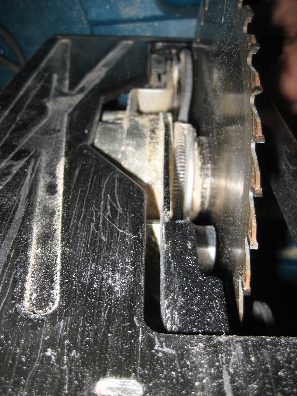

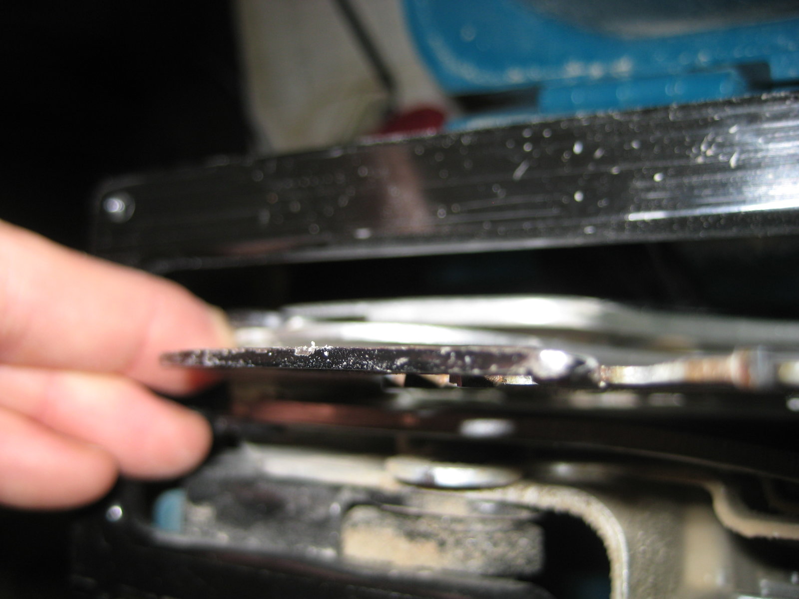

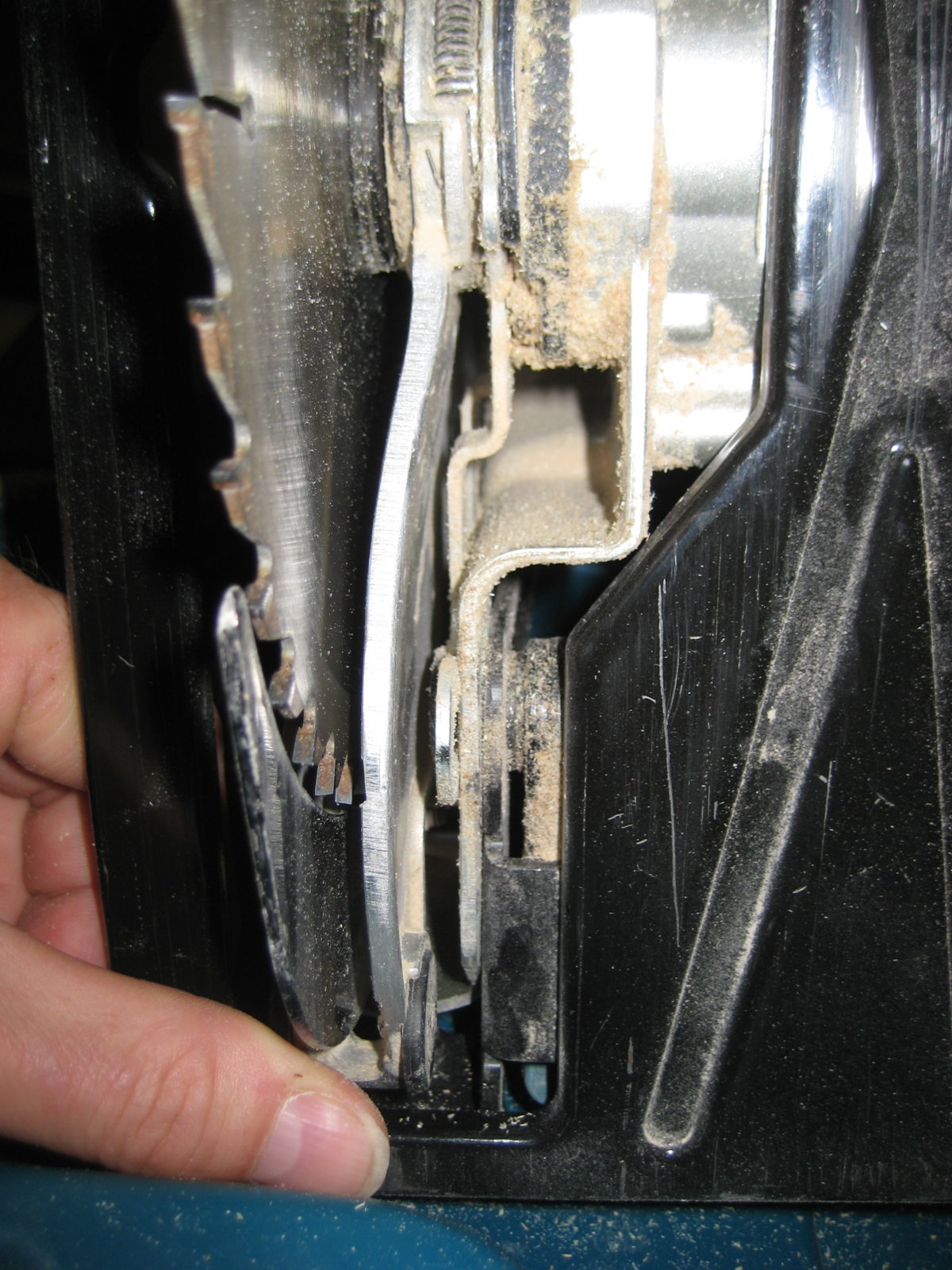

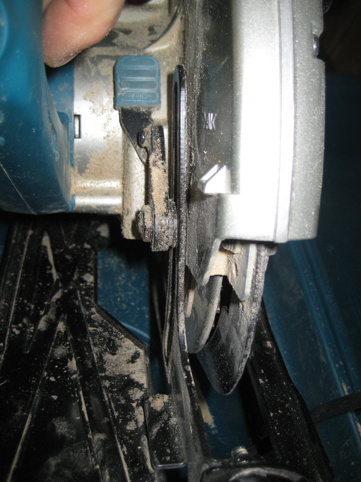

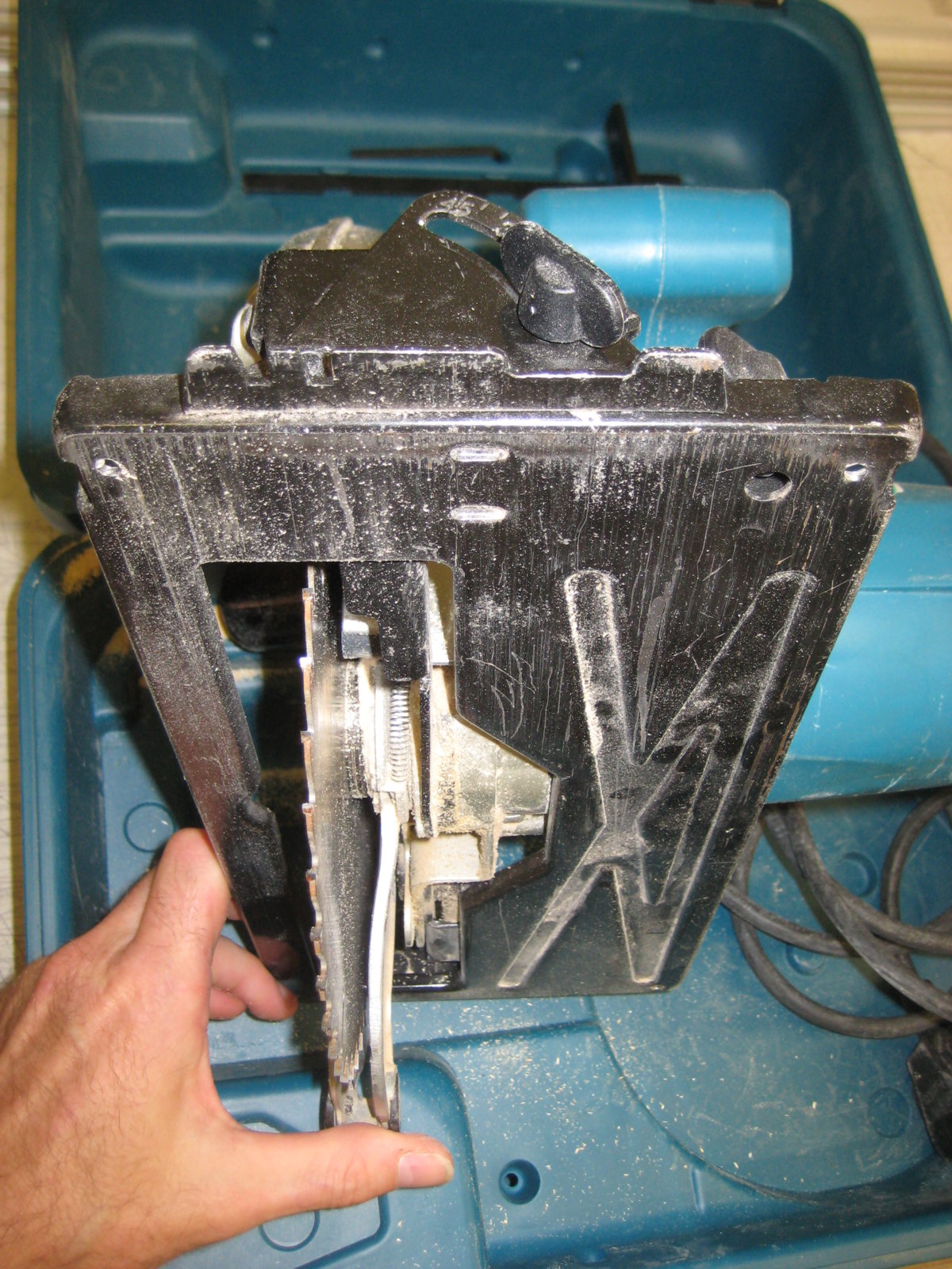

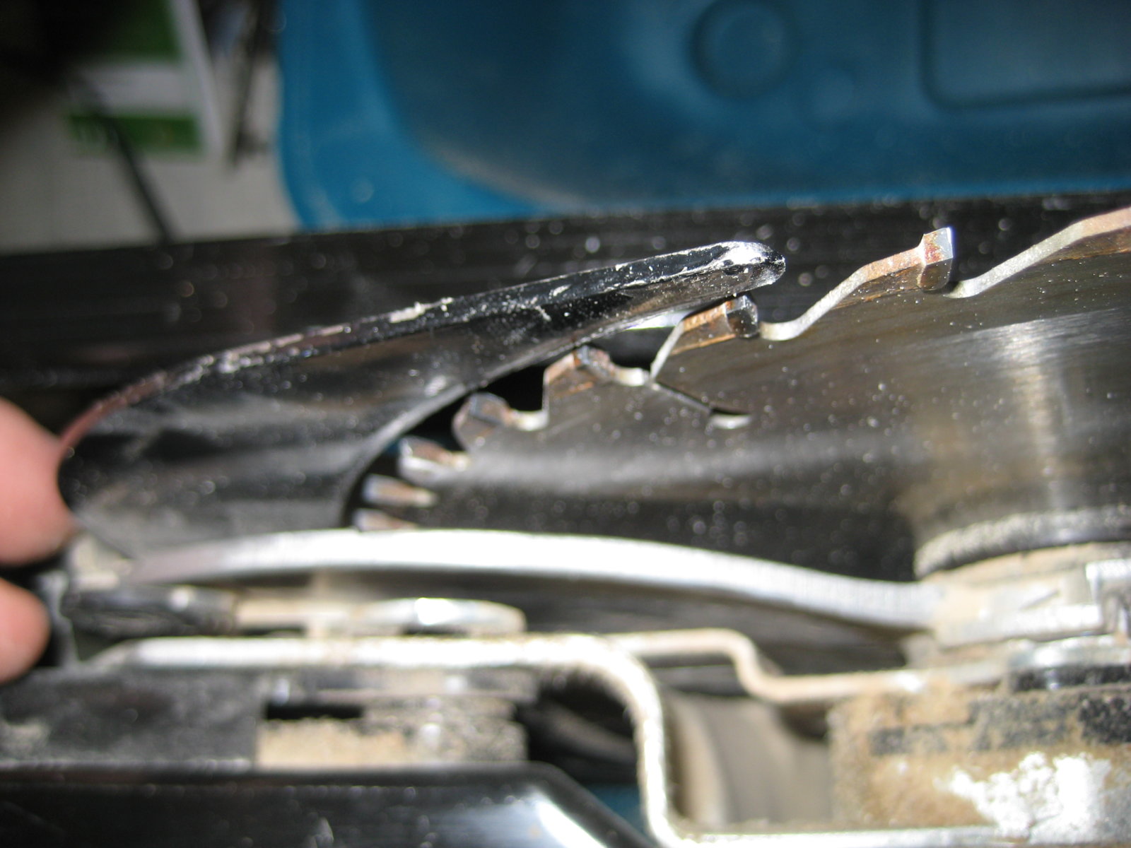

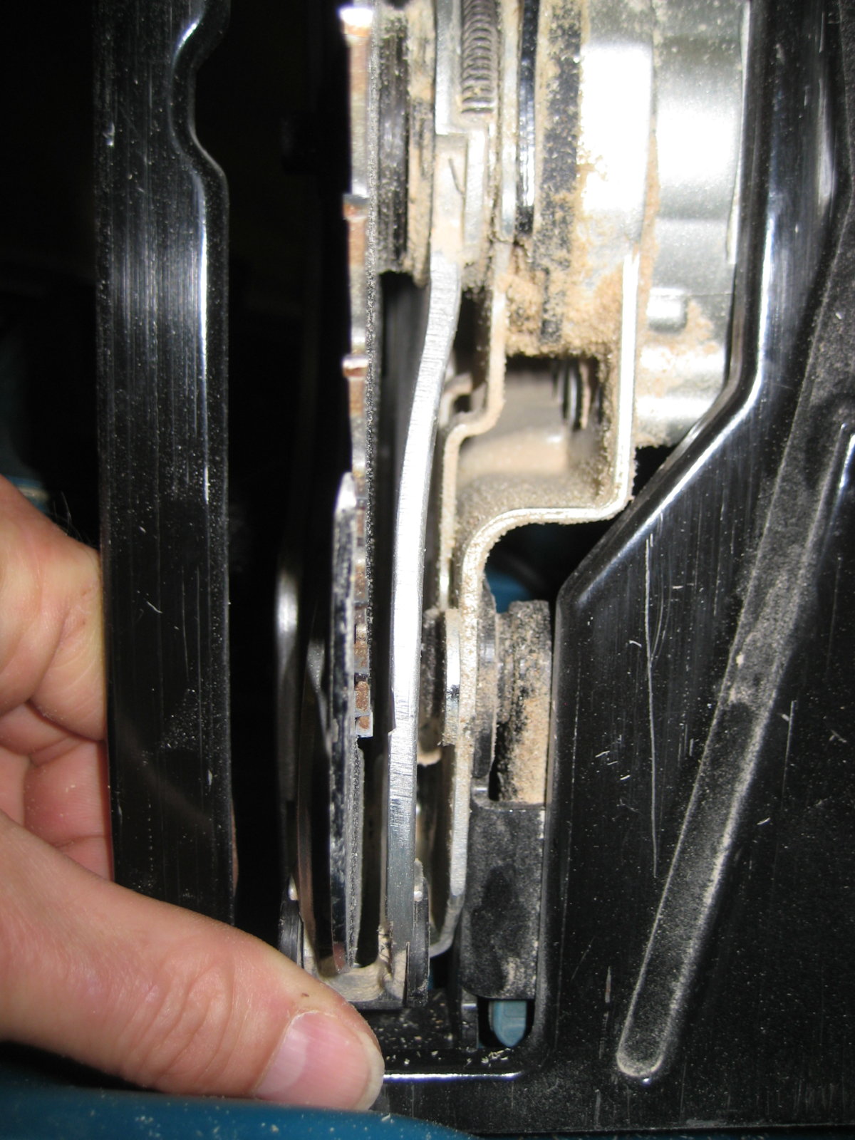

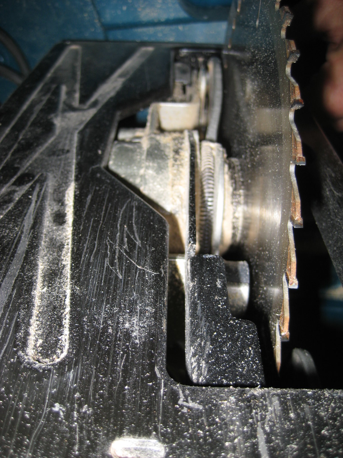

It was a good accurate tool, not now thanks to this clumsy idiot, it appears the plate that runs down the back of the blade is bent, the bed is twisted, and the locking mechanism that allows cut depth to be adjusted is also bent ...
1) bed is twisted when you line your eye up on it ...
2) Locking mechanism lever/connection for blade depth is bent ...
3) The rear guide plate is bent - the teeth should align perfectly, but now do not ...

Depending on the model you should be able to get a new riving knife and foot plate but as Jay said, if it's panel ripping you're doing I'd rather use a plunge saw.
BiL (who used to mend power tools for a living laughed...) - his comment was it will cost as much for parts, if they are available, as a new saw. Buy one that comes with a storage/transport box and put back into that everytime when not using the tool to cut, stops 'Dufus's' from treading on the tools - been there, seen it happen.
If you buy a plunge saw then make the tool rails comes with the clamps to hold the rail in place on the material you are cutting.
Makita have told me to return it to see what needs replacing, but a call to FFX with part numbers and its not so horrendous, £5 for a new riving knife, and base assembly £15.
Always proves better in the long run to buy a quality tool where you can buy parts.
