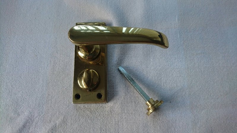

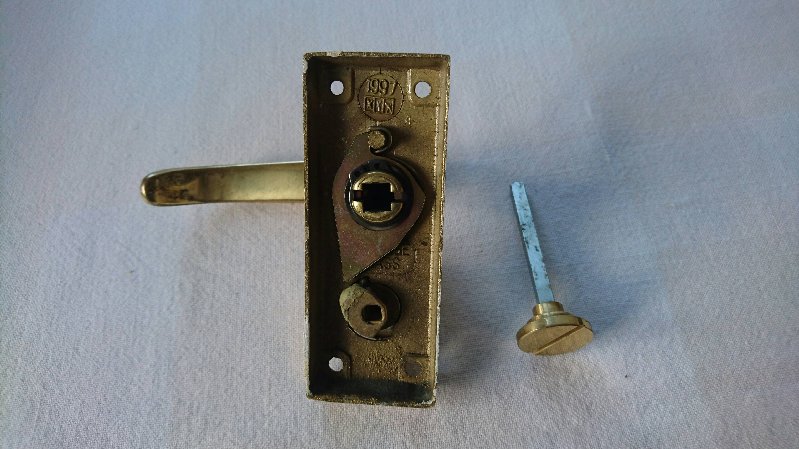

Also, want to change all our door handles and one is for the bathroom. Our current handle has a cam inside and when you turn the thumb button it catches on the cam to stop the door opening. There is a coin fitting on the outside with a slot so the door can be opened in the event of an emergency.
Tried to ring around and look at sites with handles to offer but getting confused at to what is meant by "privacy handle" and "bathroom handle". Could someone explain please?

Attached are 2 photos of the current bathroom handle we have which hopefully you can see the mechanism.
Been to 3 local traders and non have what we need and two didn't know what we were talking about which is I am sure is called privacy lock (not bathroom lock), if they still make them. Was hoping to buy them locally so I can see the actual handles as buying online, if I can, means buying blind.

I know the type of handle you show, but have seldom seen them. Yale did offer a version but I think a few years ago I saw them on clearance, I believe as discontinued line.
Send your pic to ironmongerydirect, who carry a very large variety of handles, and ask for suggestions.
A "bathroom lock" most often looks like this, and is a variety of Sashlock:
the thumbturn spindle goes in the same place as a normal keyhole, but your handle is designed for a simple latch and would not fit.
If necessary you can get a bathroom deadbolt operated by thumbturn, which is tubular so can be fitted into a drilled hole, easier than cutting out a mortice for the type of lock I show above.
Or you could just strip and polish your old handle.

Could you expand on your suggestion about a bathroom deadbolt, images would be ideal. Want to change the handles as they are very badly scratched.

One of these
http://www.ironmongerydirect.co.uk/search?SearchText=bathroom+deadbolt
(most retailers only sell the short ones. Get one with the same backset as your latch)
operated by one of these
http://www.ironmongerydirect.co.uk/search?SearchText=thumbturn+release
note there are two spindle sizes, not a prob, just verify the turn and the bolt are the same size.
Don't use the one-piece plate with handle and thumbturn in one, unless you can drill holes and fix the parts within a fraction of a mm.
You may need to buy a new tubular mortice latch so the backset on the latch and the bolt are identical.
They are listed as bathroom, but can also be used for privacy on bedroom doors or to keep young kids out of other rooms, until they find out how to operate the emergency release. You can use them as security bolts if there is no access from the other side.

Am I right to assume that the deadbolt only needs to have an appropriately sized hole drilled in the edge of the door and the strike plate fitted on the door frame? Seems simple but then I am absolute rubbish at carpentry.
Chris
yes, but you have to trim the (usually rectangular) recess for the faceplate in the door edge and frame, using a very sharp chisel.
Tubular mortice latches are fitted the same way.
