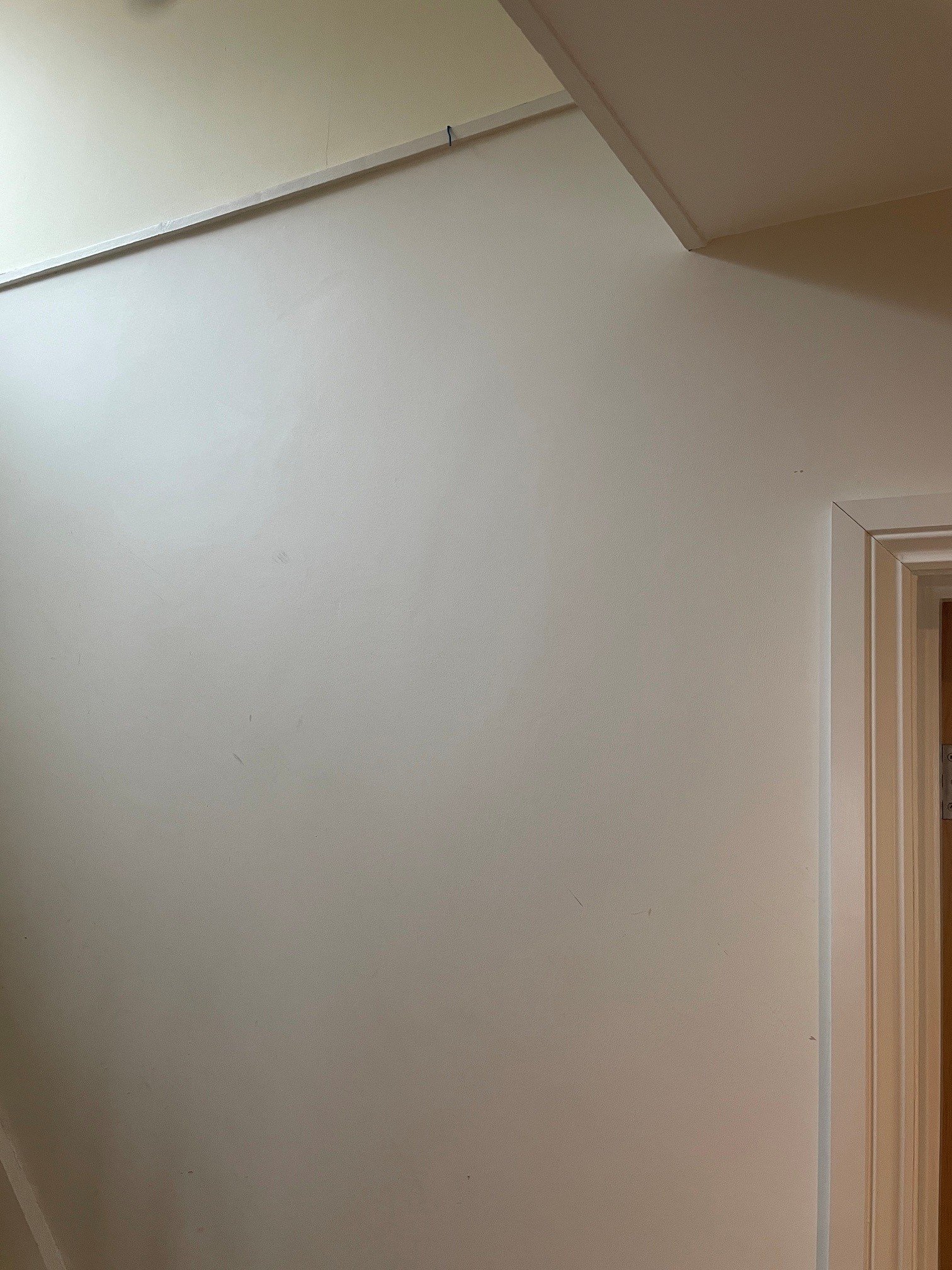

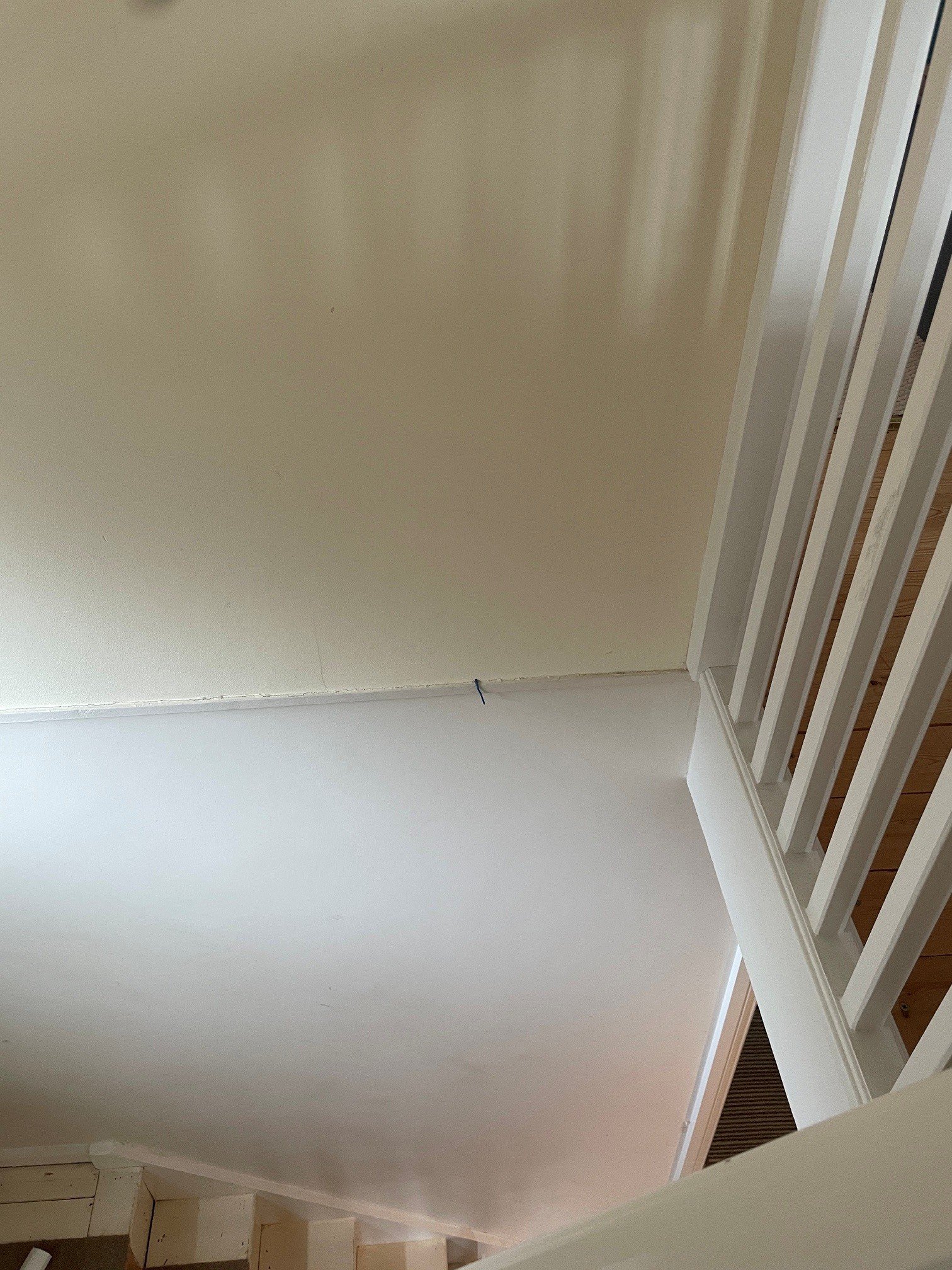

My thought is to cut a hole in the living room ceiling adjacent to a supporting wall, and then have a hoist in the loft to pull the carriage/box between the ground and 1st floor (2.3m distance)
Ceiling is simply plasterboard

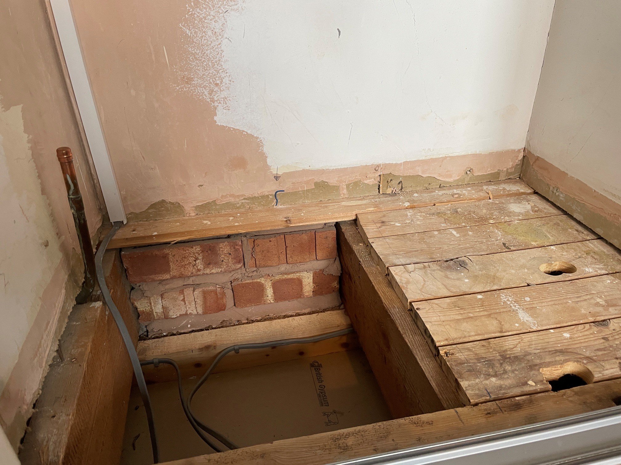

This will take her direct into a built in wardrobe in our smallest bedroom (see Bedroom photo)
*NOTE * we use this room as an office/craft room and no one sleeps in it !
As you can see from this photo, there are 2 joists shown (the left and middle one) but there is another one on the right under the floors boards that I've not taken up yet
Ignore the electrics and copper pipe on the left hand side...these will be gone !
The joists span from the back wall of our house, and finish on a supporting wall that forms the side of my stairs
The bottom section as I say is brick/block and supporting and the top is simply plasterboard
If you look at both the bedroom and stairs photo, you will see a blue piece of wire I've popped through as a marker to show where the block/plasterboard starts/ends
The distance between the left and middle joist, and then the middle and right joist are both 410mm
The joists are 50mm thick, 190mm tall and approx. 3400mm from the outside wall to the internal support wall mentioned above

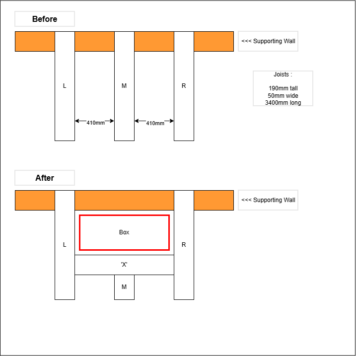

As the box that she will travel in needs to be 600mm wide with and widest side attached to the wall with some rails, the middle joist will need to be cut
One final thought is that when the box is in the 'home' position ie. in the bedroom cupboard, my idea is that the bottom of the box has almost a loft hatch underneath, so the living room ceiling hole is filled/covered
Now the questions :
1 - As shown in the PNG file attached, is it be possible to cut joist M and then replace with 'X' timber of the same dimensions to transfer load ?
2 - If so, can someone confirm how best to attached 'X' to L, M and R please ?
3 - Would there need to be any dialog or agreement with building control to do what i'm thinking ?
4 - Would cutting a hole in the ceiling break any fire regs and if so, what actual regs would be being broken please ?
Happy to provide any further clarity or diagrams

Ordinarily L & R would need to be doubled up, unless you can get an SE to say otherwise.
Thanks for the input @noseall however, can you explain why a structural engineer would say this, please?
Just to clarify, these joists just go from the back wall of the house and they finish on the supporting wall that I’m talking about which forms part of my stairs
The room where this lift will go to is simply our smallest bedroom/craft room which is only about 3.7 m x 2.8 m wide in size meaning there are approximately 7 of these same joists assuming the 400 mm centres
So these joists are simply as I understand it only supporting the floor in that room along with holding up the plasterboard ceiling in the lounge below
Anything above it i.e. brickwork for upstairs and the roof doesn’t touch these joists or transfer load to any of these joists as I understand it but being a lie man I’m happy to be educated

We took a fireplace out fairly recently and one of the joists was cut short of the bearing wall, to allow the flue to pass. It rested on the fireplace wall which was subsequently removed. Neither the BCO nor the SE were happy with a repair (using the neighbouring joists. It had to be a full joist spanning wall-wall. These were chunky fellas at 70mm thick.
I wonder how they signed off on any staircase in the uk... which all just have a trimmer at the end off the joists to make the hole for the stairs, ditto loft hatches etc .
can you explain why a structural engineer would say (L & R would need to be doubled up), please?
The load carried by the middle joist is now being transferred to the left and right ones. If it’s divided evenly between them, they now carry 50% more load than they did before. Question: when they were originally designed, were they designed with 50% more strength than they actually needed? Do you have any paperwork to show that? If not: either do some calculations now to show that the proposed construction is strong enough, or add additional wood to make them stronger. Hint: just doing the woodwork will be both cheaper and quicker than employing a structural engineer!
