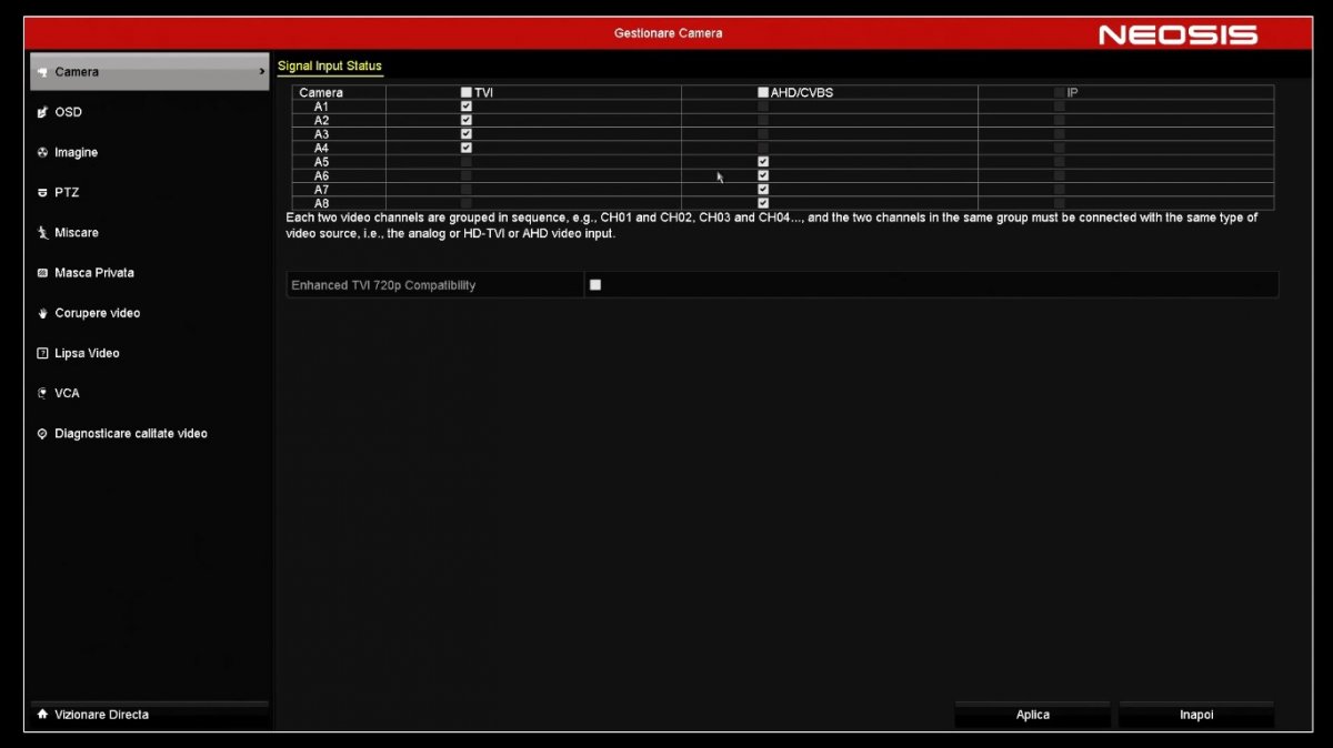

Go into the DVR settings and look for a screen like this...
You can see this system is currently set up for 4 HD-TVI and 4 AHD(or 'normal' CVBS) cameras, with no IP cameras. There's even more types though, HD-CVI and HD-SDI. Yours won't be IP though of course, but all the other types use coax.
