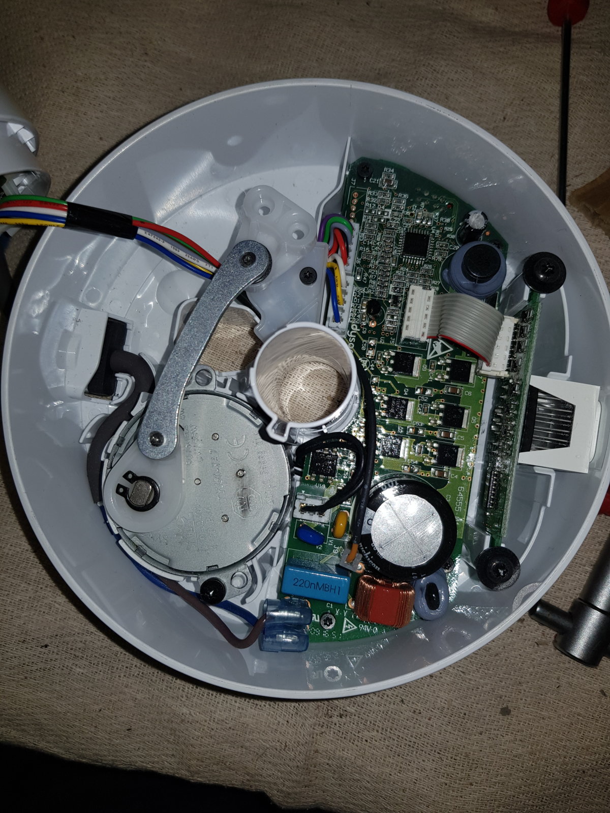

Hi guys got one of the dyson am07 fans the other day it just died...
Just stopped working and now there is no sign of life at all i have check the power supply and the fuse and there both ok
I have the fan in all bits and i cant see any burnt or melted parts what can be causing the fan to show no sign of life

I have took it all to bits just to see what has made it go dead there is no error codes or flashing lights just nothing at all

I don't know what's in one of them things, but do you have a multimeter? i would think that's your starting point - rule out the easy stuff first (eg supply in/out, fan windings resistance, etc).

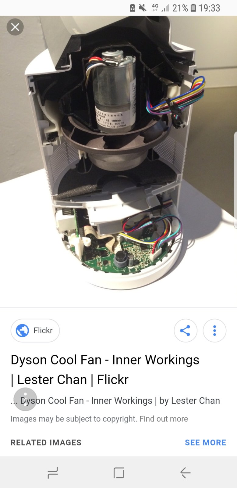

This is what they have inside normally on a motor there is not so.many wires out of it so im not sure were to start with a meter i have checked the lead is bringing power to.the board and that is ok

If you don't know where to start with a multi meter how do you know there is live & neutral getting to the the board
No i know how to use a multi meter i mean i dont know were to start on the dyson as there is so many wires out of the motor to a harness were normally there is only 2 or 3

A marvel (perhaps) of complex electronics but utilising the ubiquitous synchro motor to provide the oscillating function
It's a standard BLDC driver, but the PCB has been coated, so very little chance of a decent board level repair.
