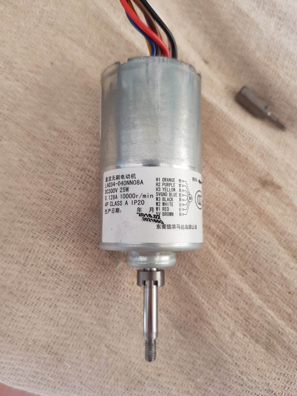

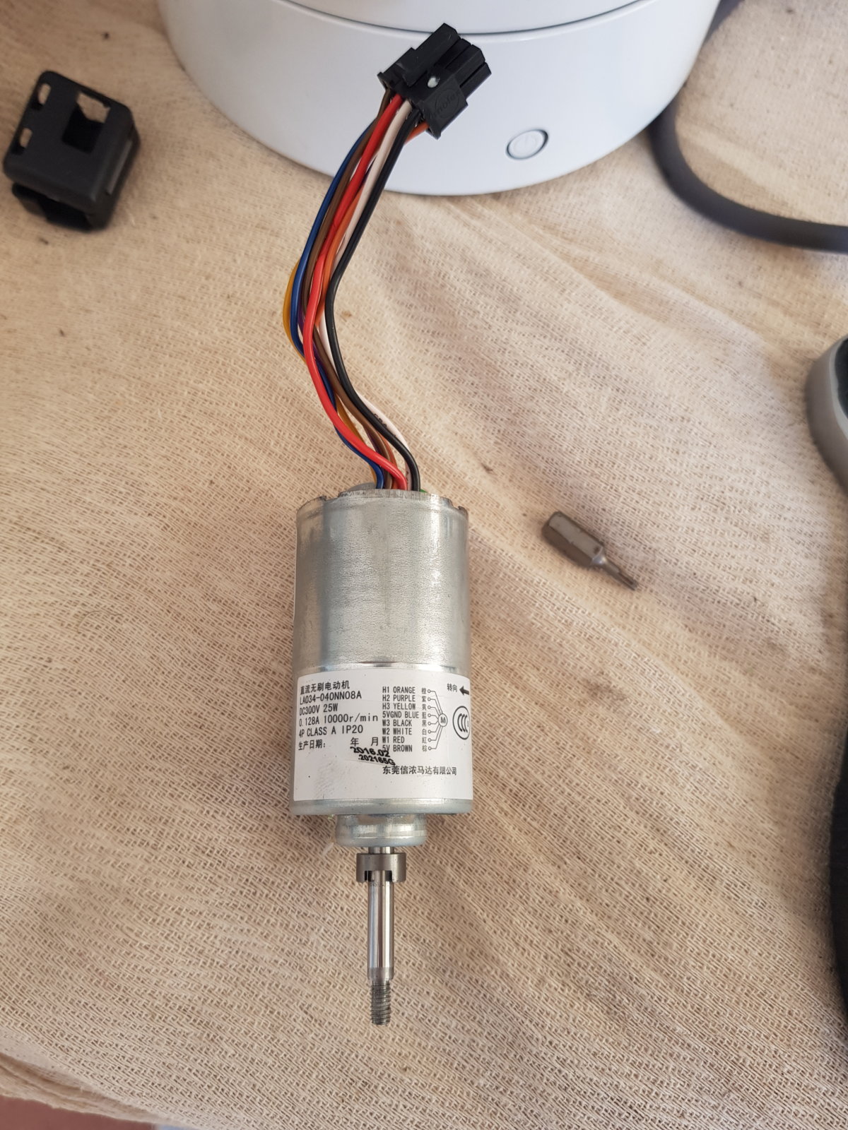

Still waiting on dyson parts to arrive but while im waiting could anyone tell me how i could do a multimeter test on this motor to check for damage ?

If it turns by hand & the motor is not seized, then my guess would be that you should be able to measure the same resistance between the blue & each of the other wires. You are looking to measure across a number of coils, without knowing how many there are it is difficult to say.
Surely there are 3 windings, connected to 6 of the wires H1 H2 H3 W1 W2 W3. No idea what the blue and brown 5v wires are for, speed sense perhaps?
