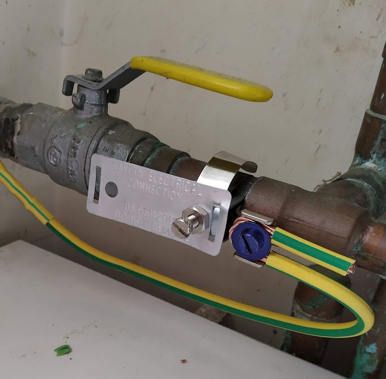

The wire should be looped around the screw, or a crimp terminal used if there are two or more wires.How is the clamp installed incorrectly…what is the issue?
And its on the bend he could move it down a bit surelyHow is the clamp installed incorrectly…what is the issue? He did the same for the gas pipe near the gas meter

As I need the socket and near the water mains there is another 2.5 wire going for a socket in the kitchen, you reckon he could have got the earth from there?No decent electrician would add an earth from a pipe to an unearthed socket, either rewire or disconnect.

If the kitchen circuit tests fine then he should/could have taken the whole supply from there not just the earth.As I need the socket and near the water mains there is another 2.5 wire going for a socket in the kitchen, you reckon he could have got the earth from there?
Strangely, it’s somehow is linked to the kitchen. Basically this socket is in the kitchen passageway. So when the kitchen rcbo closes then the entire kitchen including this kitchen passage socket doesn’t work. Perhaps a 2 core was used maybe for this socket.If the kitchen circuit tests fine then he should/could have taken the whole supply from there not just the earth.
