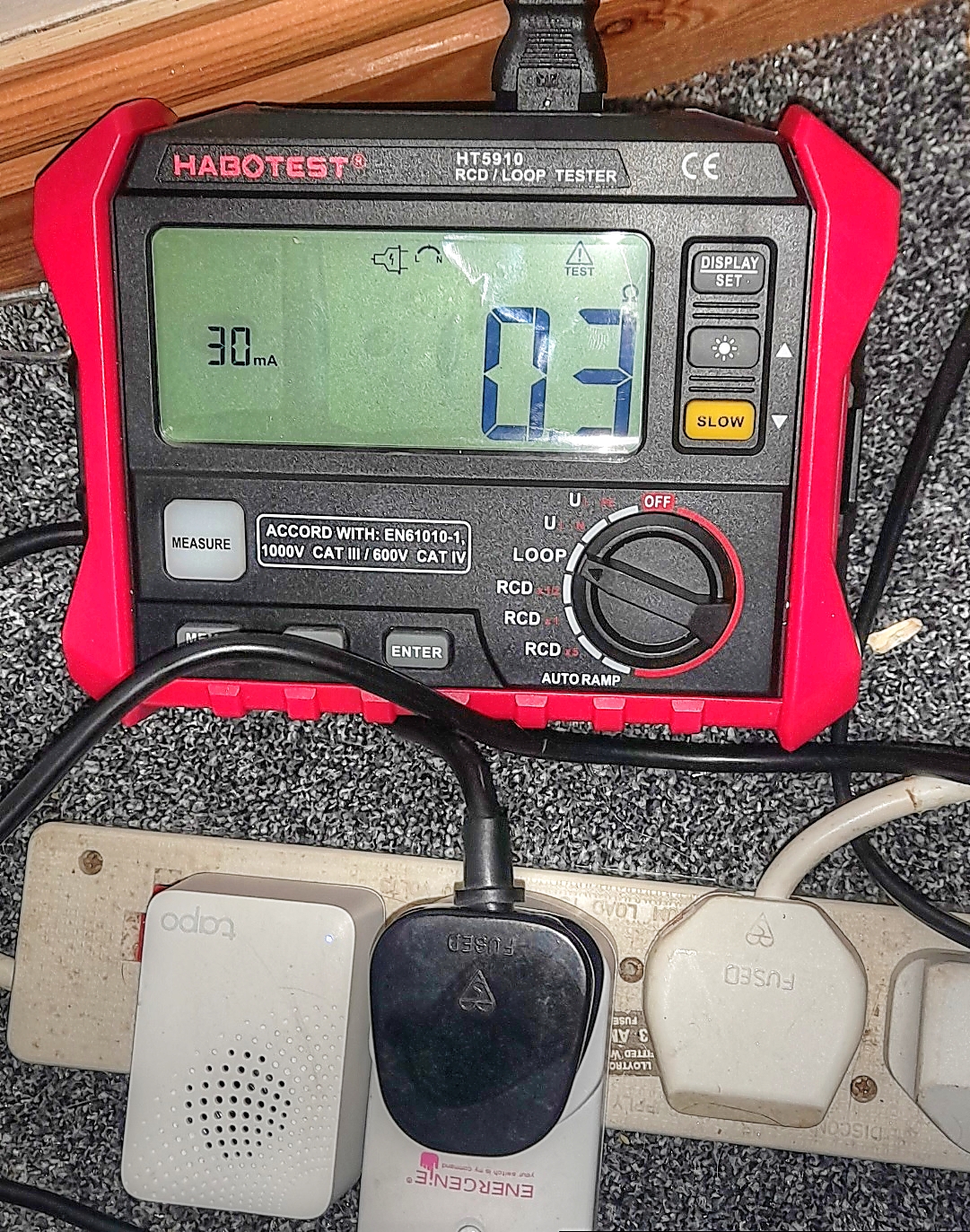

At the time of the wet room my clamp-on meter would only read in increments of 10 mA, I now have one which can measure in increments of 1 mA, and we are allowed 30% so with a 30 mA RCD 9 mA is the limit. Diffrence line neutral 8 Feb 24 reduced.jpg I am just within the limits for the whole house, but my house has 14 RCBO's and a pair of RCD sockets. So each circuit is well within limits.
However the odd thing is the installation certificate and the EICR does not require the leakage to be documented. We test the installation resistance, but we do that using DC, so any capacitive or inductive linking is not measured, well may be measured, but reading not written down.
When my solar panels were fitted, the electrician measured the earth loop impedance to the earth rod, and showed me it was 0.8 Ω or some equally unbelieveable figure, there is no way a single earth rod gets that reading, he had clearly measured the wrong wire. but "
NOTE 2:* The resistance of the installation earth electrode should be as low as practicable. A value
exceeding 200 ohms may not be stable." it was unlikely to be above 200 Ω, and not sure about the earth to a TN-S supply, which once the DNO supply (which is TN-C-S) fails and the earth rod is required it will be, so the inverter links neutral to earth which it does once it becomes an island supply.
But only option is to measure, Loop-test.jpg my meter should measure ELI, but I don't trust it, but loop impedance meters are not cheap, mine was £80, the RCD test seems OK, but don't trust the loop test.
