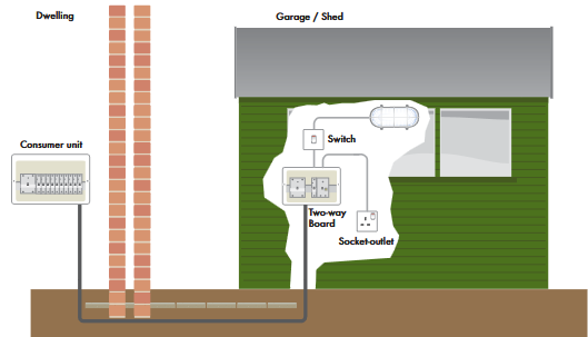

The same problem with tin sheds, and electric cars. I look at the rather dated supply to outbuildings and look at the picture 1739019548096.png no distance given, but that looks like a problem with a metal shed. It does state
one means of earthing must not be simultaneously accessible with an exposed-conductive-part connected to another means of earthing
not got the 16th to hand to look up reference.
However, clearly distance does matter, and I think distance to the moon is enough!
