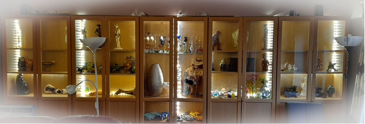

But many sockets had to get to, so considering any tests to reduce the amount of furniture I need to move. To access a socket I can cut a hole in the back of cupboards, but to remove the socket really need more room, so trying to think of a way to test without removing display cabinet.
Did not need IR test, was down with multi-meter test. When I got one section working, was surprised how much I had not unplugged. The socket which is still not powered is not where I expected to find it, I have been trying to work out likely run, but since earth neutral the fault may have been there for years, some sockets behind this 1776966672757.png and I am not looking forward to removing the left two units and going behind them, specially since not sure if that is where the fault is.

The disconnection of neutral only to start with was because my screwdriver was not long enough to reach the line, so socket removed and a connector block fitted to keep wires safe and separated, fitted where I had the USB socket, as wondered if the socket was faulty, trips too fast to measure earth leakage, but total earth leakage for whole house is high at the moment showing around 100 mA, but when I tried around earth wires nowhere near that high, that was the differential around the meter tails. I am not sure about the SPD and if that was reason for some odd reading? The lead was not clamped but was touching, and it was because of the SPD I was not using the insulation tester, but given up for a few days, not safe standing on a step-up working on the CU on my own.
But why an earth - neutral fault should show now, when CU has been fitted for 5 years, has me scratching my head, mainly as working out possible cause, may lead me to find the fault faster.
My first thought was a mains filter gone faulty, hence unplugging all I could. The earth leakage was 8 mA actually took a picture Diffrence line neutral 8 Feb 24 reduced.jpg so why now showing 100 mA don't know, 14 RCBO that's 12 type AC and 2 type A shed and faulty ring final on type A now, the 32 amp RCBO feeding back kitchen cooker had failed so had a new one in ready to change, so ring final one moved to cooker, and new one on the ring final, not as yet tested to see the ramp value, but since it was a handy ring final test my new RCD tester on, I know it was well within parameters and did not trip at ½ value, the problem is a set of steps between CU and the ring final sockets in question, so to reset have to walk outside and around the house to the flat under main house to reset, so really a job to do with two people.
