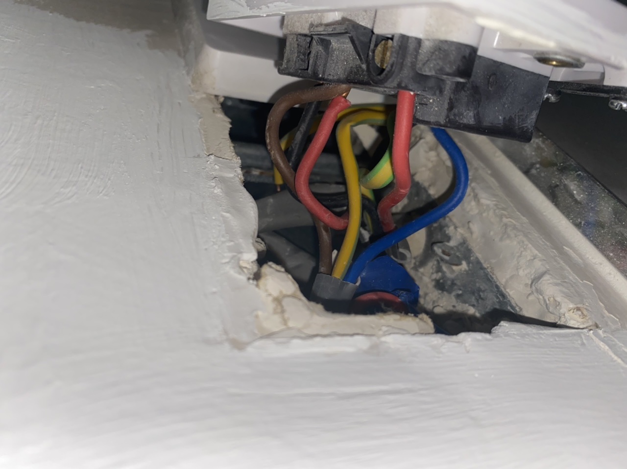

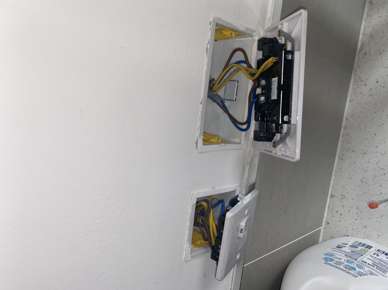

To update on what I’ve done, I removed one end of the ring from the breaker. Roughly half the sockets energised. Checked with just the other end of the ring connected, the other half of outlets energised. So, this at least narrowed it down to two outlets that could be the issue - 2 FCU’s in the utility room.
Removed front of one - all looks fine, old red and black wires all secure. On the second, however, it’s a little more complicated - looks like the ring has been extended to add a 3rd FCU and a double socket at some point, as there is a mixture of red/black and blue/brown.
Annoyingly, disturbing this FCU seems to have got the ring working again. But that suggests there’s a loose connection somewhere, which I need to find.

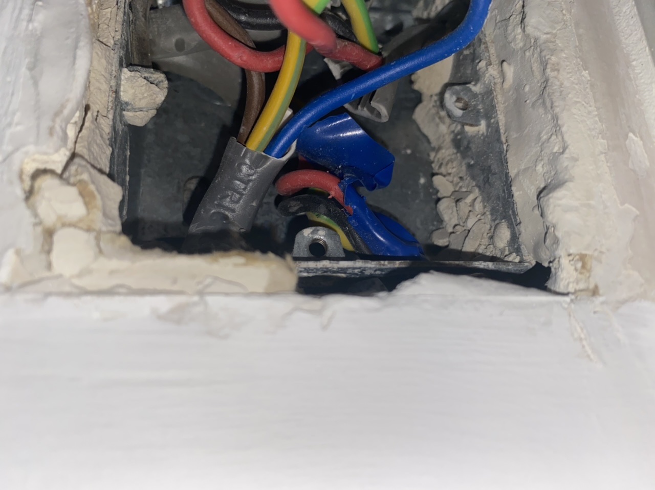

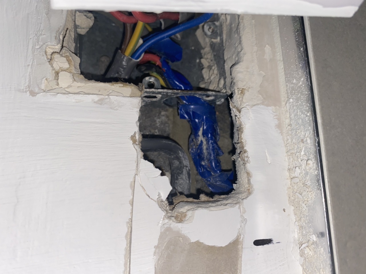

so, don’t like the look of new to old wires wrapped in blue tape and heading left out of the box towards the new socket and FCU.
What you think?
Not liking it at all (don’t even think they’re crimped! No grommets on box either.

think I might add a mother 25mm pattress box to the left of this FCU, with just a blanking plate on the front, and join the cables using wago’s behind - that do?
View attachment 187007think I might add a mother 25mm pattress box to the left of this FCU, with just a blanking plate on the front, and join the cables using wago’s behind - that do?
Doing that would certainly give you the access you need and cover the missing plaster. I'd add 20mm grommets at the entry/exit points to protect the cable too.
It may just be that there's a join where the blue tape is, or the cable has come loose at the terminal.

No, the cables were joined by twisting them together and covering in electrical tape. Can’t believe someone would do that on a socket ring. Not even sure it was this that was causing the problem, could have been a loose connection at the back of the FCU.
worrying thing is, we moved in here last year and it’s probably been like that since then. That means that a single 2.5mm cable was supplying a 3kw kettle, 2.5kw oven, ~2kw dishwasher, and ~2kw washing machine - many of which are often on at the same time - and no protection other than a 32A breaker (and an RCD)! I make that 9.5kw, or 40+ amps
