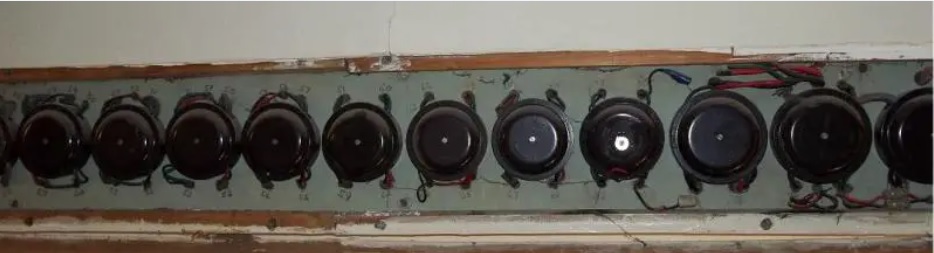

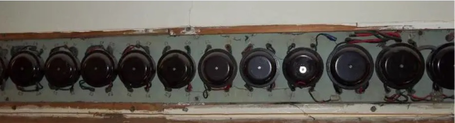

This was the ring final in a cottage which a friend purchased about 15 years ago
Every socket was a spur from the ring with all junction boxes accessible.
Every socket was a spur from the ring with all junction boxes accessible. View attachment 308294
Nice picture.
I have worked in a 60s bungalow where every single socket was spurred from the ring in the loft - but the JBs weren't all next to each other like that!
