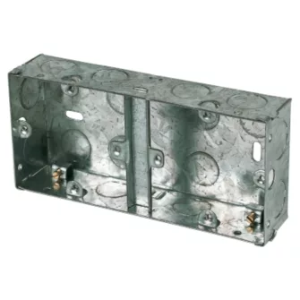

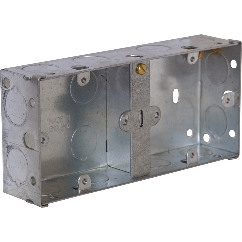

With respect I think we'd all expect to see all earth conductors at a switch connected together regardless of which OCPD circuit they originate from and additionally if tests are being performed at that point I can't think of many who would deliberately disconnect earths to perform them. The same is also true to a lesser extent in other situations such as the use of these:
Where 2 different circuits, such as power RFC and a lighting socket, are brought together in the enclosure.

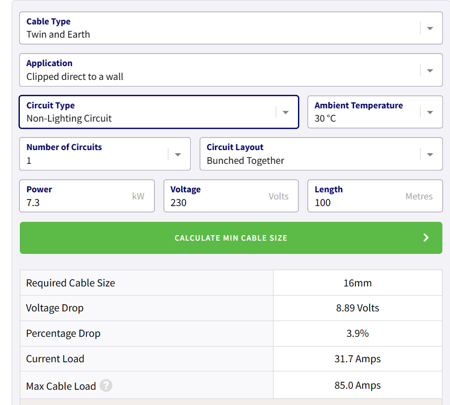

Hmmm let's design a circuit, a 32A sockets radial requiring 100m of cable in a domestic property.
What I see is the amazing advantage of not requiring a few metres of cable back to the CU.
What I also see is the impossible task of getting two 16mm² cables into every accessory.
Apologies if the current maximum length of a 2.5mm² ring final is no longer 106m.
