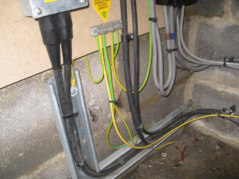

Where is the RCD protection for that CU and all the SWAs given that it is all a TT system?
Bit of a crap place to put a rod - also missing its "electrical safety connection do not remove" tag.
Tails from henley to CU look a bit small too.
It this installation providing an exported earth to the cabins, or are they all TT'd locally as well? That doesn't negate the need for RCD protection at the supply origin, I'm just interested.

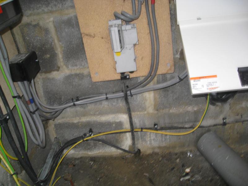

are ye blind man? 8)
it's in at least 3 of the pics..
bottom left about 2/3 of the way across in the second pic, bottom right hand corner of the third. and middle right of the fourth..

I have yet to come across a TT system which doesn't need RCD protection.
If you can tie down and the the Ze below 1 ohm then it might be possible but for reliability sake I still wouldn't trust it.
