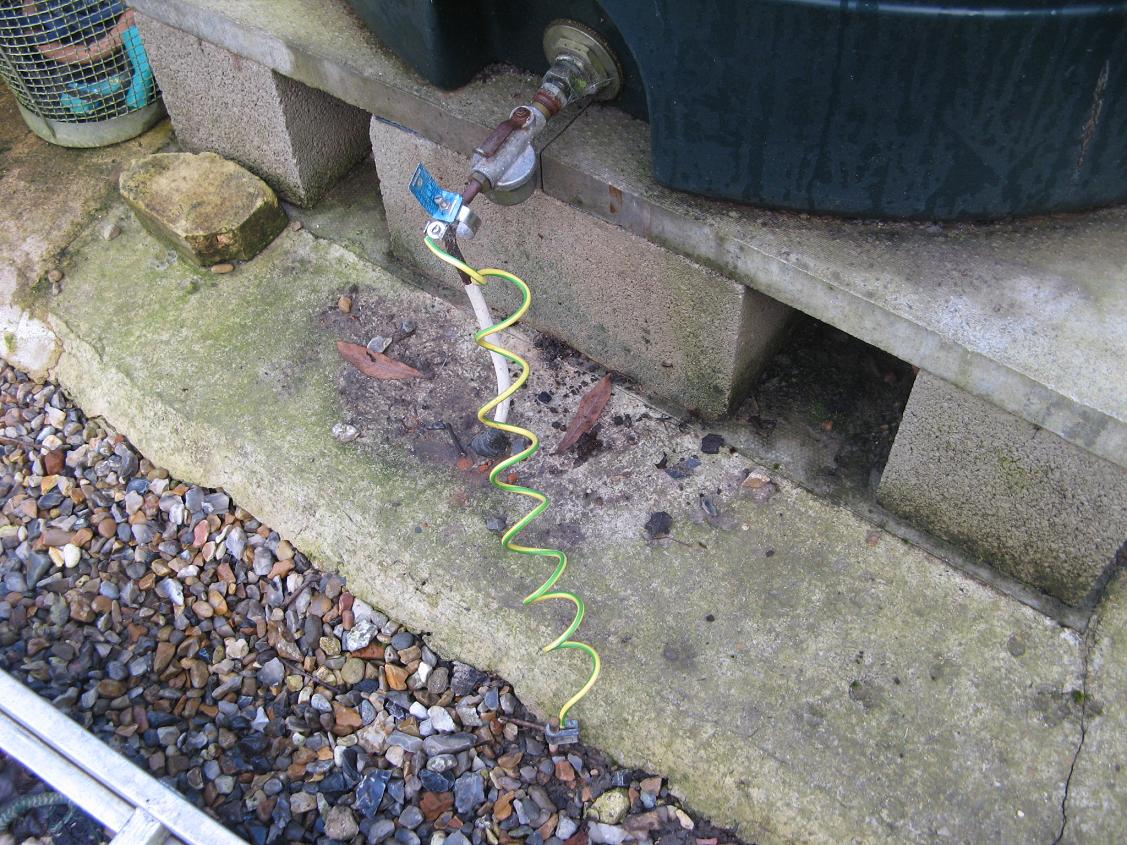

I had a new consumer unit fitted 3 - 4 years ago. I was never told that I had to periodically test the RCDs by pressing the T buttons. Still, you live and learn!
Anyhow, it is a split unit. The left side tripped when I hit the button. But the right side didn't. Did a bit of reading but could figure it out. Until today. I remembered that when the unit was fitted the electrician also added an earth to our domestic heating oil tank, but this had become detached. I've re-attached it and hey presto, the RCD now works when tested.
So I thought I'd better check in with you guys....
1. Does it sound right that having the earth disconnected would have stopped the RCD tripping on being tested, and re-attaching would fix it?
2. What kind of connector is it (see picture below)? When I put the earth cable into the holes, the RCD wouldn't trip. When I out it into the gap and made sure it was touching the rod, it DID work and the RCD tripped when tested. So how should the cable be connected properly to that piece?
3. Just for my curiosity, why is the oil tank earthed?
4. Do I need to somehow cover that earth point/rod so that the dogs can't get to it, people don't trip on it etc?

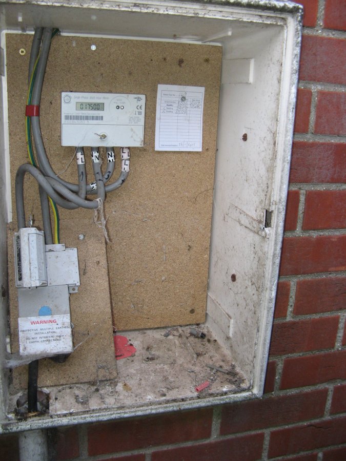

Can you post a photo of your main incoming supply, the black or grey box it terminates into, and any earth wires near to this.
The photo you have supplied doesn't make sense!
An earth rod is used to earth an installation when an earth isn't provided as part of your incoming supply.
The cable attached to the earth rod should run from the rod to your main earthing terminal (MET) which will be near or in your consumer unit.
Any metallic object likely to introduce a potential into your property must be bonded.
As the oil supply pipe to your property is metallic, and as it comes from outside to inside and it appears to run in the ground, this pipe must be bonded.
The bond should be attached to the pipe within 600mm of the point of entry to your property if possible, and the bond should run back to your MET.
Your current set up does not achieve either of those things, and can only have been installed by someone who has very little understanding of what they are doing, presumably thinking they have earthed the pipe and made the installation compliant. They haven't. Pipes need to be bonded - NOT earthed.
As for why this affects your RCD tripping I have no idea, as the RCD test button does not reference earth to allow it to function.
I would advise you get your installation checked over by a competent electrician asap as it could but in quite an unsafe condition as things stand at the moment.

RF Lighting - here's a photo. Does it show what you need to see:
Like I said in the OP, the consumer unit was fitted 3 - 4 years ago, and at the same time we had various other electrical jobs done around the house, including an Electrical Safety Certificate which as we had not long moved in and the house hadn't had one for quite some time (although it was only built in 1993). it was then that the earth was added to the tank (there was nothing there before that). I seem to remember he said it needed it before he could sign the house off and give the certificate.

Yes that shows that you have an earth supplied with your electricity supply, so you shouldn't have an earth stake outside at all.
It would be interesting to hear why your 'electrician' thought it necessary to install it.

Nope. It's not earthing; it is bonding (joining together electrically).
I appear to be confusing what you are talking about. The wire in the picture IS earthing although it seems unnecessary and is not really connected.
However, we bond things because they are already earthed by some means - this includes in the ground.
If they are not earthed - by any means - they do not need bonding and
definitely should not be earthed so that they do need bonding.
Petrol stations must use a Ground Rod to provide the Earth for the electrical supply. They cannot use the "earth" supplied from a PME electrical supply. This is due to the risk of the PME "earth" becoming a different voltage to true Ground at the station. This would result in high Earth currents from the PME earth to ground through the pipework and the underground storage tanks. This would be a possible source of ignition of petrol fumes.
Home heating fuel is far less volatile than petrol but is still classed as a fuel. This may be why the electrician used a Ground Rod and did not export the PME earth from the house to earth the tank
