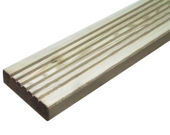

Hello,
I have a lot of grooved decking boards that someone asked me to redo for them. I need to sand, prime and top coat.
I was thinking of trying to use an electric powered sanding tool to do the sanding, but I am not sure what tool will be able to to sand in-between the grooves?

I think the bosch may be overkill, and a normal orbotal sander with 60 grit wuld suffice, as to the grooves, and depending on their width, it may be as simle as sandpaper wrapped around a thin bit of wood, or simply a piece folded over.

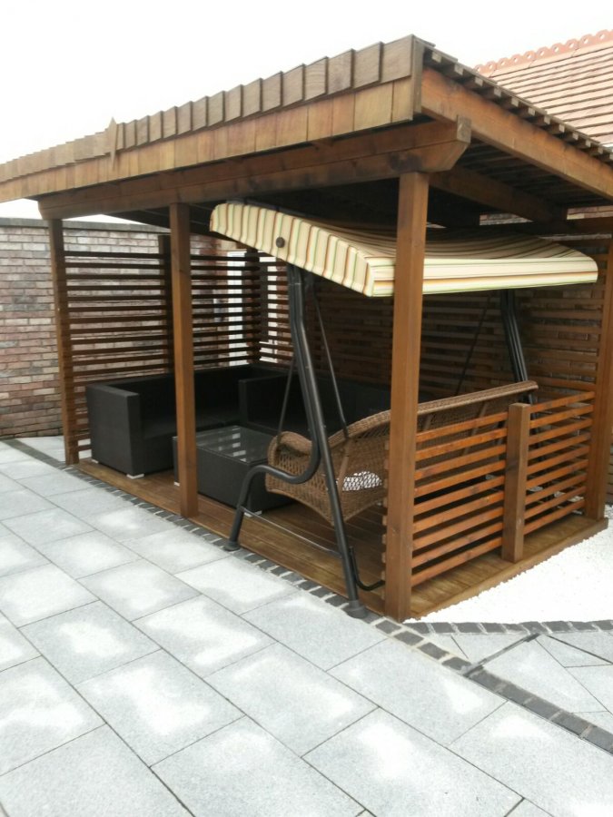

These are what I need to do, I am not sure if the decking on the gazebo is the grooved one, I'm quite sure there was some grooved decking on at least one part of the house that I need to do. I want to get it done to a high standard and I hate hand sanding so want to get a tool to do the hard work for me.

I've not done it yet but to sand down deck boards I would try a block of pumice stone. After a few runs it will wear down to fit into the grooves. Ebay do them.

When you said grooved, I thought the planks were
A normal belt or orbital sander would do it, with possibly a bit of carefully made 2x1 cut to size to fit the gaps and covered in sandpaper
