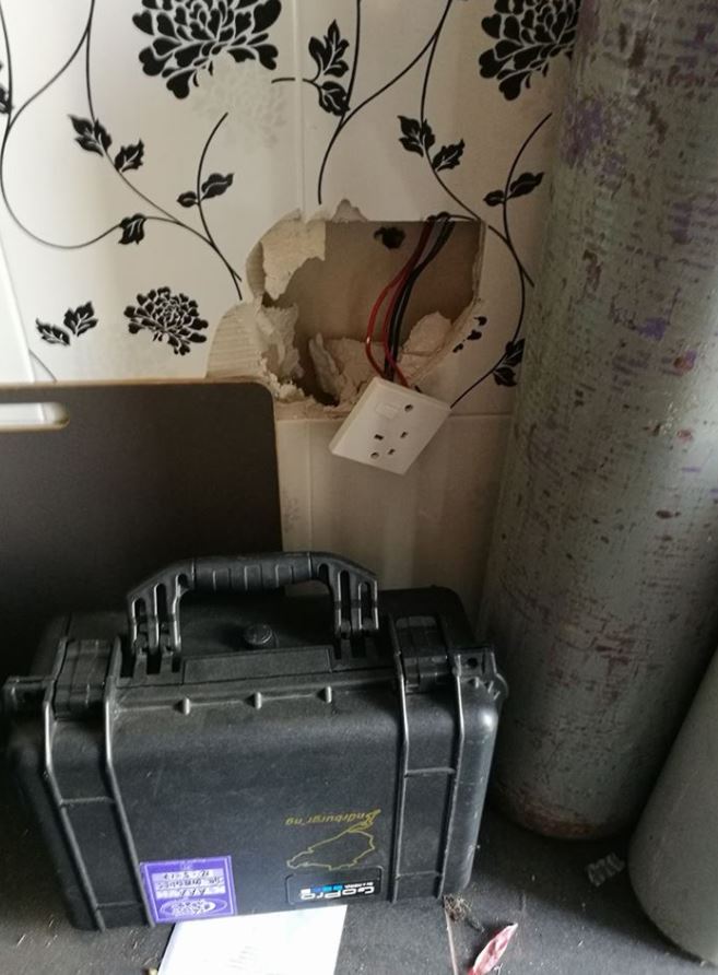

as you an see by the image, the socket and the wall with tiles has cracked.
just thinking what the best way is to do, If the tiles are to come off (both of them) then the plasterboard may come with it too? what do you think? replace the plasterboard at the back AND the two tiles? then sit the socket at a corner of a tile or surface mount it with a backbox?
one other concern, why isn't there an earth on here?

If the socket has no earth connection it is dangerous and most be made safe.
It also looks like single cables have been used, without the use of containment, which is also a no no.
I would check the rest of the property, you may need to rewire all the socket circuits.
some batons or noggins in the wall with either plaster board or aqua board cut to size and screwed to the wood. Then patch plaster to join.
After the dodgy electrics have been fixed.
