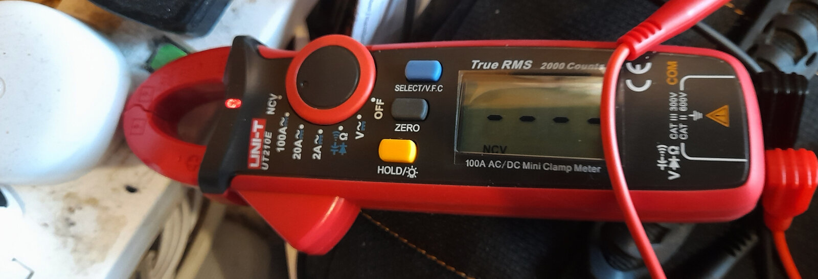

I have my favourite meter, Testing for live.jpg so easy don't even need to get out leads, it has non contact voltage detection, the same with a volt stick, yes I know not the approved method of proving dead, one should use a tester with no dials or battery so can't in error be on wrong range or have discharged batteries, and a proving unit to show it works, but I and I am sure many others are lazy and just use a non contact voltage range on their meter, but really no excuses, he should have checked.
I am by no means against using them as an additional extra tester once you used correct test gear, that cant hurt and if it saves grief/ a life then yes good.
It just can not be relied upon as a test for dead
I always tried to use neon screwdrivers not to test with but as a second string to my bow, very good with borrowed neutral, OK with the clamp on can now find them without disconnecting first, but before I had the option the neon screwdriver was a good second string.
