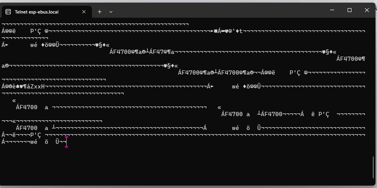

I got up this morning, opened up Telnet, typed in Telnet> o esp-ebus.local 3334 and this was the result, when left it last night, Telnet was unable to connect...
Lots of continuous data being sent from the ebus adaptor.

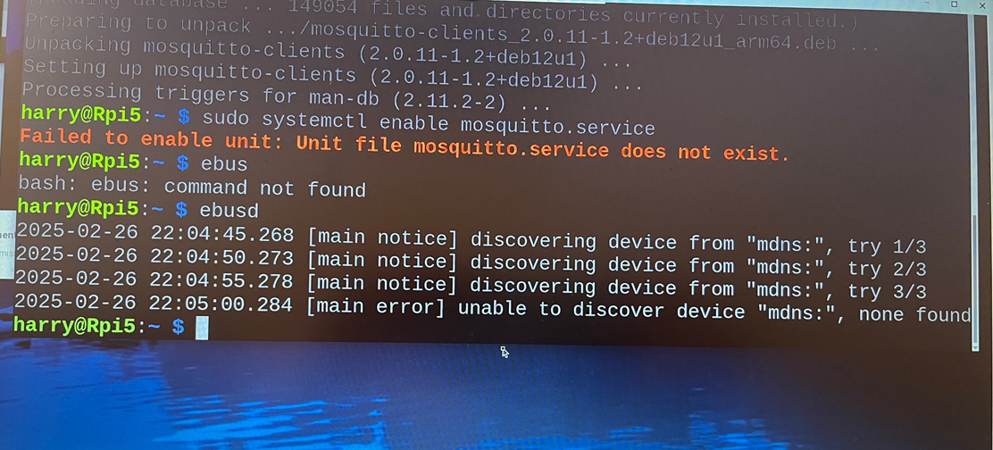

Whilst that was running, I opened up Terminal in the Rpi and -$ ebusd
That responded with '[main notice] discovering device from "mdns:" try 1/3'
next line 2/3, then 3/3, before 'unable to discover device "mdns:", none found'.
Soon after which, all access to the adaptor failed again, apart from being still able to ping it..

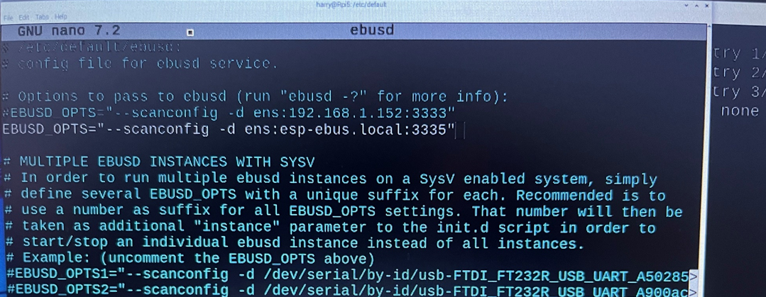

Yes, I managed to edit... It was locked to root, but I found a way.
3) Change the scanconfig target to point at your wifi ebus board:
EBUSD_OPTS="--scanconfig -d ens:192.168.0.50:9999"
to EBUSD_OPTS="--scanconfig -d ens:192.168.1.152:3333"

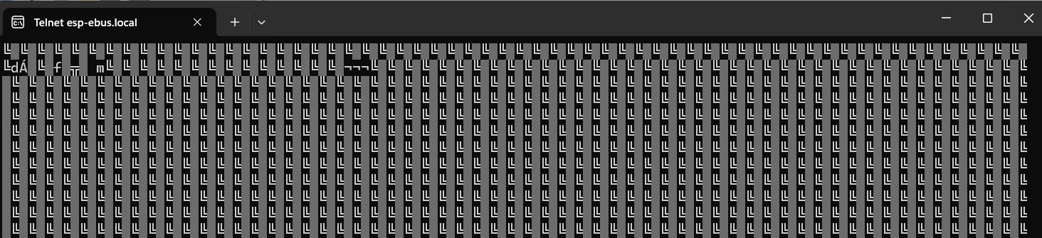

It has suddenly changed the style of gibberish, it is putting on the Telnet screen. It is now producing a consistent character, with an occaisional variation...
It produced the complete gibberish this morning, from soon after I got up, for maybe a couple of hours, then stopped, the status and configuration web pages of the device, became inaccessible, as usual. Then a few minutes ago, opening telnet. it was all back to working, but producing this.... Is this what it should be producing?
It is all explained in the info on github for the firmware ... https://github.com/danielkucera/esp-arduino-ebus

Having got that part working, and installed EBUSD on my new Rpi 5, I completely stumped as to what I am supposed to do next - HELP PLEASE???
This is all have been able to get out of EBUSD....
it's not seeing the parameters for ebusd in /etc/default/ebusd but I thought we'd covered this previously in the thread.
Is the IP address of it still 192.168.1.152?
The address "esp-ebus.local" could work. You can tell if it will be work by running this command:
ping esp-ebus.local
and if that succeeds then it should work. If not then you need to find the IP of the device and make it static so you don't have to keep editing the config file.

I've tried various configurations of that 'scanconfig' line, and nowt has worked so far. I'm finding Linux, very cryptic..
A question.....
If I edit the file with nano, can I just edit, then save it ctrl+O, then go straight to the prompt and type/run ebusd ? No need to close nano, or reboot the Rpi?
