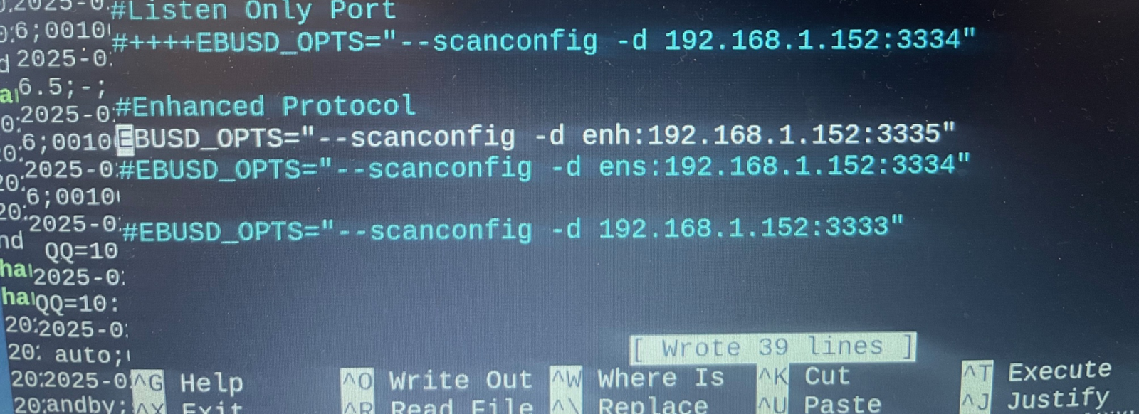

Yes, so long as you've saved the file you can restart the service. It's not necessary to exit the editor.

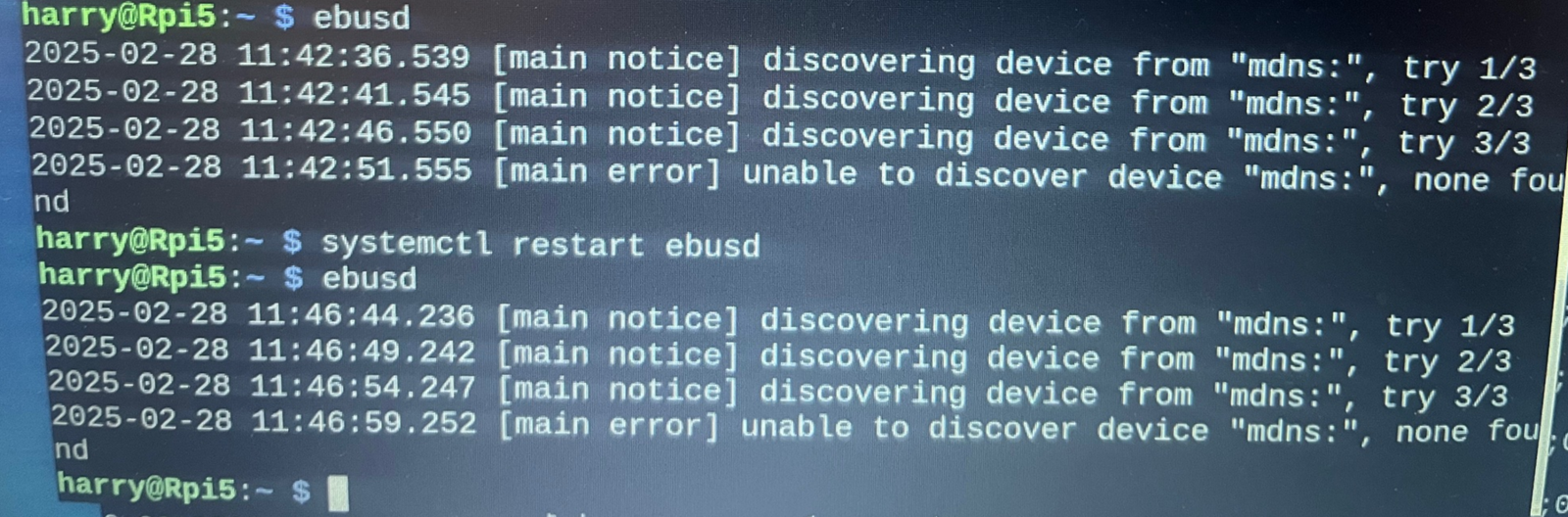

Could you try starting the ebusd service instead of just running ebusd? Ie,
In another terminal you could be running
as well, to watch the log output in real time.
systemctl restart ebusd
tail -f /var/log/ebusd.log
As you've set a static IP then no need to worry about why the hostname doesn't work.esp-ebus.local did work, now doesn't ping, pinging 192.168.1.152 always works, never ever fails.
