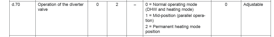

Did you replace these parts? If yes, why wasn’t it done under warranty - that’s mystifying. I would check the D70 code.
5 months outside 2 year warranty unfortunately. Yes replaced these parts. There is no d70 code but the diverter valve operates correctly, as seen in other D codes. I'm wondering of the new flow sensor is faulty. Happened to me once when I bought a replacement condenser for a car.
There is a D70 but you need to enter into the 2nd stage parameters to get it. It’s in the installation manual. Anything else advisory on here would relate to gas advice as you have replaced the parts and don’t claim to be gas safe not competent to check after removing a cover that forms part of the combustion circuit.

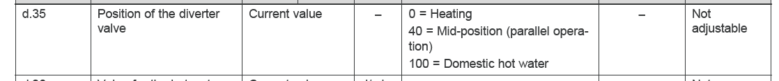

I don't see any second stage parameter access in the manual. D35 gives the current position of the diverter valve.
It also shows in d.70 as having 3 settings, 0,1&2, I presume 0 is DHW or heating since its a combi?, but the mid position option seems strange for a combi, if settable?. What setting is it on and what is it (d.35) showing with DHW on?.

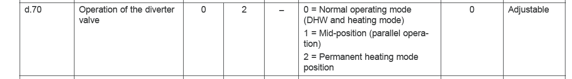

0 will provide heating and hot water as denoted in brackets, mid position and permanent heating presumably if setup as system boiler.
