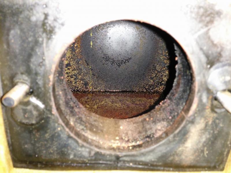

...and the other question I have is there is a bit of a fuel smell coming from inside the furnace casing, where the blast tube goes through, looks a bit damp with fuel in there. Is this a problem? Picture attached:
Remove pump completely. 3 grub screws and high pressure oil connection.
I'm guessing the buzzing is the fuel solenoid opening fuel line, then due to photocell seeing no flame, lockout.
So you will problaby be getting a small amount of fuel dribbling out the nozzle.

Thanks for the direction! Before I removed the pump, I checked it was giving good pressure by removing the bleed screw. It's got really good pressure!
I have taken the pump off with the 3 grub screws, twidded it by hand and it moves well (like a pump should IMO). Turned the blower motor and it felt VERY stiff until I rotated it a few times.
Then I powered the motor back on (without the oil pump) and it carried on for a lot longer before lockout (I'm guessing because the photosensor didn't detect a flame!). I think the motor would have carried on to be honest!
So the question is; does the motor die under the load of the oil pump? I'm guessing so. Could it be faulty windings in the motor or the cap, or both? Just want to check it's not the transformer before I go ordering parts!
