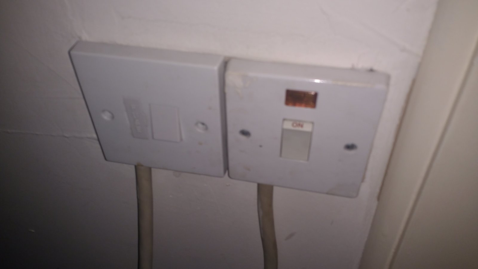

But the top one (which should be providing on demand water heating at any point right?) doesn't heat the water up when i turn it on.
e.g. yesterday i used up pretty much all the hot water stored up from the night before. and then turned on the 2nd switch (on the left in photo). Even after waiting for a few hours, water is cold.
I don't think its the fuse that has blown as the switch in question on my switchboard hadn't tripped.
What's my next move?
Thanks in advance

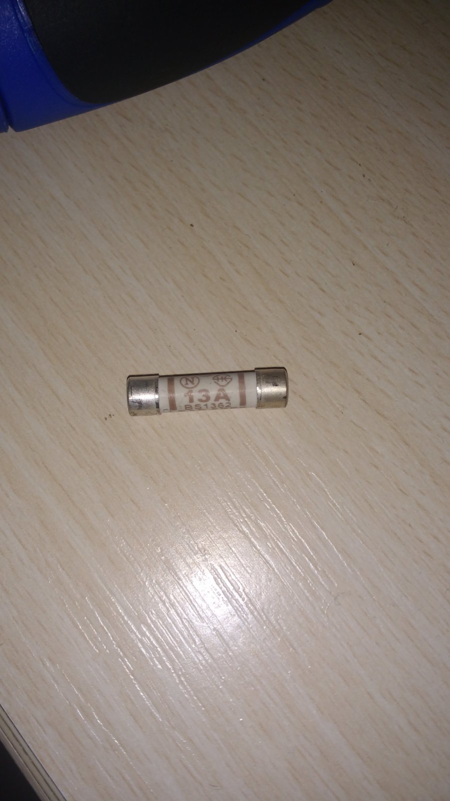

Couldn`t help but notice there are no screws in the switched fuse spur, do you know why not? Start by trying another fuse as that type doesn`t showing signs of failing externally or with it switched off remove the nut and Silver cover and see if the wires are connected or if there are signs of burnt wires under the cover. Depending on the your skill level you could also check the wires behind the fused spur and the round Silver cover with a test meter.
1. The fuse can blow without tripping the switchboard circuit breaker. You need to test the fuse. Multimeter is best, otherwise just try it in a light or similar which you know to be working. Do not leave immersion heater fuse in light plug, put the original back. (Should be a 3A or 5a)
