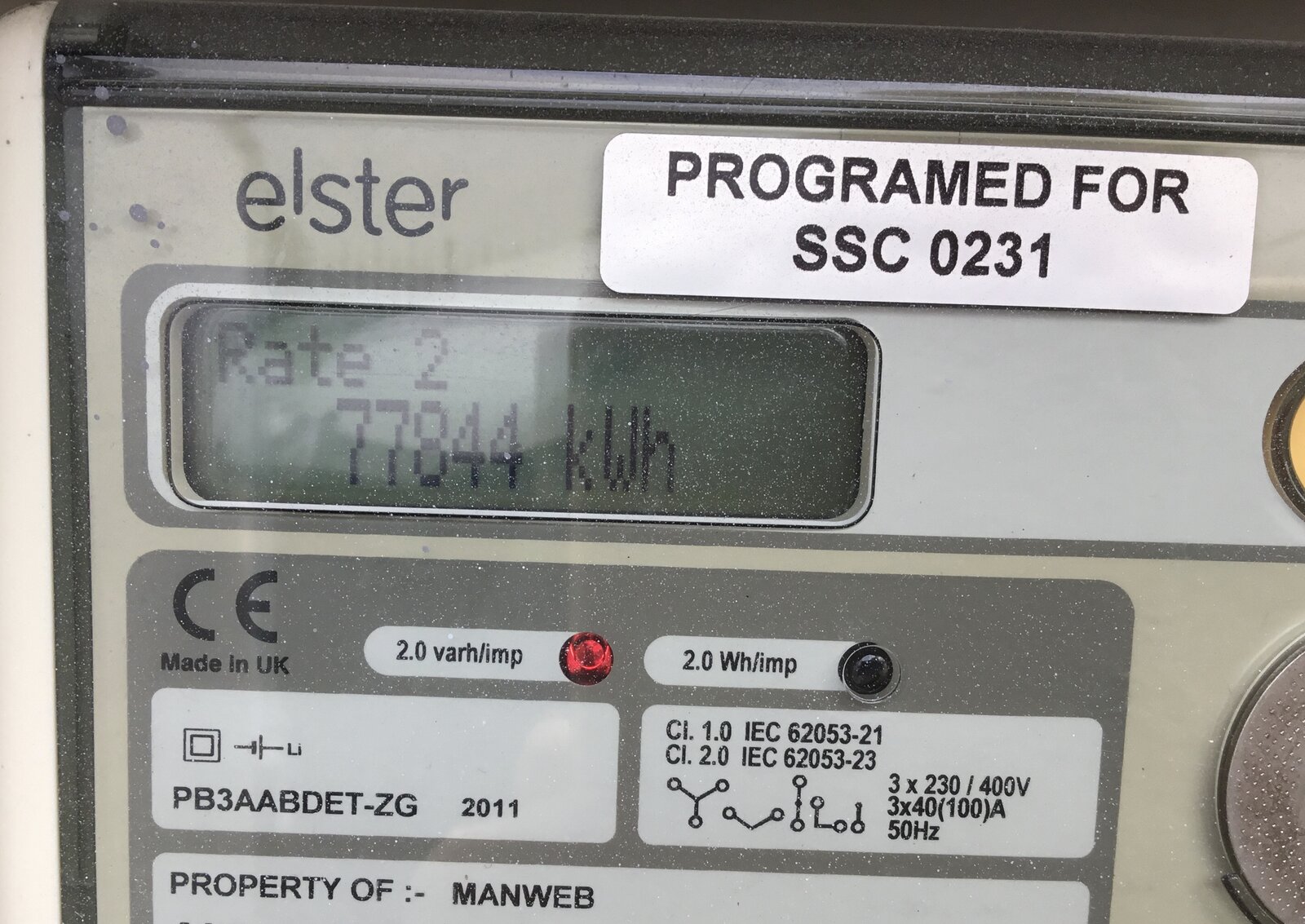

Hi,
I recently had a fused spur plate replaced with a regular single switched socket, as the spur wasn't being used for anything (must have been an old storage heater which had since been removed). When the electrician first put it in it didn't actually work, and since he only came to replace a couple of sockets we just left it at that. But to my surprise, the socket actually started working later that evening at around 7:30pm - then switched back off the next morning.
I did some googling around and quickly established this must be an Economy 7 socket that is only active for 7 hours, which means the socket is active between 7:30pm and 2:30am. All this time I thought my low rate was between 12am and 7am, so I had a look at the meter and while the Horstmann does show that the night rate comes on between those hours, I'm not sure how to tell the current time given how the socket came on at around 7:30pm, as opposed to am.
Can someone let me know how to tell the current time? I have attached a photo that was taken at 12pm. Also, would it be possible at all to have the new socket switched over to the regular 24 hour circuit? Any help would be much appreciated!
Current time is nearly 17:00
that metal pointer at the bottom.

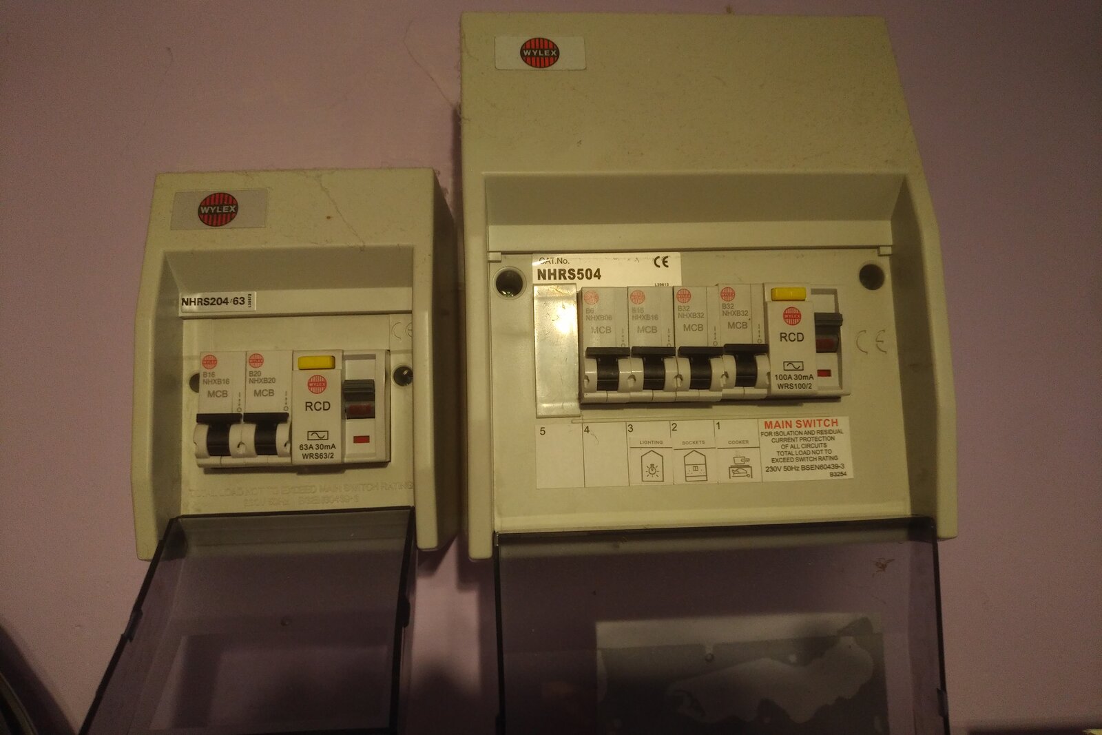

Post a pic or your fuses boxes, and we can tell you it’s easy to make the socket 24 hr

Sounds like I need a few words with my electric supplier then! I would no doubt need to get the sparky in again since I'm actually renting.
Here are my fuse boxes - I suppose the one on the left is the night rate circuit?
If the circuit ends in the left unit it just needs moving to the right one, certainly possible.

You're right - it does. I plugged a hair dryer in and the furthest MCB on the left powers the socket - I'm surprised the leccy never even noticed! So it would just be a matter of moving that to the blank plate on the right one?

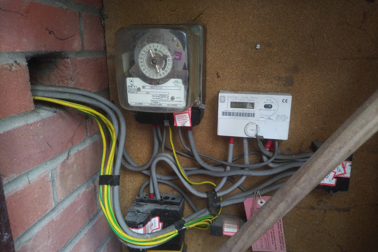

And where does your meter get the signal from? If it's a meter anything like OP's it's the wire shown with a blue arrow:
In many E7 systems that is all the time switch or Teleswitch does and I've worked on a number where the wires shown with red and pink arrows don't even exist nor any off peak dedicated fuse box or fuses. Very recently I worked on a job where I moved the red wire into the henley tail splitter (white arrow) to move all of the dedicated off peak circuits onto 24/7 power.
In this picture the meter is controlled by the time switch and assuming there is only one possible time setting in the timeswitch then the control signal and the off peak circuit have to be the same. IE off peak is 19:30 to 02:30 or thereabouts.
