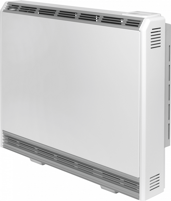

I assume you have a reason for the change from off peak to instant heaters? Storage heaters are still made 1727977529384.png why have you not replaced with new storage heaters?

I assume you have a reason for the change from off peak to instant heaters? Storage heaters are still made View attachment 357744 why have you not replaced with new storage heaters?
Storage Heaters in my opinion are old fashion and also, more important, they occupy a lot of space due to their size. New electric radiators are 100% efficient and they can be remotely controlled.
Oh no, you've been reading marketing spin! All electric heating is 100% efficient (Well, 99.999 anyway). What you have done is replaced heaters suitable for use on cheap electricity tariffs, with ones that are not. So you will be paying more for the electricity to heat the property than you would have with the storage heaters.
Old storage heaters do look old fashioned, and did leak heat when you didn't want heat. The new HHR ones are way better.

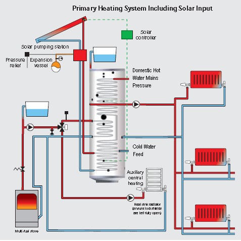

The next is storage, the multi-fuel heating system Torrent pipe example.PNG often uses water storage, as it allows many heating systems to heat the same space, this shows one tank, but in real life it is often two very large tanks, on a reinforced floor to take the weight, and can only really be used when built, the same applies to a hot air system, with a central brick store, unless in the original design really a non starter.

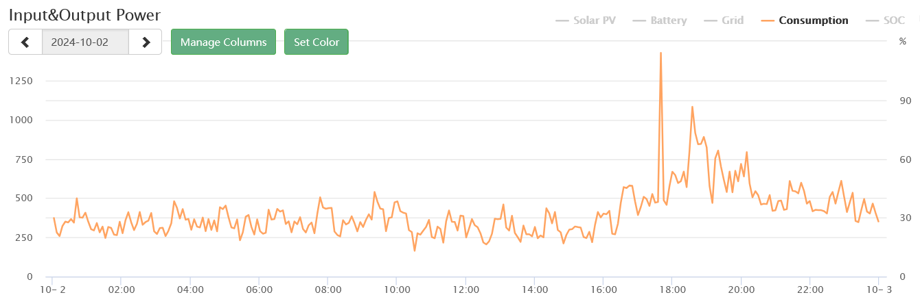

Looking at own power use, realistic wise I need 6 kW (26 amp) for living uses, which leaves me with 7.8 kW or 34 amp left for heating, so I have 14 rooms to heat, so 500 watt per room except for shower room which 300 watt likely enough, and 1.5kW for the main living room, not enough, even the 20 kW is not really enough for whole house, so only way is to never let house get too cold.

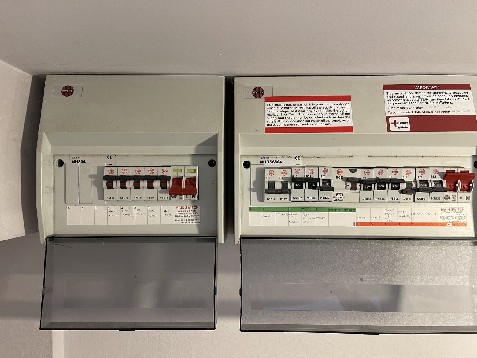

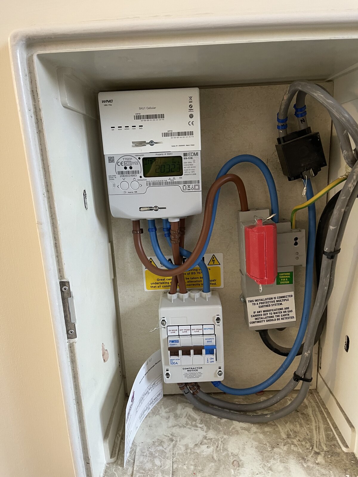

Here are more photos. If you have any more suggestions it’ll be appreciated.
A fairly easy job for an electrician. Basically, the main feed to the Off Peak board (the smaller one on the left) need capping off, and the feed to the 24-hour board needs splitting to go to both boards.
Easily done in the meter cupboard, but not a DIY jobby.
The main switch in the off peak board also needs to be changed to a compliant RCD.
The two boards are "of their time" and no longer comply with up to date regulations. While these are not retrospective, I would get both boards changed to one single board that meets today's requirements. If your budget allows...
I can't read what they all do, but with 80A over night using off peak, the rest is unlikely to be used at the same time, 100 amp fuse is the largest fitted to supply a consumer unit, theory can be 125 amp, but never seen a consumer unit rated at 125 amp.

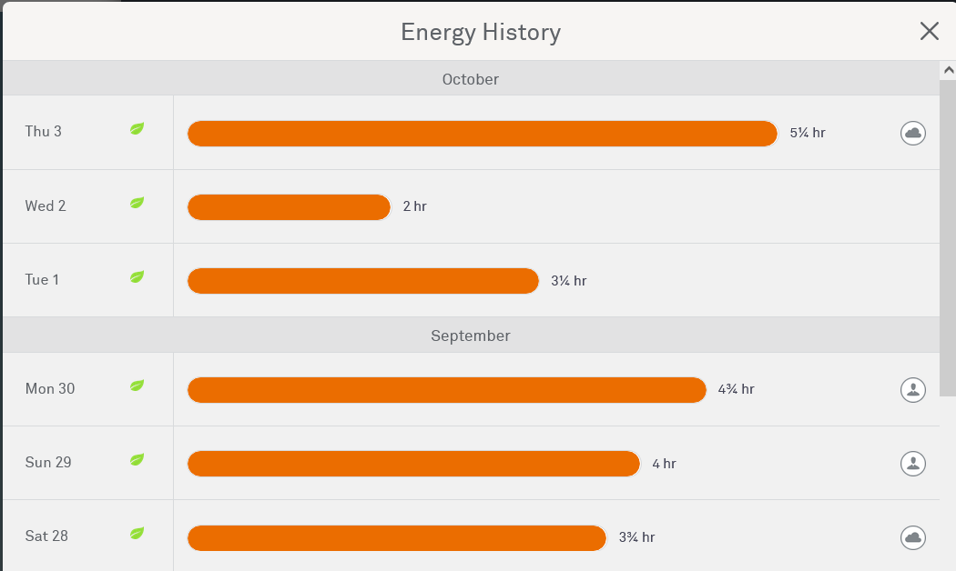

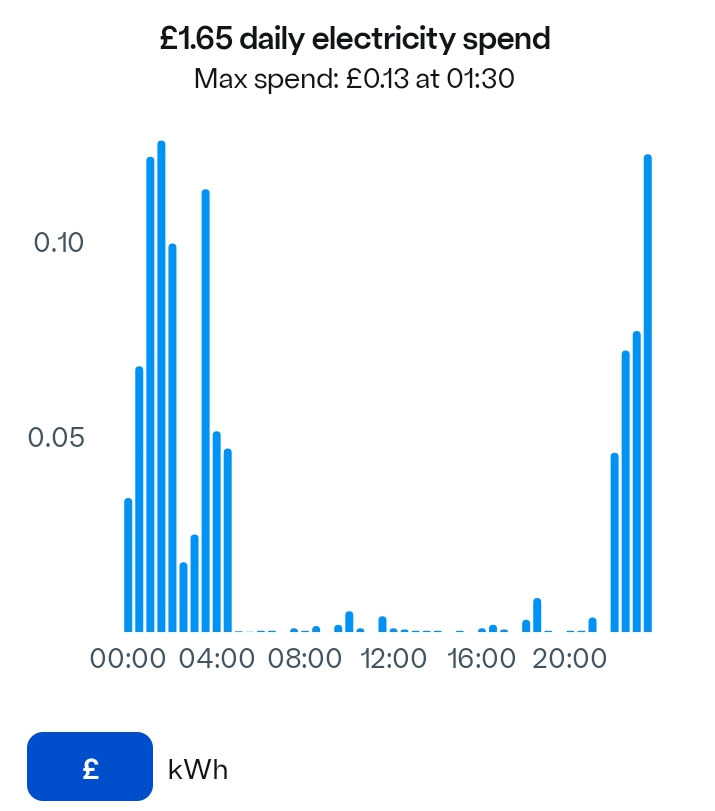

My heating is 20 kW (87 amp if I were using electric) only October and the Nest Gen 3 thermostat gives me this usage 1728046824647.png so already running for over 5 hours per day. Not really that bad, as once return water is hot, the boiler turns off, even if thermostat still calling for heat, a lot hinges on your life style, so arrive home 6 pm, put the dinner on, go for a shower and turn up heating would be a problem, but by staggering use, it is doable.

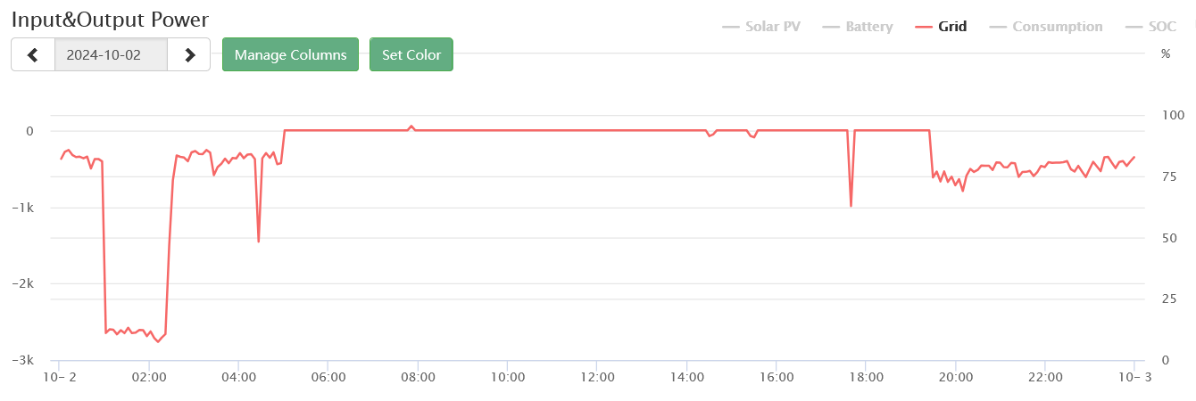

We are careful when we do what, as the battery can only deliver 3 kW and combined solar and battery 5 kW, so we try to not do everything together, so I will make coffee, then turn on washing machine, and allow it to do water heating stage before turning on tumble drier, and have showers in morning or mid afternoon.
However if we forget, then may increase my bill, but it will not cause the main fuse to rupture. And even if we did rupture the main fuse, freezers and central heating would still work from the battery and solar.

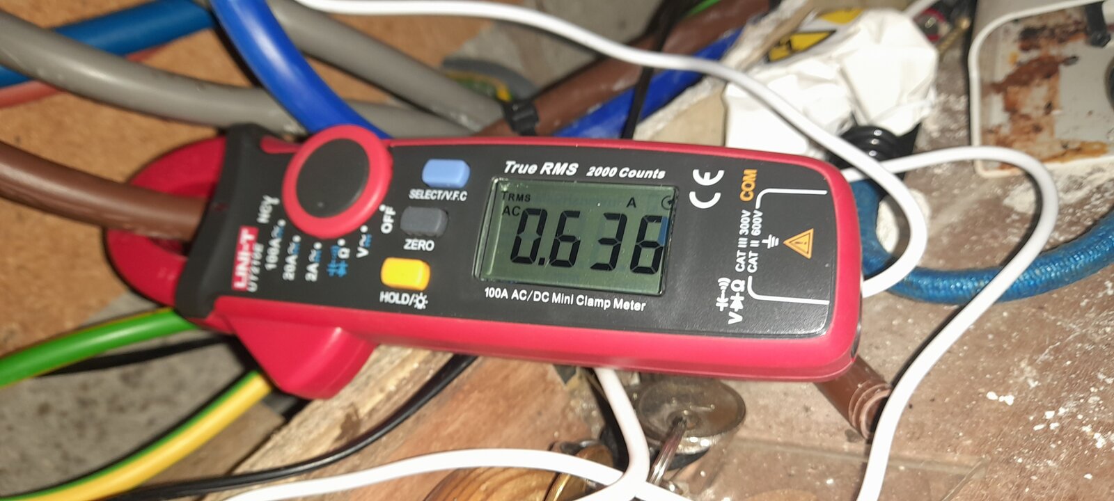

I assume with you, rupture fuse, and you have nothing? I have checked what I use 1728047546608.jpeg both with a clamp on, and smart meter in home display, (IHD) the phone app (from smart meter) and solar app are to slow to respond, and I know my 16 x RCBO consumer unit although in theroy could overload the in my case 60 amp fuse, it is highly unlikely, but I have oil heating.
The linking of the two consumer units is an easy job for an electrician, in theroy the billing agent could simply turn both on and off peak on 24/7 and bill both at same rate without even visiting your house. My meter does not switch for me, I have to set timers to use power at the right time. So getting power to heaters 24/7 is the easy bit, the hard bit is to work out do you have the power required 24/7?
The job bring up several issues;
The best place to do the link is in the meter box, in just the same way as the existing neutrals with a connectror block.
Despite whatever the contractor notice may say on the isolator, that 4 pole isolator is accessible to your contractor as the bottom cover is removable and not sealed. Good so far.
As I see it altering the feed to both consumer units is a change that requires the electrician to bring all of the circuits on each unit up to current regulations, as has already been mentioned the smaller unit will require RCD and the easiest way is to replace the main switch with a RCD.
Also the 6 'red' circuits on the right (above the red stripe) are also likely to require RCD protection which can be accomplished in the same way as the 'green' circuits, this will involve an amount of modification, (it may not be practical to do so) and it will involve moving 2 'red' circuits from their present location to the smaller CU.
As above this is all easy work for a for most electricians.
