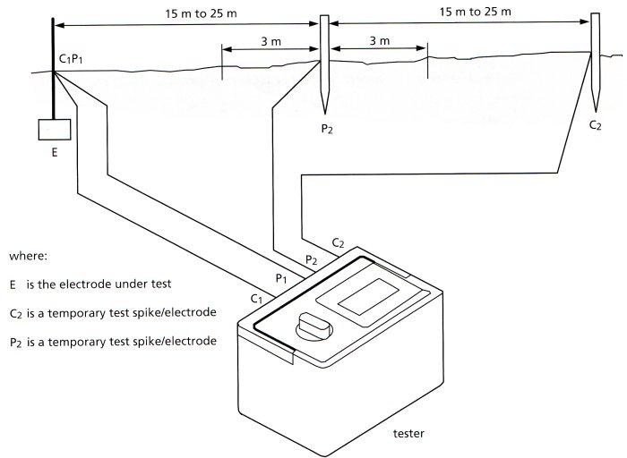

What I think you are missing there is a big difference in the resistance of the earth to the connecting of a cable to the earth. When we measure 60 ohms on an earth rod it is not the earth that is 60 ohms it is the connection of the rod to the earth which is 60 ohms.
The image shows how it is tested and how we work out how big the area is around the earth rod where there is a gradient. After this point the ground is such a good conductor one can't detect a gradient.
