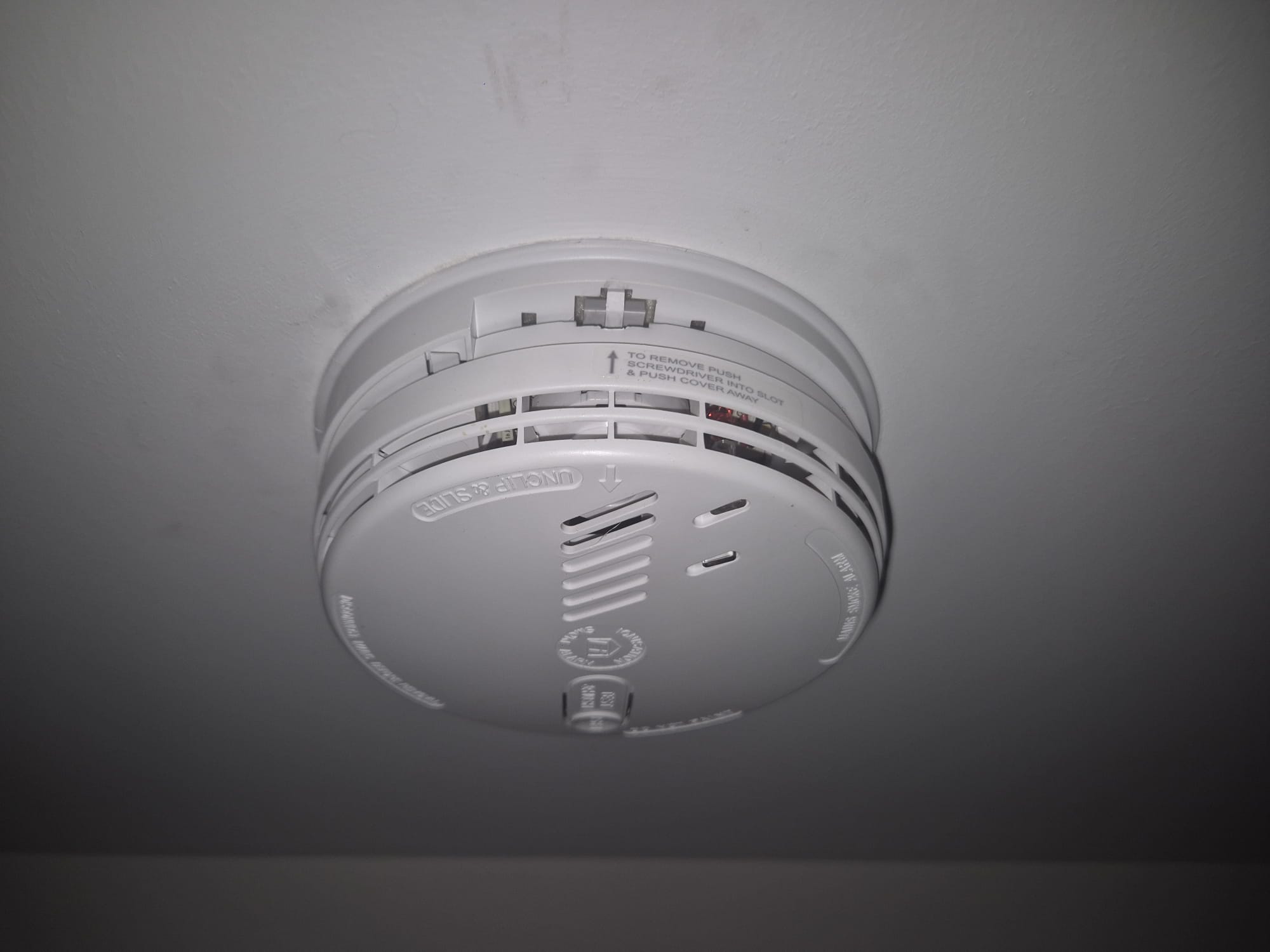

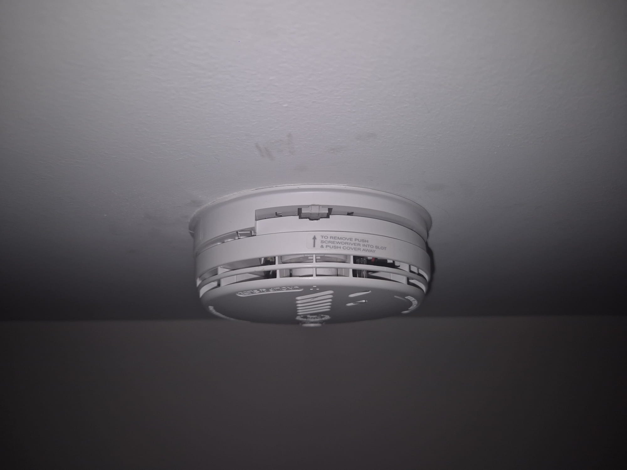

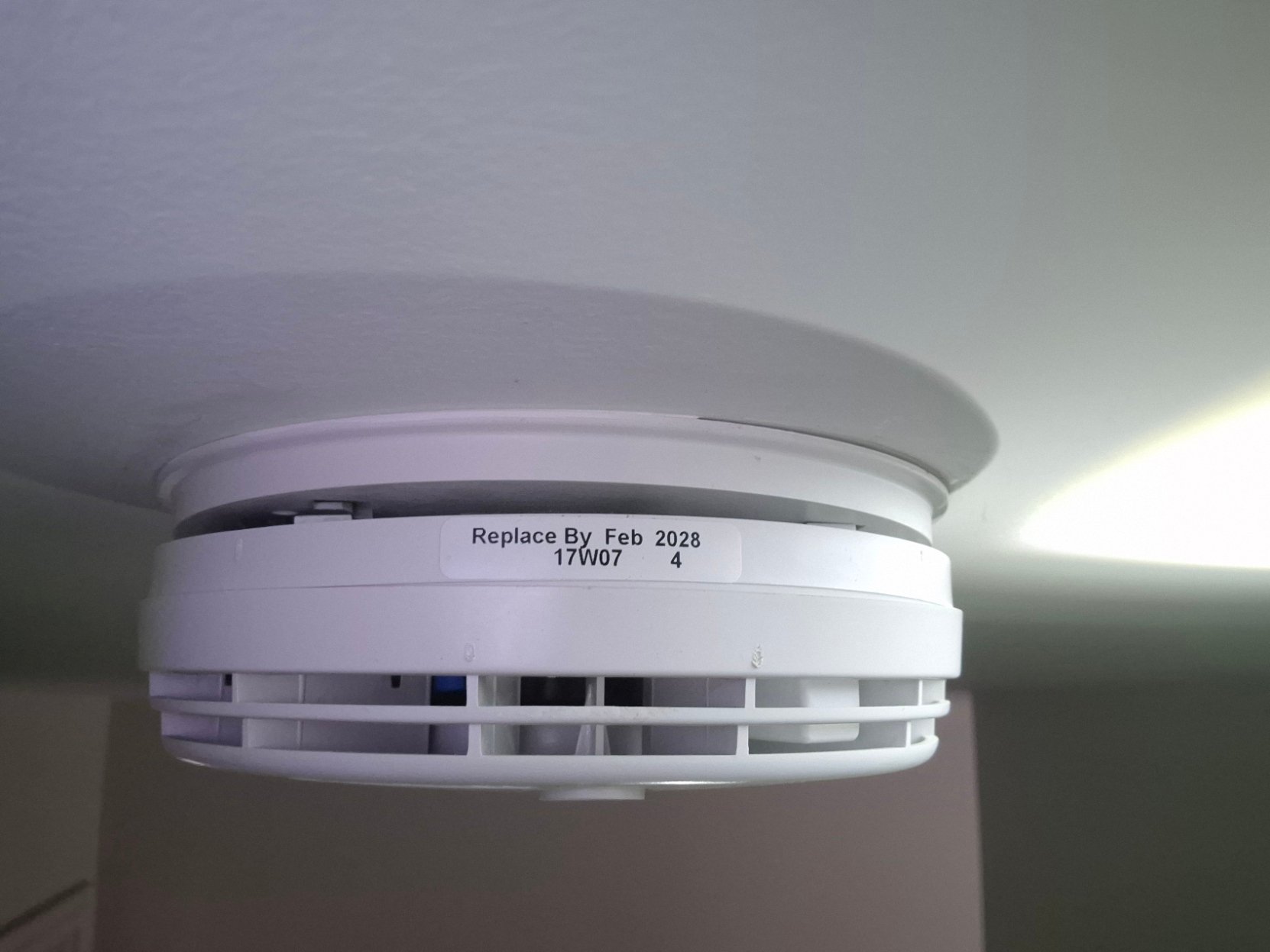

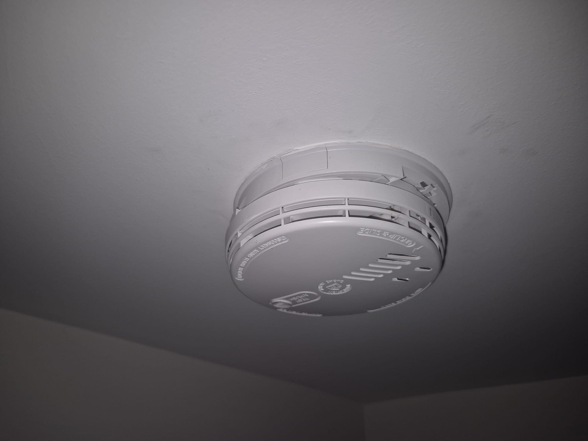

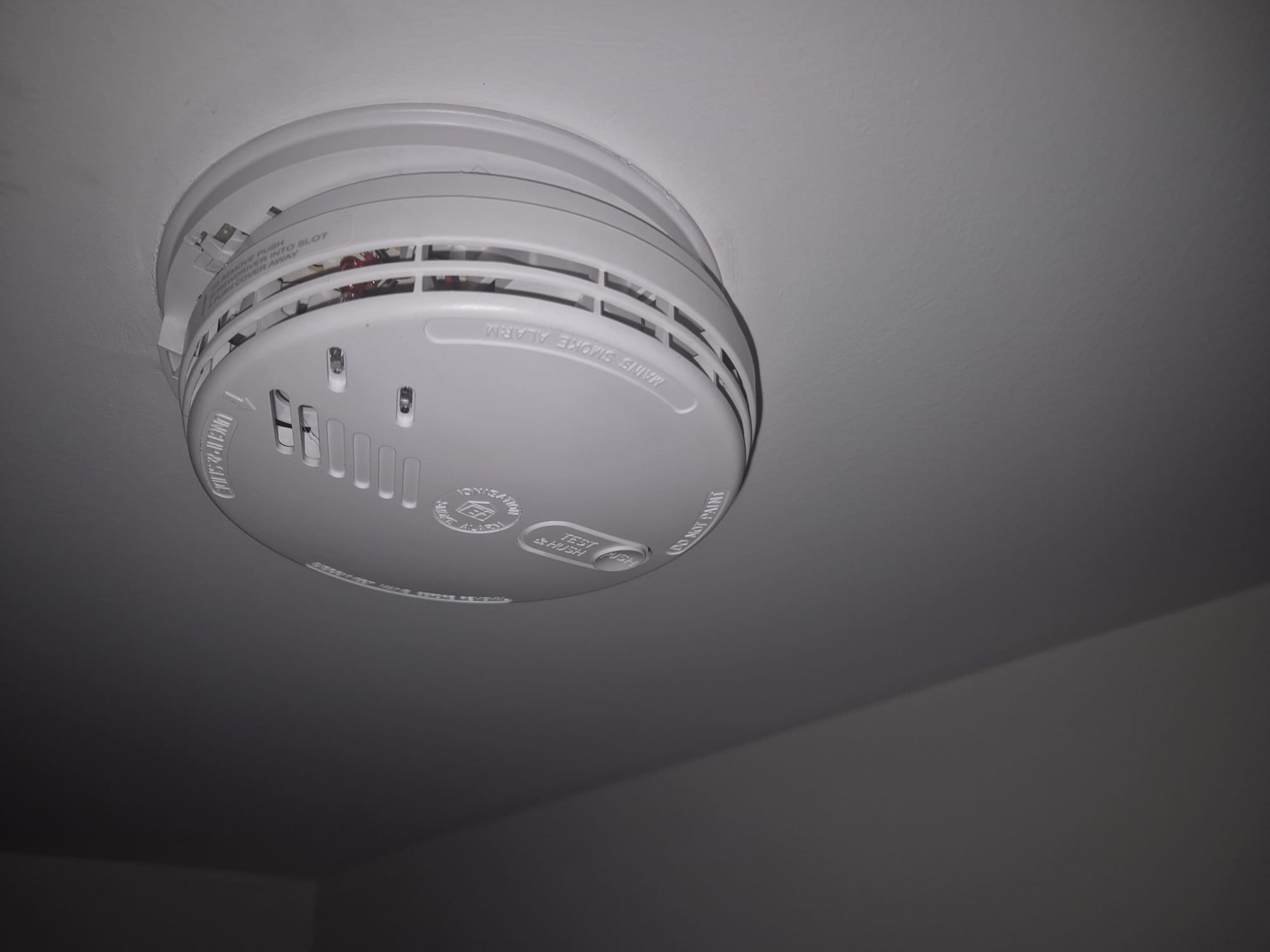

Ei141 smoke detector alarm stuck. Not sliding back in fully or back out fully
15 Sep 2026
3
I have an Ei141 smoke detector alarm. Trying to slide it back after removing and replacing battery. It is now stuck there. Not sliding into place. Not sliding back out. Cannot use any more force as it feels like it will break. HELP!

Given it’s only got about 15 months left of useful life bite the bullet and use more force.
If it breaks then it breaks
And the new one will come with a new base too
Unfortunately I am renting so the whole cost of that will fall squarely on me. For sure it will break if I push harder.
It looks like the lugs are not lined up properly.
I suspect that your step ladder was not tall enough.
Try a screwdriver at the point shown on the smoke alarm and use your, erm, other two hands to wiggle it back to remove it. Then make sure it is flat to the base when you push it back on.
I guess you were replacing the 9v backup battery.

Only time I’ve seen this happen on one of these alarms is when …a screw was put into the plasterboard without a plug …it came loose and jammed the smoke head from sliding out …
Thanks all. I have eventually managed to slide it back out and return it more carefully this time around. And yes, @opps, step ladder was too short, used a taller stool...and found me some two extra hands lying around the house unused lol. Already had the info to use Duracell or Energizer - which is what I normally use anyway from years of performing and requiring good batteries for my cordless mics. I don't even think about any other brands.
