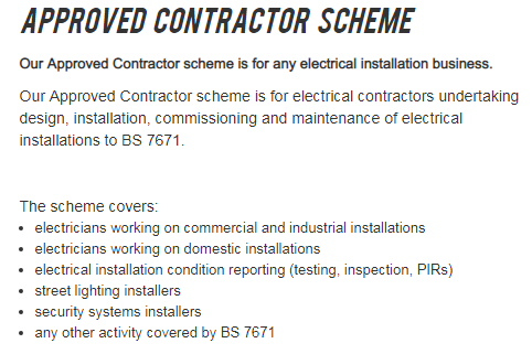

I was trying to find out the difference in actual evaluation between ACs and DIs and whether AC includes EICRs - I see from your first link that they do.

So it seems somewhat harsh for the NICEIC to say in their response to me:
"The NICEIC Domestic Installers Scheme is designed to cover the requirements of the building regulations for electrical installation work in a dwelling and therefore does not cover EICR’s.
Although the contractor may well be competent to carry out this type of work as we have not assessed him for competence under this scheme he is not covered by any NICEIC assurances or warranties."
It would appear difficult to cover all that in the "two jobs, half day assessment".
So is an EICR "Domestic Electrical Installation Work"?
