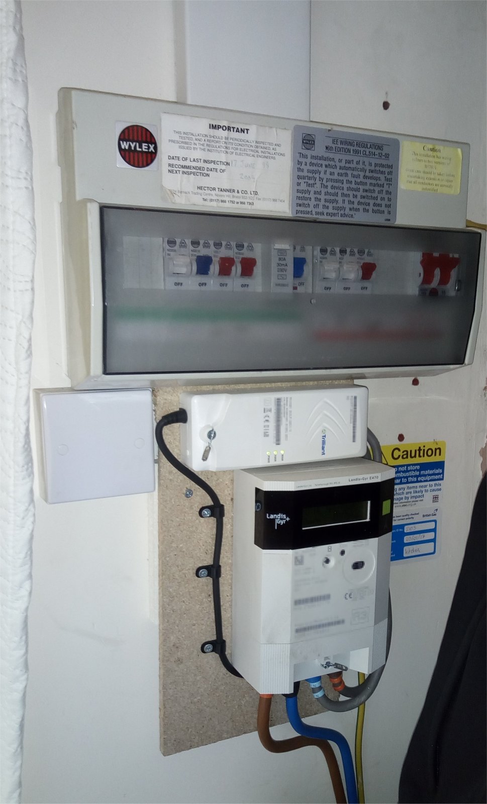

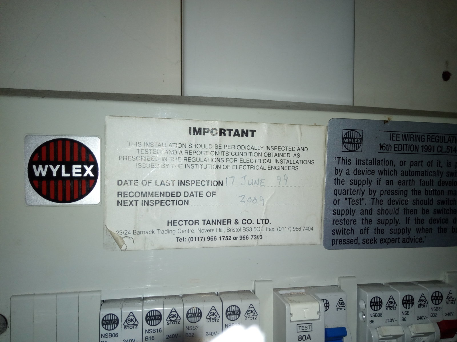

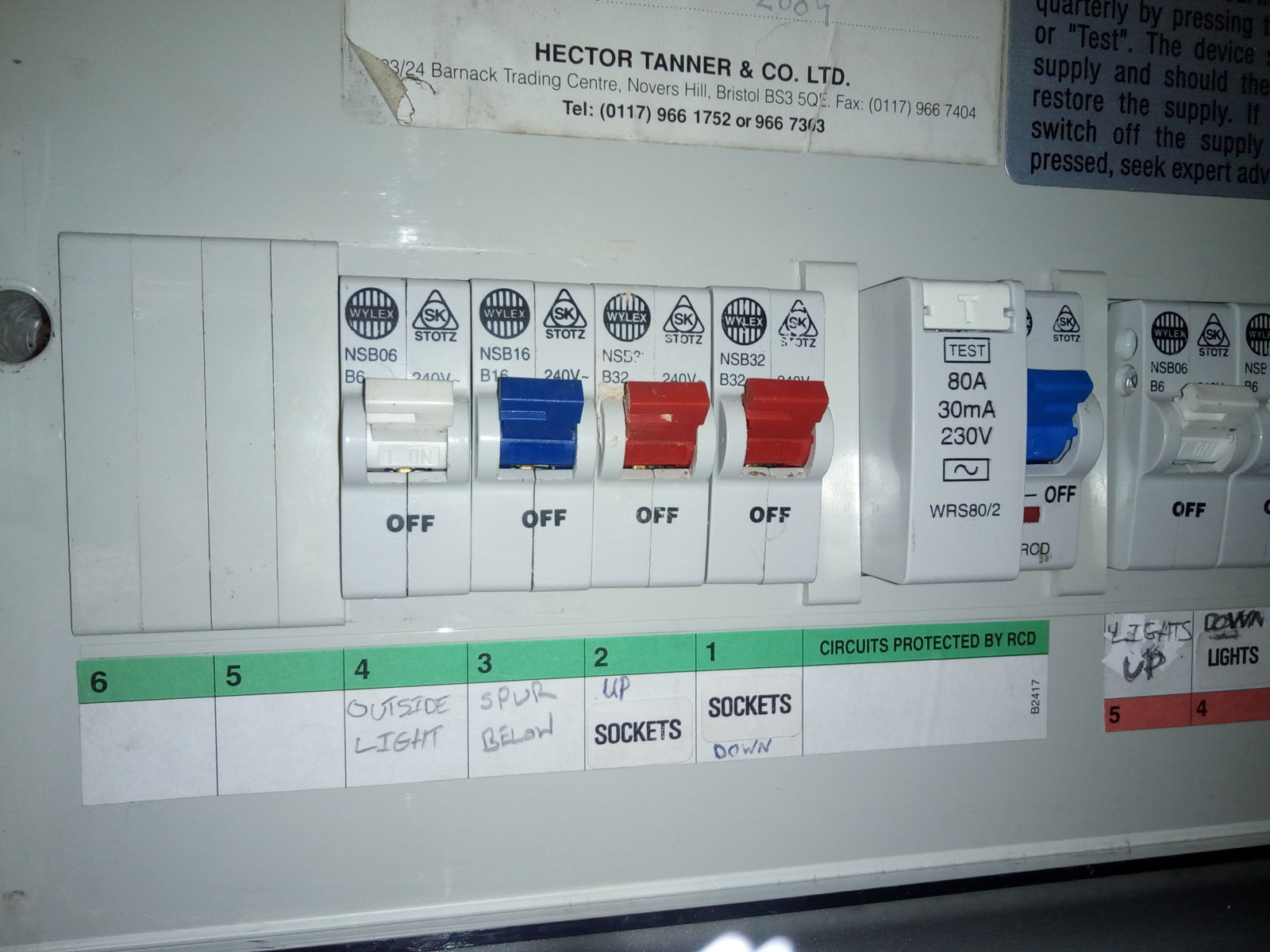

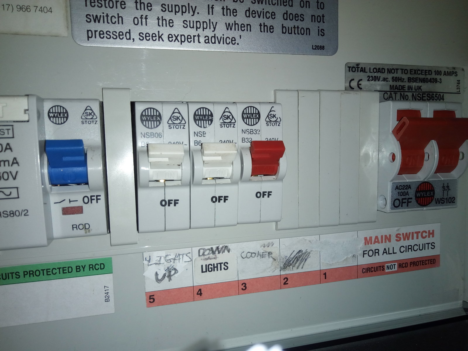

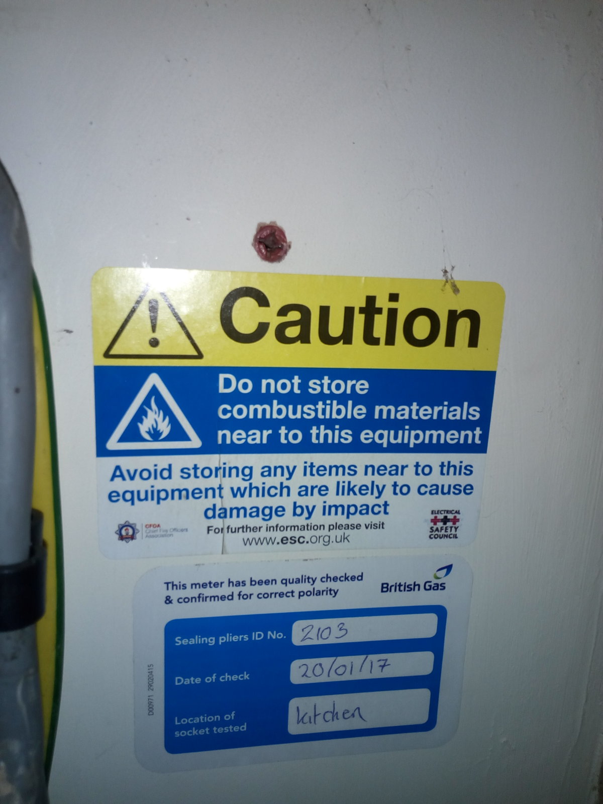

Hi, regarding the EICR I had carried out last month, I have looked at the CU and it still has an old sticker on from a previous inspection 10 years ago.
Looking at the CU, is the consensus still that updating it should be a C3 for no RCD protection on lights and cooker circuits and not a C1?
Should the electrician have put a new sticker on the unit saying who he was and that it has been inspected, or would that only go on it if the EICR results in a ‘satisfactory’ result? To me it seems odd to leave the old sticker on when a newer inspection has been carried out, however I can also see that fitting a new ‘Inspected on…’ sticker implies to the average person looking at it that it was inspected and is ok and maybe the Electrician didn’t want to do that if he felt not having the RCD was a C1?
As I read it, the only previous inspection documented by a sticker was 20 years ago, with a recommendation that a further inspection (which may well never have happened) should have happened 10 years ago.
As you've seen, opinions vary a little, but I think the consensus is that, if anything, it should not be more than a C3. Depending upon what the actual situatioin (and perceived problem) may be, the "bathroom light improvement" may well not deserve a C2.
Sorry, you're obviously right. About 9 years ago I asked the DNO to replace the wires feeding the meter (as the existing ones were physically damaged with cuts to the insulation) and the DNO replaced the wires and fitted a new meter and that's what I was thinking of. Note they have changed the meter again since then!
Hopefully the photos remove any ambiguity and good the concensus is still a C3.
The bathroom light was not IPX4, I said at the time wasn't it out of zone as it's on the ceiling and higher than 2.25m, however the guy said "needs to be IPx4 in a bathroom".
What do people do regarding putting an updated 'inspected on...' sticker on the CU please?
