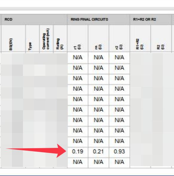

A test was carried out & a few points made.
One point was High resistance detected between ring final circuit protective conductors
I was advised one of the sockets would have a loose wire in the terminal hole or the screw has been screwed down partially on the wire & its plastic insulation.
He said he would need to unscrew every socket & look, 2/3 hours work.
Seems excessive time 2/3 hours as there isn't many sockets at all
Is there a tool i can buy to plug in each socket to advise me which socket it is.
I can then secure the screw correctly.
I'm capable of changing sockets no problem so just looking to go straight to the socket in question & rectify it.
The reading figure was 0.91
Looking at the paperwork he left under ring final circuits i see the following.
I assume this is what your asking ?

Arr ok it does seem high it should be around 0.35 ish.
Just take the sockets off if there isnt many and re-terminate the earths.

Nope if it’s 2.5 / 1.0 would be
X and 2.5 X
still not high enough to give the readings but very few younger sparks encounter 2.5 / 1.0 so they don’t recognise it
Thats what im saying 2.5/1 the earth would be 0.47, 0.91 is too high.
Are you saying for me to check wire size & advise as the reading might be ok & he didnt recognise it.
Thanks for your time.
No. The reading for the CPC is abnormally high and should be be subject to further investigation
