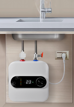

Yes, I would agree. But I would say CH and DHW are two completely different things. CH yes gas or oil, as any attempt to store and release latter seems to have problems.
But DHW I tend to use maybe a pint at a time, and I know from caravan days these things 1769703346220.png work well, I looked at the price £60 - £150 and thought not worth it for me. But the central tank is in summer using solar and off-peak, due to losses boiler to central tank loosing that much energy.
