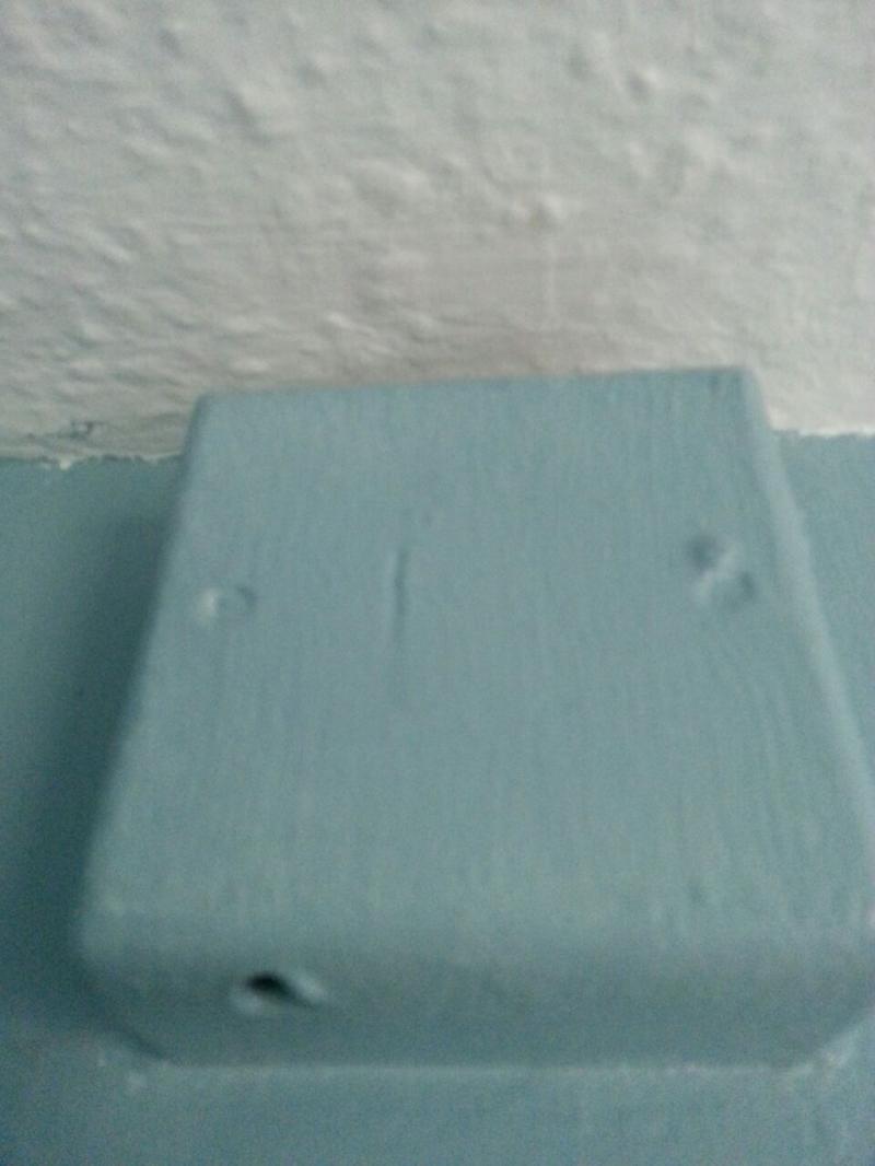

Electric Cable in bathroom
Can anybody please advise how to go about extending the grey mains cable?

If you want to use that as the power source for the fan then TURN OFF, test for dead ( confirm the power is off ) and then replace that painted over box with a new FCU ( fused connection unit ).
That will enable you to make a safe connection between the existing cable to the new cable and that new cable and the fan it feeds will protected by the fuse in the FCU

you appear to lack the basic knowledge to work on electrical equipment and wiring.

Will get a sparky in.
