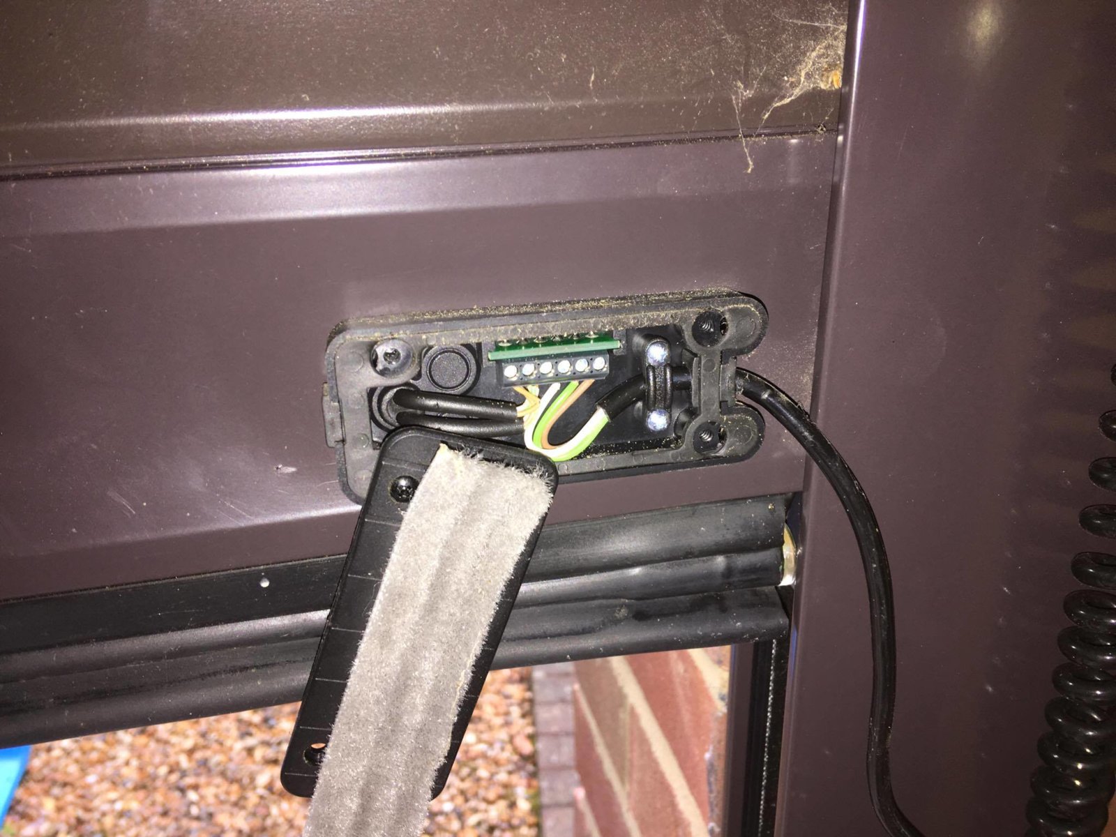

Hi Tdw. Im going to attach a pic of the bottom of the garage door at the end where the sensor is. Is it a transmitter unit? We thought it was just a sensor. On the end of it is a circular bit of clear plastic that flashes orange when there is an issue with the door. It flashes when the door is stuck closed or closes and then bounces straight back open. Can i somehow unscrew it and there will be a battery in there? It doesnt look particularly unscrew-able. Thanks.
This is more the sort of thing I would be looking for.
It would be on the inside of the door, and is on either the corner or the centre of the bottom edge. It does depend on the type of roller shutter, but they are quite common in garage doors.
It transmits the doors position as it passes certain sensors normal attached to the frame, wall or runners.

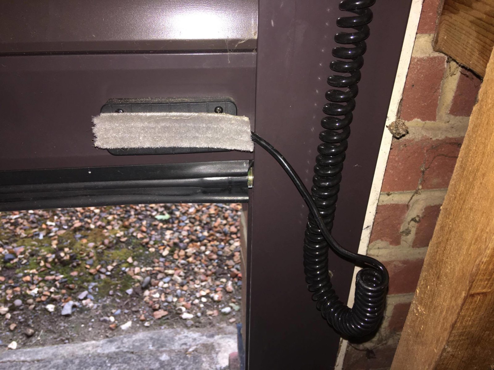

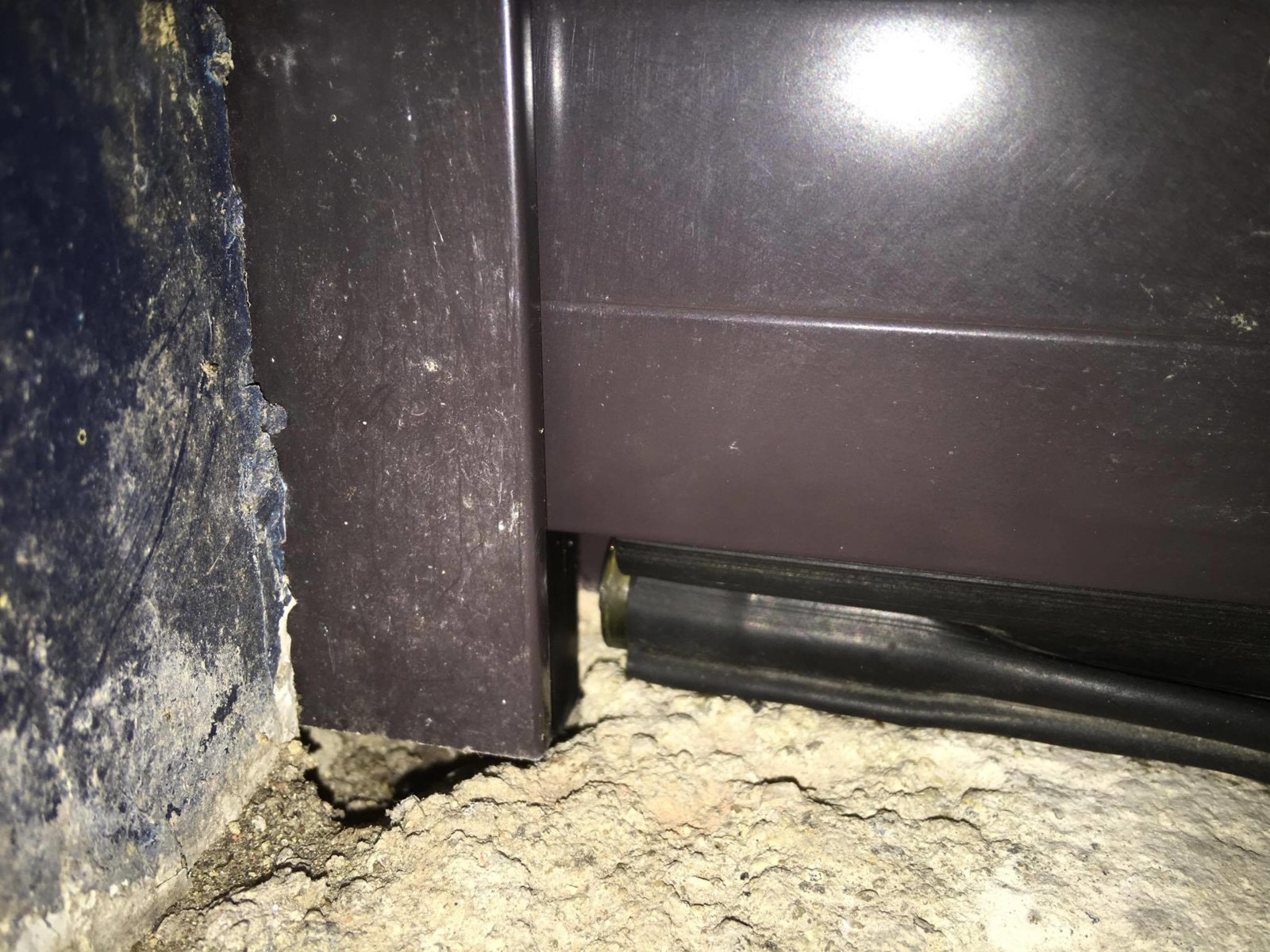

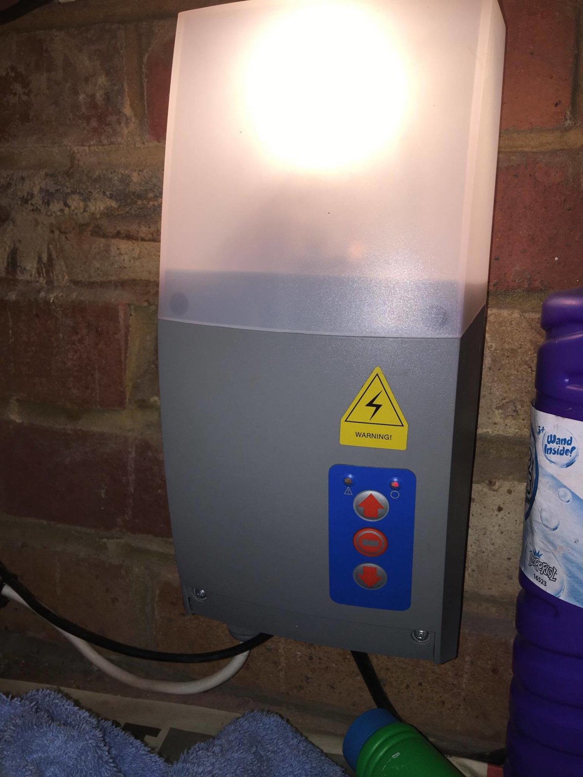

Found the transmitter but no battery inside, just a wire leading to the power source.
Any other ideas?
21584476_10155908817117018_1029013419_o.jpg 21534683_10155908816812018_421940304_o.jpg 21534521_10155908817267018_1045537287_o.jpg
That appears to be a junction box connecting the flexible ( spiral ) cable to the two cables that go into the frame. They are almost certainly cables to sensors built into the bottom of the door. These would be to detect an obstruction when the doors is closing and has not yet reached the fully closed position.
I suspect there is an adjustable limit switch in the motor / gear box that determines when the door should stop moving downwards just before it touches the ground ( with a separate limit switch to stop it in the fully open position ). If the downward limit switch setting has changed ( wear and tear ) then the door will touch the groumd before it stops. The sensors will see the ground as an obstruction and immediately cause the door to move upwards.
