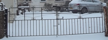

Ten years ago I looked into having the existing gates to my yard "automated" but gave up the idea as customers and delivery drivers to a florist's shop which I rent out often need to drive into the yard.
The gates are a pair of swing gates
which open both inwards and outwards
Had I gone ahead the plan was to have "soft" gate drives. These would have a slipping clutch linkage so as not to force the gate to move with an irresistible force. Any obstruction would stop the gate moving and the clutch would then slip.
The amount of slip ( difference between required position and actual position ) would be monitored and eventual switch OFF the motor and create an alert.
The idea was that a pedestrian could push the one gate open and it would then gently close behind them.
In the closed position when visitors were not expected then a lock mechanism would operate to lock the gates together in the closed position.
One problem would have been convincing the authorities that the slipping clutch linkage would slip when it was necessary for it to slip
