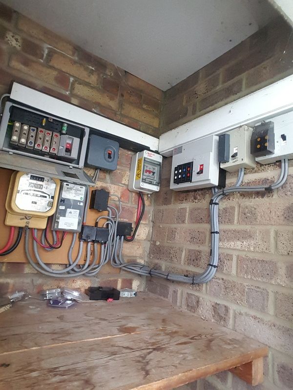

I've just discovered my electric meter (old analogue type with a whirly disc) creeps round with the main switch on my CU turned off. It's moving about one or two degrees per second, so not very much, but is it worth getting it looked at or is this normal please? TIA
Does it eventually stop or have you not had the power off long enough to check? It shouldn't be metering its own usage. Have you checked to see if there is any usage via way of clamp meter or something like that? (even though the main switch is off but you never know)

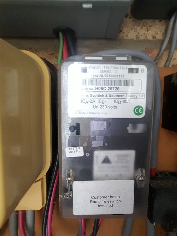

Watched it for a good couple of minutes and it just kept going. I don't have a clamp meter but might be worth investing in one...time I upgraded my old multimeter anyway. There is a suppliers' remote isolation switch on there, does that draw power constantly?

If you have 6 CUs then there's every chance there's something fed from a permanent supply, doorbell transformer perhaps or a telephone master device?
Next door tapped into your supply?
You should really have a master switch for your own use, so you can isolate everything in one go.
My meter says 240 revs/kWh. So 2-3 degrees per second would be about 100W I think. You should be able to find that!
a photo of the incomer/meter/switch could be handy. Should be able to see if there's anything obviously not right.
Could well be a faulty meter.
You'll need to start at the meter, and using the clamp meter, see if you can check the feed route.
A switch does not draw any power.
What happens when you turn that off??
I can't, it's a suppliers' radio teleswitch, hence wondering whether it might be drawing power. Pics below. Sort for the slow reply everyone - had to go away for a few days...
Doorbell is a battery job so it's not that. We don't have a landline phone. All a bit of a mystery. Can it be tested? We requested a new meter when we moved in but our supplier said that they didn't change meters
