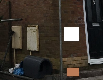

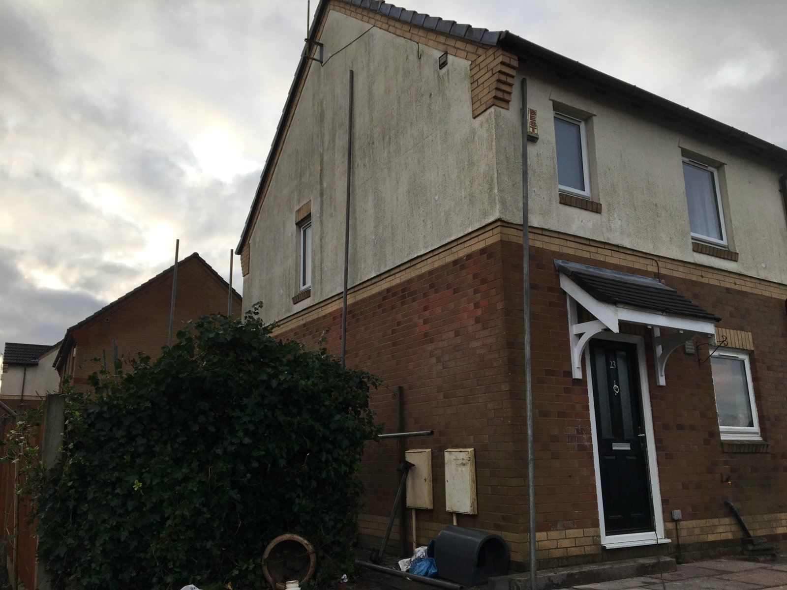

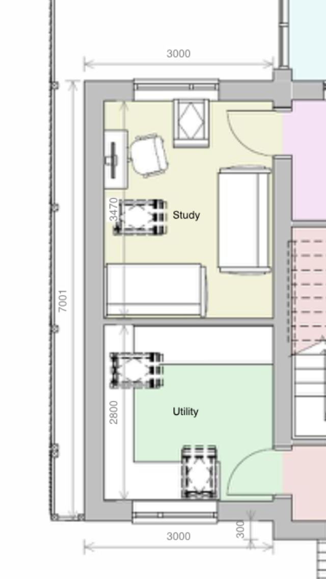

View attachment 136309 Can anyone advise on my what to do with my gas and electric meters outside the side gable of my house as I want an extension building and they are in the way where the front wall is going
Where they are now I want an internal door to new room
What should I do ?
I have tried to attach images

Discuss the new location with the Gas transporter ( Probably Cadent, previously National Grid ) and for the electric meter contact the DNO for your area
http://www.energynetworks.org/info/faqs/electricity-distribution-map.htm
The boxes need to be located in a position to where the existing supplies can be easily re-routed. Other wise you may have a much larger bill for a new service connection.
( You should delete your address details from the image )
You can get the new boxes from Frazers in Radcliffe, not too far from you.

So should I situate them on the front wall of the extension
That would require the gas and electricity to be disconnected from the existing meters and capped off until the new wall was built and the boxes in place. The DNO might say that the electricity supply could be relocated to a temporary meter location in the garden so that electricity was still available during the build process.
If it were my project then I would have a semi concealed gas meter ( brown box that sits in the ground ) and electricity meter above

Moving the electricity meter to a temporary location can be done by the DNO if the supply cable in still flexible enough to bend to reach the temporary location and also still be long enough to reach the final location of the meter when the box is ready in the final position. Ask the DNO as they will be the people doing the work.
Moving the gas meter to a temporary location is possible but will be expensive as gas supply pipes are not flexible and would need cutting and jointing.
Shall we move just the one then that’s in the way of the wall
Skeff - nothing can happen without the involvement of the people who own, and are the only ones who can move, the cables and pipes.
You need to be asking them what the options are for final position, intermediate temporary positions etc.
I think you'll have more bother with that low pitched roof/velux's than your gas/electric meters:unsure:
