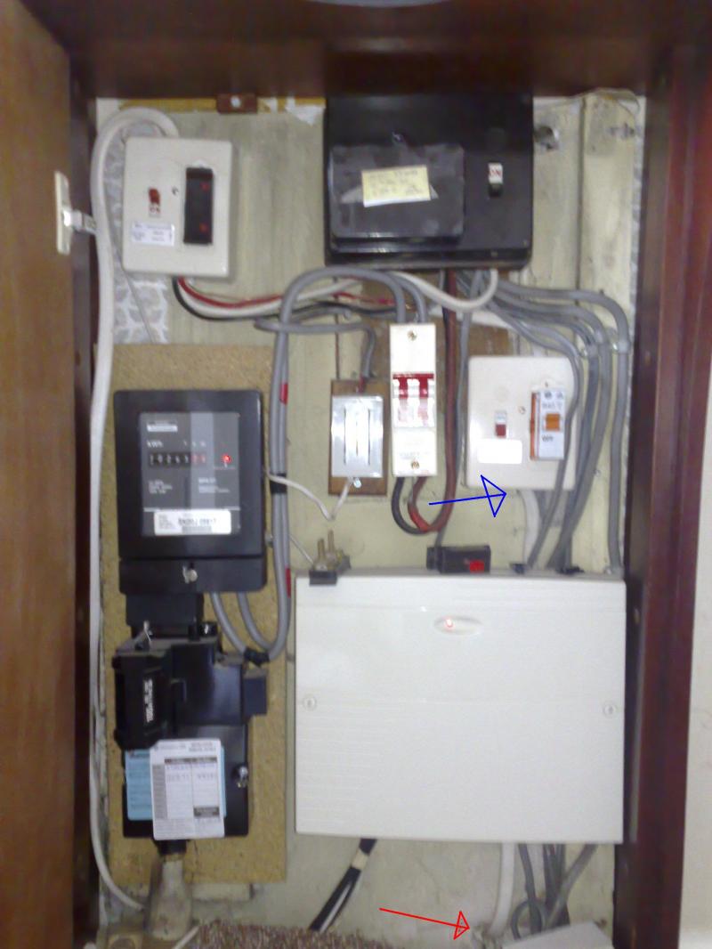

See picture of my mcb, bit off a mess (next job to be sorted in newly bought house).
Red arrow shows shower cable coming into elec cupboard, it goes to a fuseof its own (blue arrow), which is fed elsewhere in the cupboard by a similar large white twin and earth (working backwards in my description).
any help/suggestions?

But on a more serious note - do my eyes/monitor deceive me, or is there no main earth conductor?
I certainly can't see one from the supplier, and no RCD if it's a TT supply.
Also it looks as though the two 1 way wylex boards are fed of the top of the main switch of the 4 way CU in ~6.0mm² twin and earth cable :?
<edit> that looks like a 40A MCB in that shower CU too. What's the maximum outgoing device rating of those?

I would loose both those wylex domino collections, find some earthing PDQ and have that made neat and tidy!!

Before you do anything you must get your earthing sorted out - this is very very important.
New CU, tidying up, removing the shower - these can all wait, but the earthing can't.
I've just put the image into photoshop & zoomed in.
It is very blurred, but there does seem to be something attached to the cutout where an earthing conductor should be.
Can't read the writing on the 1 way Wylex box, though! Although there is a 30A 1361 fuse below it.
