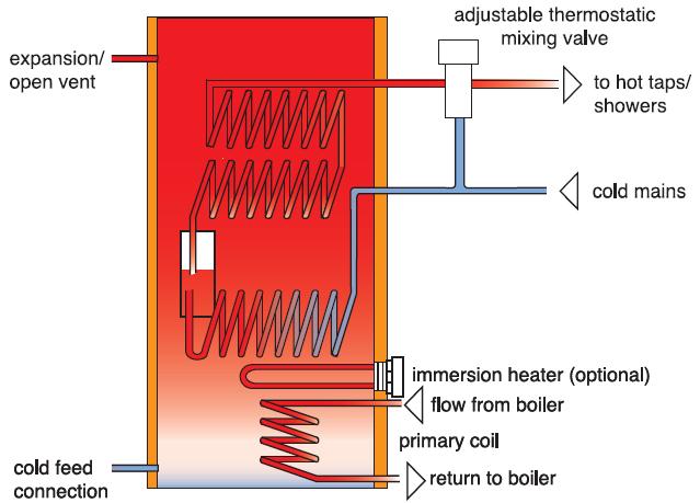

I am looking at running 3 electric storage heaters/heaters in conjunction with my back boiler. Basically i want another way to heat my house with out having an fire.

The storage heater is only really going to be worth while when you have the special supply to give you cheap power at set times of the day. Clearly the standard brick type are no good as standby.
There are versions which heat water in a very well insulated tank then pump it around as and when required. This system may be worth looking at. You could heat the water with your back boiler and when required supplement it with electric.
That is a general plan and as you see one can fit as many hot coils as you want and gain heat from many sources and use it all to heat the same radiators.
Against the system is cost to install. It seems there are two types pressurised and non pressurised the former can work with hotter water but requires an annual test.

If you have the space in the garden to lay the collecting pipes then a ground source heat pump is probably the best option if you are restricted to electricity as power source. Use that to heat a large thermal heat store ( large well insulated tank of water ) from which you can draw of heat as and when you need it.
The same heat pump with the right plumbing can also be used on a hot day to "move" excess heat from the house and into the heat store for future use.
The thing you need to consider is ventilation, especially if it is an old cottage. You can reduce heating costs by making the house almost air tight and draught free but the adverse affect on health then needs to be considered. Sealed houses need means to remove water vapour otherwise condensation and possibly black mould become problematic.
It may be long term cost effective to use an electrically heated heat store using Off peak electricity as the interim method. ( bear in mind daytime cost per unit is considerably higher with an economy tarif so cooking etc is likely to be more expensive.)
The heat store can then be used as part of the system installed in two years time. By which time you will have experience of what is needed and not just estimates of the heating requirement.
