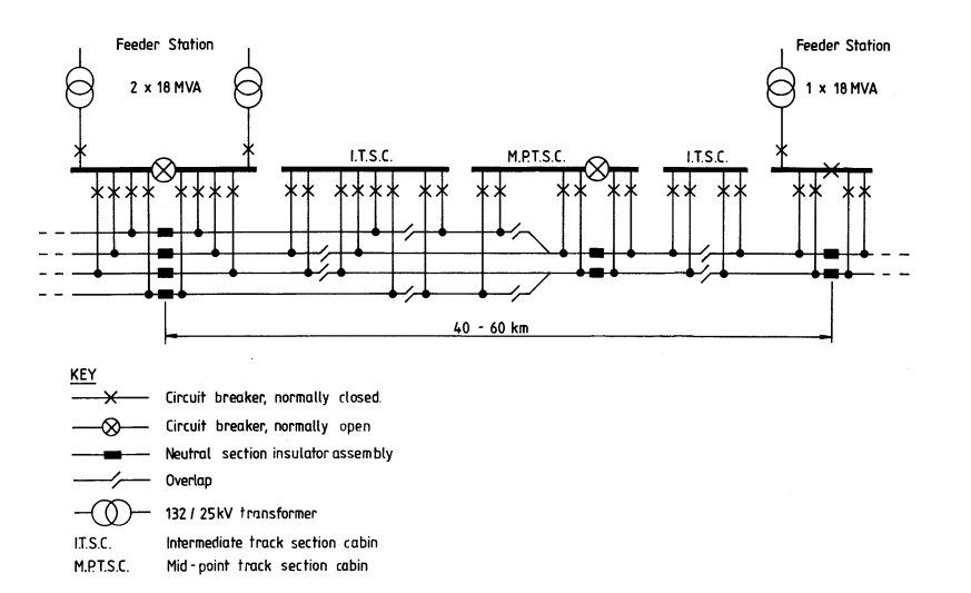

The 25 kV overhead supply for electric train traction is single phase.....
Does this mean the supply to Network Rail's power feeders is a single phase supply from the local electrical supply network which would create a significant un-balance in the local network.
Even if it is a "single" phase derived from two network phases there will be un-balance between the phases.
Or does the system take energy balanced across three pahses and then convert that energcy to a single phase supply to the overhead 25 kV ?
As far as I know, the network is split into sections with the transformers across different phases. SVCs are used to stabilise the network.
See image attached. Insulating sections are inserted where the supply is going to be fed from a different set of phases. Most of the transformers can be remotely switched between any of the two phases as needed.

Impliies a single phase transformer.
I have e-mailed the question to Siemens who aare installing the local feeder station.
Partly for my own interest but also because a lady living close to the railway asked me " Will the light flicker when a train goes past ? "
I don't think they will flicker as the DNO will almost certainly require that the supply to Network Rail traction is a dedicated supply and not taken from any part of the local network

Sometimes the TNO will install load sharing equipment on site (though I’m not entirely sure what this consists of) to balance out a 2-phase supply across 3 phases.
400kV is generally the norm now unless not available. 132kV was the maximum possible when the original networks were installed from the 60s to 90s.
