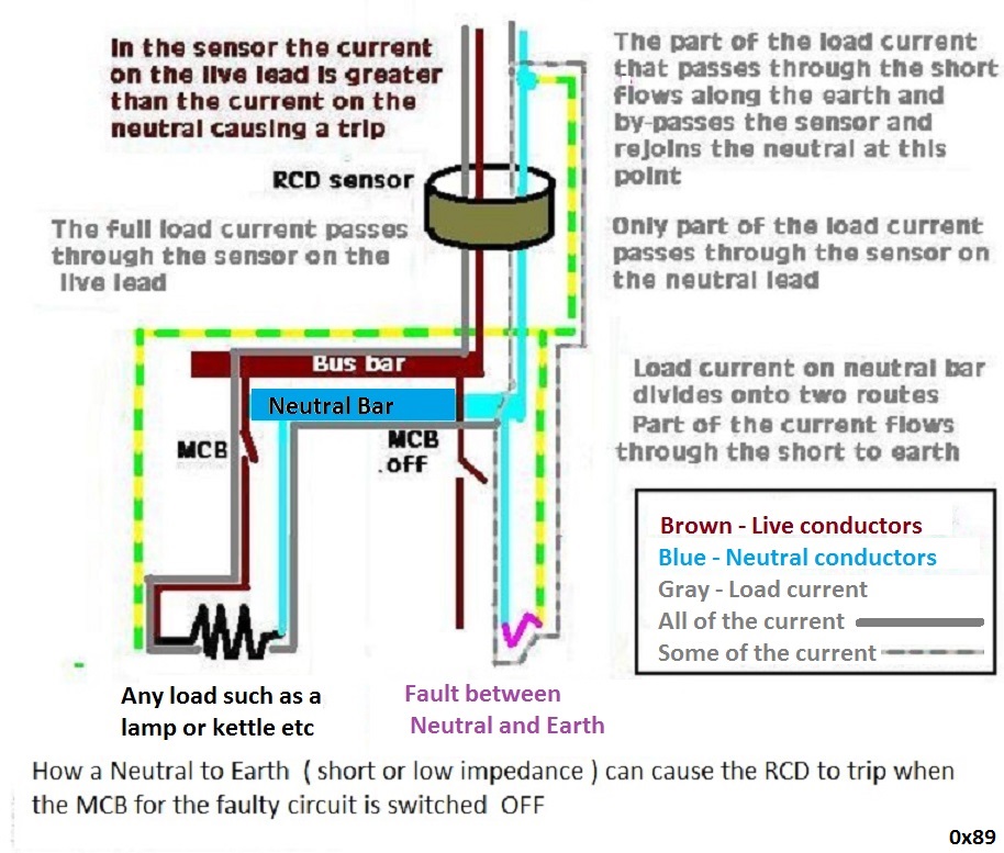

    The UFH may not be at fault. It might be a Neutral to Earth fault elsewhere that causes the RCD when a significant load ( such as UFH ) is switched on and some of the Neutral current from that load is diverted away from the RCD by the fault.
    Some electricians are unaware that this can happen and only test the circuit which appears to be causing the trip.
