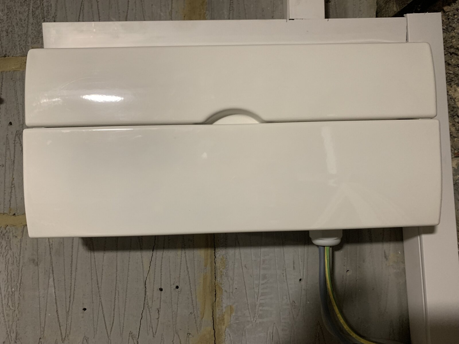

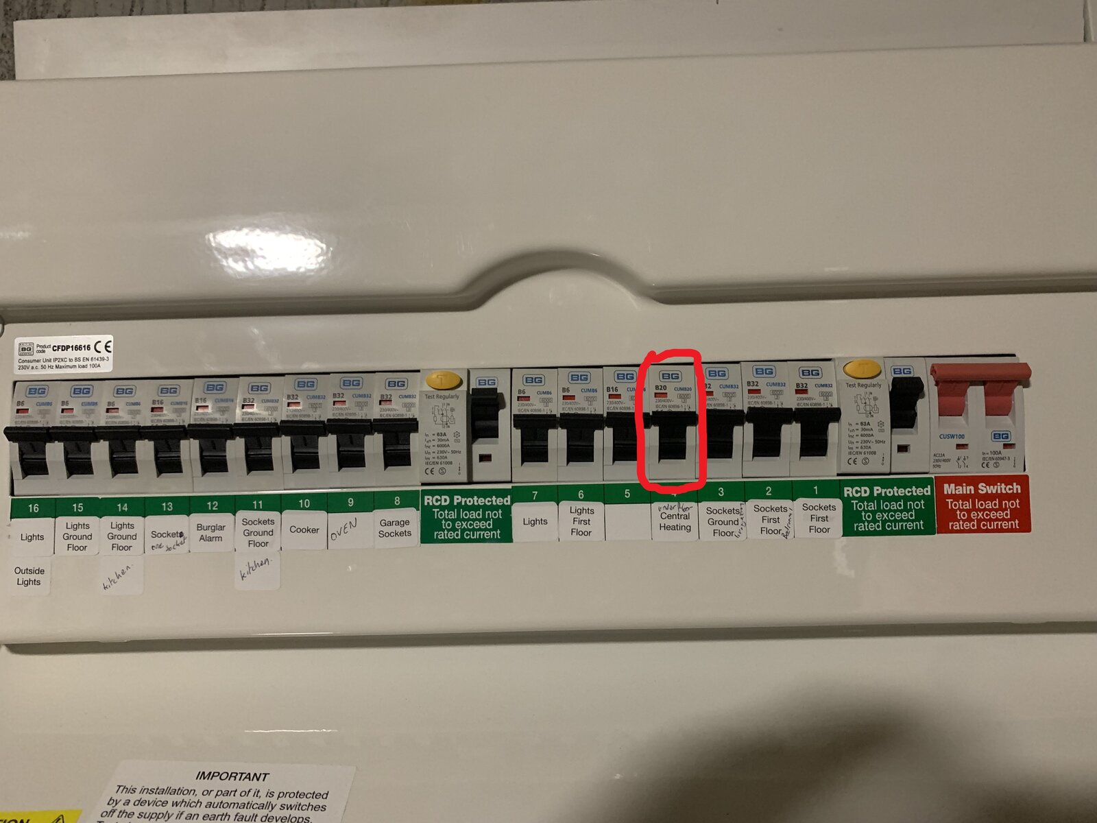

Please add a photo or the 'new consumer unit' and a clear image of exactly what is tripping.
Thank you. Please find attached photos as discussed of the unit and I have circled the MCB which trips. The value on there is B20 if that helps.

That device tripping after a few minutes is due to overload, so either the heating is a lot more than 20A, or it also supplies something else and the total of that and the heating together is over 20A.

Hi guys, so my electrician came round just now (he didn't charge me for it), and he realised that that MCB was too low and changed it for a 32A MCB. We switched the UFH onto 25 degrees and it's slowly increasing and is currently at 24.5. Thankfully it hasn't tripped and the floor is heating up nicely. He also tested all the mat wiring to ensure none had failed and they all tested out fine. So i think the error was the low amp MCB.
