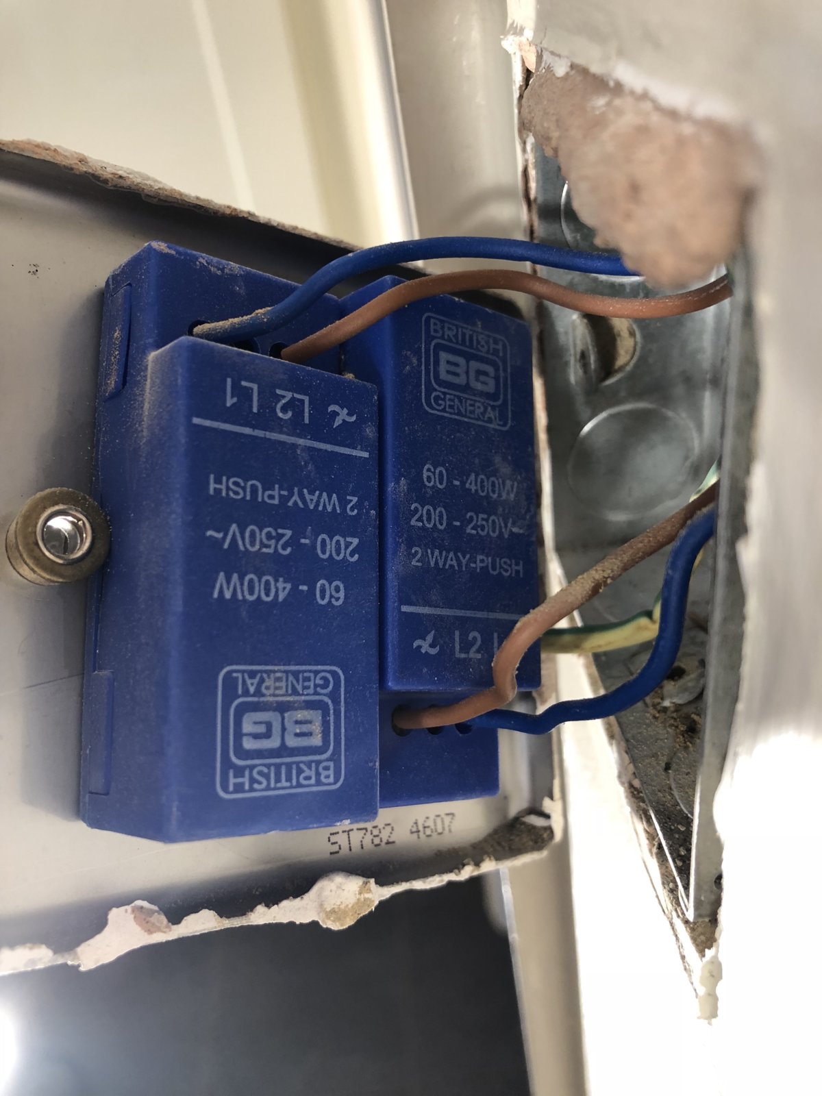

Many thanks JohnW2.
I did take a picture of the dimmer wiring prior to replacing with the new one to ensure that I fitted the wires correctly. See attached.
I have not got a picture of the ceiling rose wiring at present as I satisfied myself that the connections were ok. It's too dark to take one now.

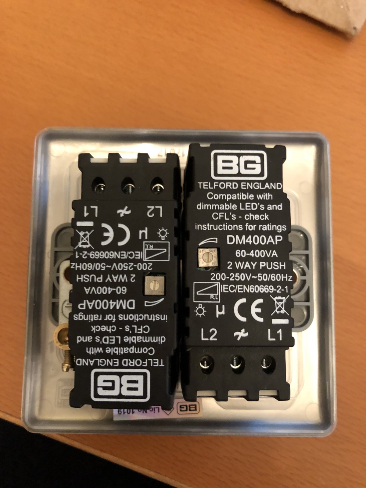

Here's the replacement and only just realised that my new dimmer is from the same manufacturer.
Many thanks JohnW2. .... I did take a picture of the dimmer wiring prior to replacing with the new one to ensure that I fitted the wires correctly. See attached.
Thanks.
If (with power off) you temporarily put both wires from the dimmer in question into one of its terminals (doesn't matter which), when you turn the power back on the cabinet lights should be 'on' permanently (as if you had substituted an ordinary {non-dimmer} switch and switched it on) - so you could ascertain whether the noise in the dining room lights then occurs.
