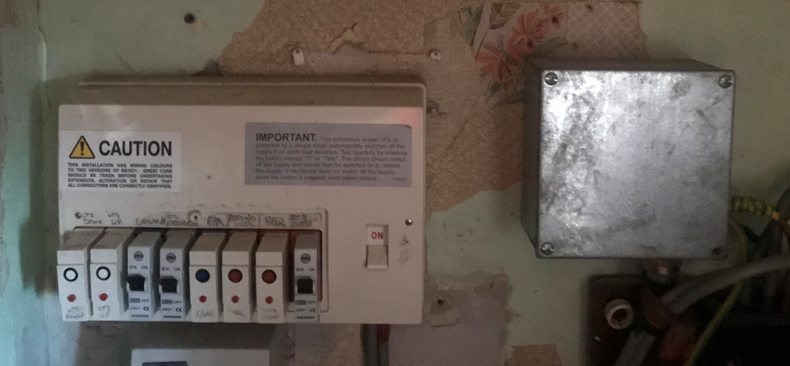

Here's some additional info as requested.
Inside the house, I have the following:
The armoured cable going into the Consumer unit in the garage is connected in side the metal box shown above.

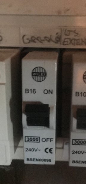

The breaker for the garage is B16. Seen clearer in thus image:
This appears to control power to the garage. I believe that I have a 10mm armoured cable.

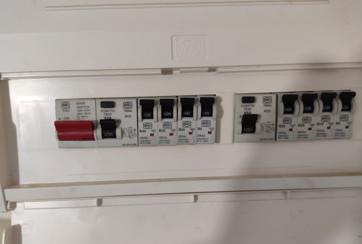

Inside the Garage, we have this consumer unit:
The Ring Main that I would want to spur off is powered by the B32 breaker.
I hope this answers your questions and look forward to your guidance.
Did you install that?
First of all, there is absolutely zero point in having a 32Amp MCB in the garage. The maximum current draw cannot be more than the 16A.
so installing a ring final on a 32A mcb is pointless.
All current limiting devices should be designed so that the largest is at the source, and smaller ones at the load end.
Given the state of the house fuseboard, you should be ripping that old Wylex board out and replacing it with the twin RCD unit from the garage!
But I guess we have to deal with a right mess…
What do all those MCBs in the garage Do? Where are the labels? Are any of them spare?

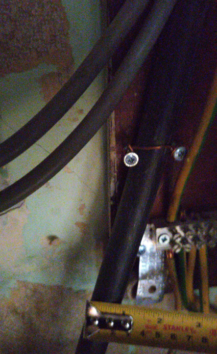

Re the SWA size. You say it’s 10Mm². Nobody in their right mind would put a 16A MCB on 10mm² SWA. What makes you think it’s 10mm². How did you measure it?
My first thought was "" Is the meter in the garage by the dual RCD consumer unit and that consumer unit is feeding the one in the house. ""
But there is a ceramic mount, board and maybe meter tails visible next to the non RCD consumer unit so my first thought has to be wrong......doesn't it ?
What a strange un-designed installation.

My neighbour who fixes air conditioners for a living commented that the armoured cable is 10mm. It seems very thick to me.

Re the SWA size. “Very thick” doesn’t help. Most SWA cable has the size embossed on the outer sheath. It may say something like 2x10, or 3x6.
What’s on yours?

I couldn't see any text on the cable. I have put a tape measure next to the cable to provide an indication on size:
Excuse the fuzzy pic but you should be able to see that this is almost 2cm.
I'm struggling to see the cable feeding the silver box, it almost looks like tails [I'm outside in the sun so struggle with the image], I think I see a wire wrapped with green/yellow and 2 more.
That could easily be 2 or 3 core 10mm².
I wonder if the B16 may have been bigger in the past.

3 core 10mm² SWA outside diameter is nominally 18.9mm. But it’s the csa if the live conductors that matters.
Youve probably room for increasing capacity, Above 16amp, On the SWA, but have this assessed by a registered electrician when you have that fuseboard mess replaced.
