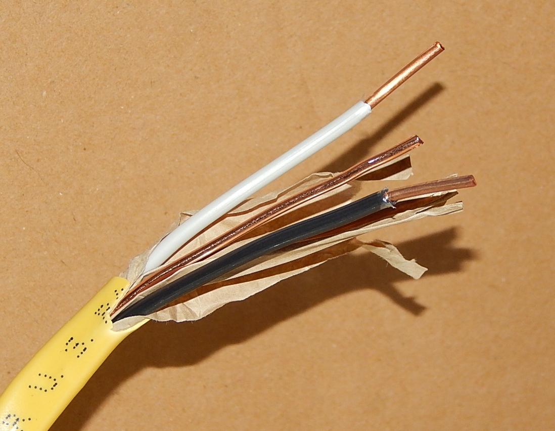

In terms of the physical equipment, type NM (Non Metallic sheathed) cable is the equivalent of British T&E and used in pretty much the same way, although it has a slightly different construction. Conduit systems can use two different thicknesses of PVC conduit (known as Schedule 40 & Schedule 80) depending upon requirements, and as well as heavy gauge steel conduit there are also thinner types, such as EMT (Electrical Metallic Tubing), which is something akin to the thinwall metal conduit which can still sometimes be found in British homes of the 1930's. There's nothing really equivalent to British SWA cable here. Armored cables are an interlocking metallic sheath containing the conductors inside, looking something like a metallic flexible conduit in overall appearance.

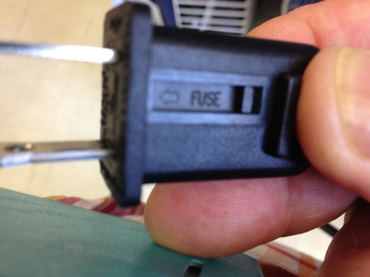

This moulded plug was on a fan for sale in New York last year.
O.K., I should have said not routinely used. :) There were also some unpolarized plugs around years ago which were fitted with two fuses. But fused plugs are the exception rather than the rule.

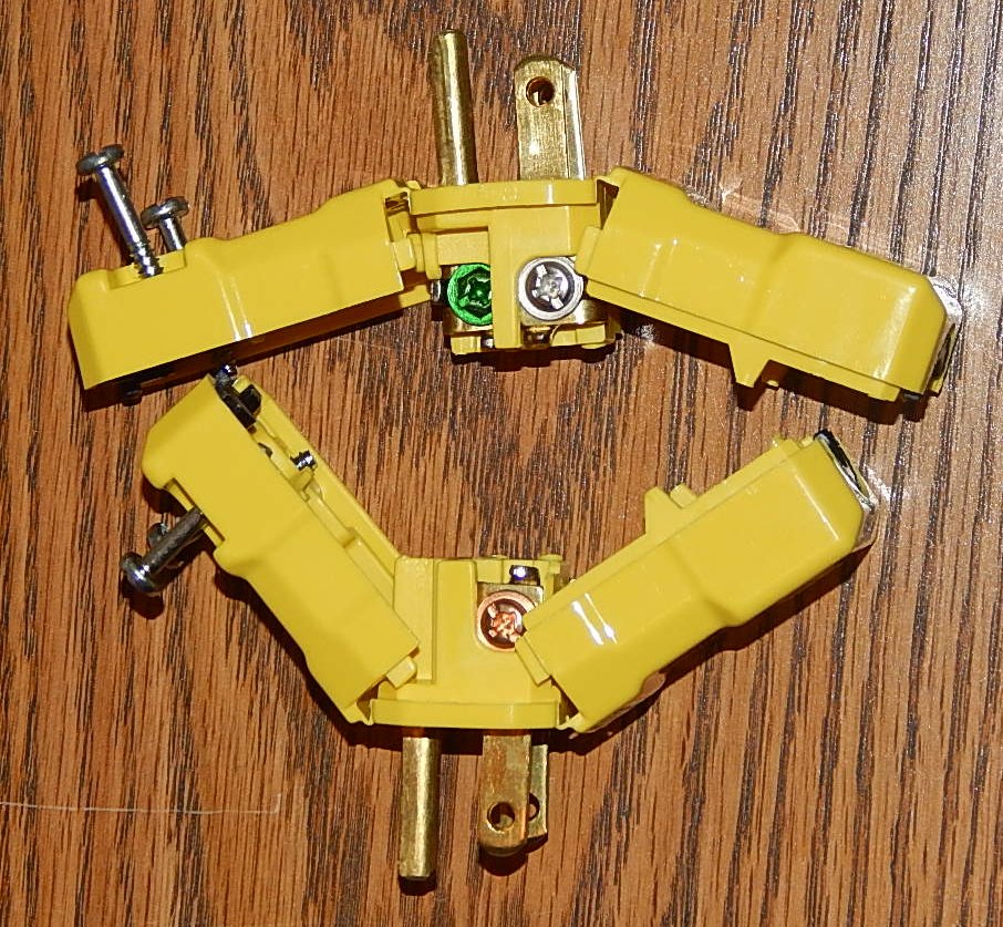

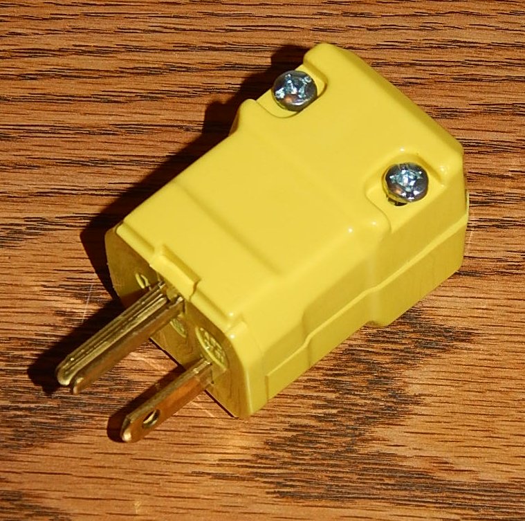

A few photos to go with some of the answers above.

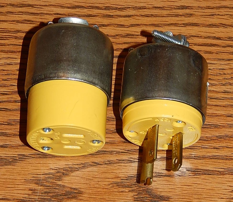

Here's a "valise" style rewireable plug, Hubbell brand in this case; note the terminal screws - plain brass for "hot," silver for neutral, green for ground:

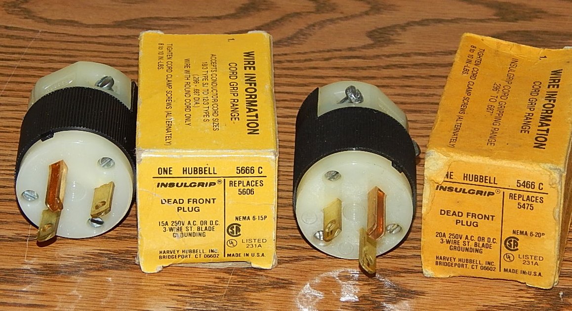

These are armored plugs and sockets, good for making up rugged extension cords or for fitting on power tools (these are Leviton):
Here are a couple of tough nylon bodied plugs (Hubbell again); these are intended for 240V use - note the different blade orientation:

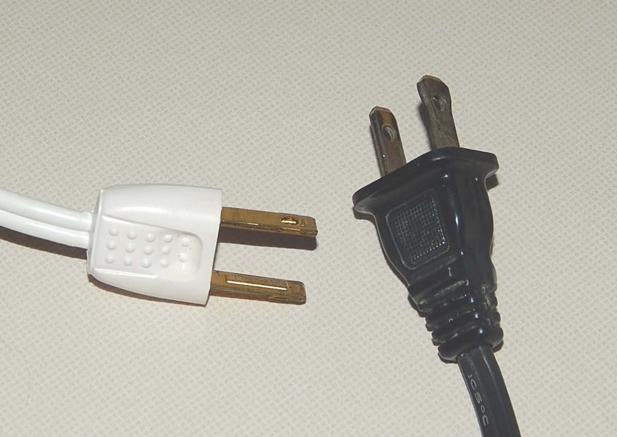

And here's an illustration of the changing style of molded appliance plugs; on left is an older type, 1960's in this case, on the right the current style with a raised "lip" around the front of the plug:
Note also in that last picture the blade with a flared end to make it slightly wider and provide polarization. It seems to have become common nowadays to use polarized plugs even when there's no real need. The plug on the left has identical blades, and so is reversible.

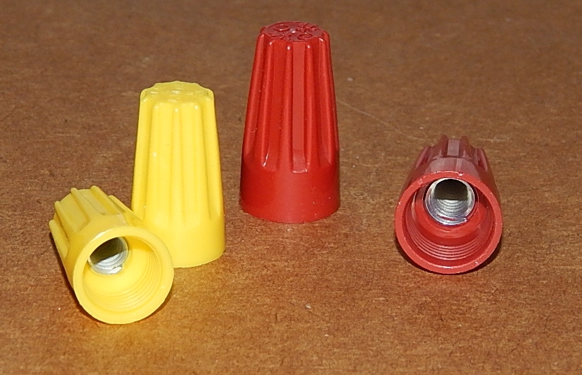

The ubiquitous Wire Nut, seen here in two common sizes for household work:
In this particular range from Ideal, the yellow will take up to four #14 conductors or up to three #12; the red is good for up to four #12 or two #10 (in general, 14 AWG cable is used for 15A circuits, 12 AWG for 20A, and 10 AWG for 30A).

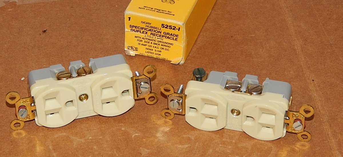

A typical duplex receptacle (Hubbell); note the different color terminal screws again, and the links between the two halves which can be removed to wire them independently:

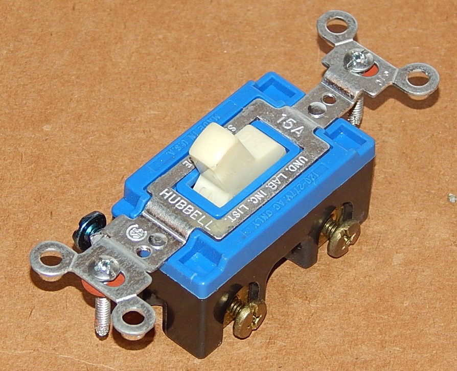

And here's a switch, a commercial type in this partcular example (Hubbell again):
This is NM-type cable (Non Metallic sheathed), commonly known as Romex after a brand name:
The particular example above is 12 AWG. Somewhere just into the beginning of the 21st century the manufacturers adopted a sheath color identification scheme for the smaller sizes: White is #14, yellow is #12, orange is #10. Larger sizes are normally black. With older cables the sheath color was of no significance and could vary. The 3-core (plus ground) versions add red and have the conductors in a spiral rather than being flat-in-line like the British equivalent.

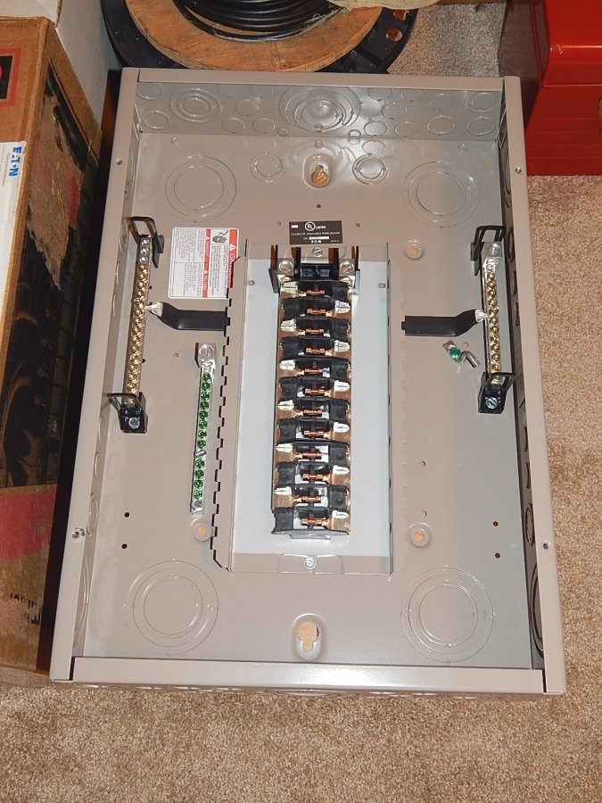

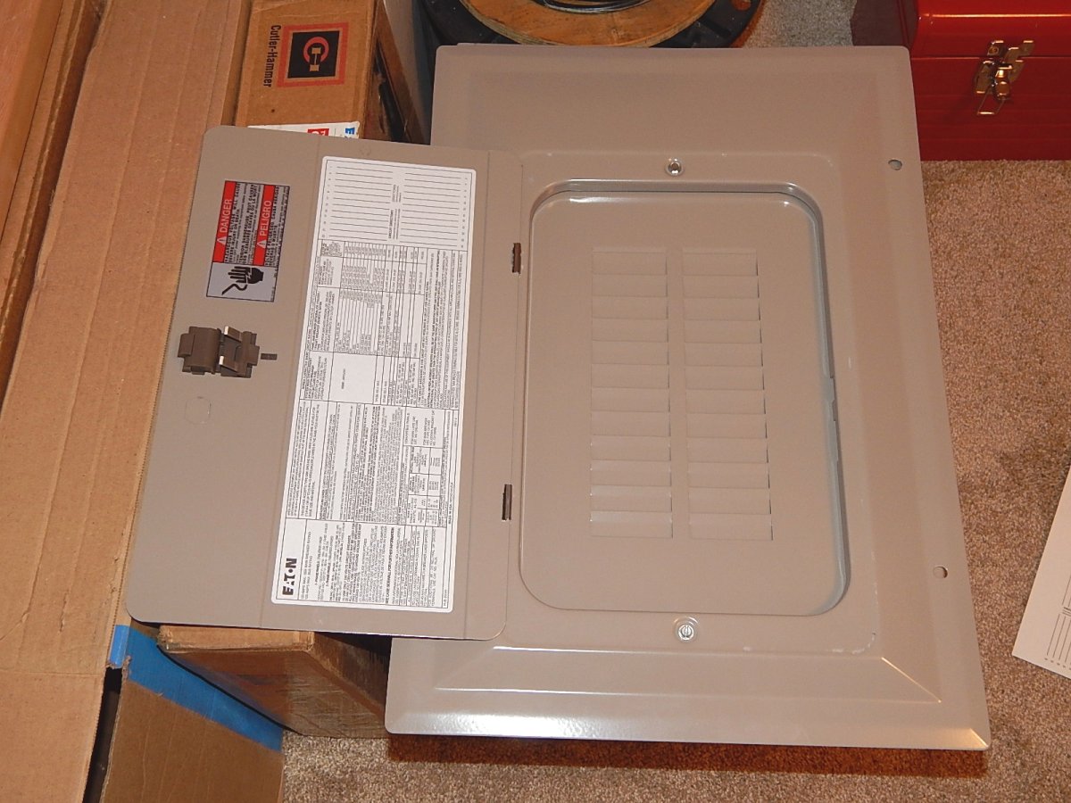

A typical distribution panel - This is a 125A 24-position board I just purchased for the home, Cutler-Hammer CH type (now owned by Eaton):
Note the bonding strap on the right-hand side which can be connected into the neutral bar when used as a main panel, or discarded when used as a sub-panel where neutral & ground are kept separate. (For main panel use, the lugs at the top would normally be replaced with a suitable main breaker as well.)

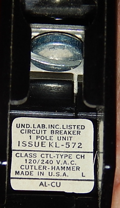

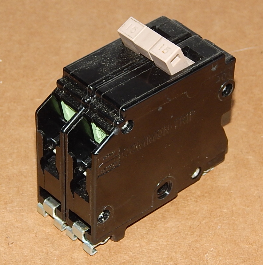

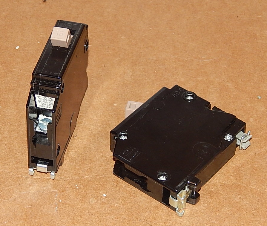

And some of the breakers used with this particular panel:
Whenever I see American MCBs and RCBOs they remind me of the Crabtree C50s of the 1970s - far bulkier and better built than what we have now in Europe. What is the quality like?
Yes, they still have a much more rugged feel to them than the newer MCB's in the U.K. Those Cutler Hammer breakers pictured above are actually a few years old now (1980's manufacture), as I picked up a whole new-old stock batch to use with the new C-H board also pictured, which will be going in as a sub-panel as we remodel the house. But the current production breakers still have a much more solid feel about them than current British types.
