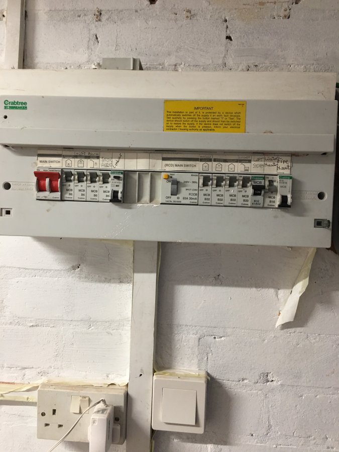

This is the box

Actually the point I was making was that I questioned the use of an RCBO at the start of the thread, because it appears that organisations like NICEIC have been training their MCS course attendees by saying that a PV submain 'must have an RCD because it's a new circuit'.
A number of recent PV installations I have heard about have experienced tripping problems, which were unnecessary because the RCD was redundant.
