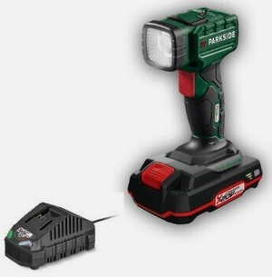

These are great, I have one top of stairs, and need to replace a failed one, I also have these
which fit a selection of power tools, one can get a torch which uses the batteries 1739967230639.pngbut to light automatic with a power cut is not an option. Likely the light would need to be part of the charger, but out of interest are any made which use a larger battery?
The problem is these
typically work for around 3 hours, if a power cut when awake, that's OK loads of other torches, but if while asleep, then it can go flat before one wakes.
I want to get some more 3 way lights, but before I do, thought worth asking, there may be better options.

as an aside i have loads off ryobi 18v official lamps /torches and worklights and some will work on a 4ah battery for up to a week at night light level day and night
otheres give perhaps half a week at about the 80-120 lumens level and 48hs at the 150-200 lumens level
when you get up to the 300 lumen+ your down to the 18-30 hrs level
This is what I was considering, to be able to use the larger batteries I have kicking around. But one daylight comes I can find all torches for the next night, and likely recharge if required during the day, I have two double 13 amp sockets in kitchen battery and solar backed and only use 3 sockets, so by next night not really a problem.
But to wake up at 2 am to go to toilet, and find the emergency light is already discharged, leaves on trying to find the mobile phone to use its torch app, as that is the closest light source to the bed.

Yes - motion activated rechargeable lights would solve this easily.

One of the ones like that which I've got is a bit more clever than that. In the event of a power cut, it comes on fairly dimly - just enough to be able to find it, and then increases to full brightness when one lifts it out of the cradle (which it also does even if there is no power cut). I therefore imagine that it would last a good few hours in that 'dim' state, until I woke up.

i also have 3 official dewalt but they area work lights giving far far more light than needed at 1500l-------2000/1000/500l---------500/250l
but recently to make an order up for a voucher bought generic light and really really like it they make them for the main battery platforms it is still an area type light rather than a torch with a focal point but very compact
dont know iff this link works ?? just select your battery platform
runs for 64hr on a 4ah battery so would not risk a parasitic draw killing the battery overnight although the light shuts down when the battery is at the low level
having said that its perhaps 5 times to bright for a night light but in the hall with a door cracked open may work??
