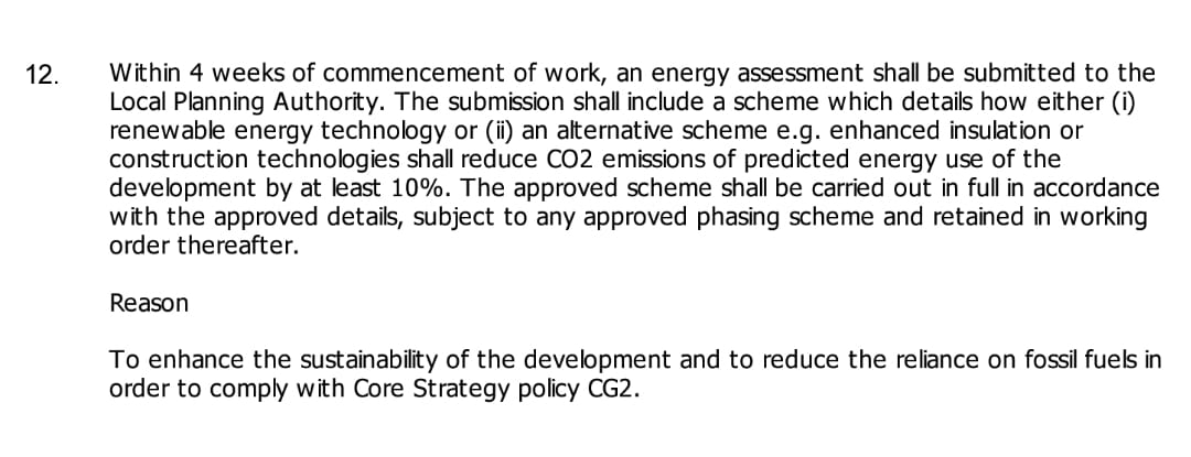

One of the conditions for a renovation project have asked for a energy assessment which shows 10% emissions reduction.
Please see attached condition.
The Energy assement as come back recomending solar paneling (30 Panels) to acheive this reduction. Also been advised by the SAP assessor that if the building control can write a report that adhering to 10% reduction is not required or not needed in them terms then solar panneling can be excluded?
I do understand that but it is a Planning condition does this mean i have to get the condition removed submitting the building control report (thats if he agrees to it)??
A big cost if 30 panels are required

I don't see how BC can write a report saying the 10% reduction is not required. Planners have made it a condition of the approval, so you will need to demonstrate the reduction in order to have the condition discharged. It's up to you how you achieve it, but simply saying it's not required isn't the answer.
Thanks for that. To demonstrate it its recommend 30 solar panels on the roof.
That will be a big cost
The snip says either "renewable technologies" or "enhanced insulation or building techniques"...
Nothing about solar?
Can the 10% not be made up with cavity/floor/ceiling insulation on the renovation project? Or an ashp?
Personally I'd go to an energy assessor and pay him to produce a piece of paper with some number crunching which shows that your proposed insulation levels will result in the required reduction in emissions. No one in the planning department will read the report, let alone have the foggiest idea of what the numbers mean.
In the end, it's all down to bits of paper, with the "correct" result shown on them. Be sensible. Why pay £££££££s to reduce the UK's 1% of world emissions of CO2 by 0.000000000000000001%? How long will the payback period be on a roof of solar panels, which will be scrap within 20-odd years anyway.
