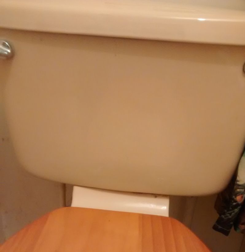

This type of unit.

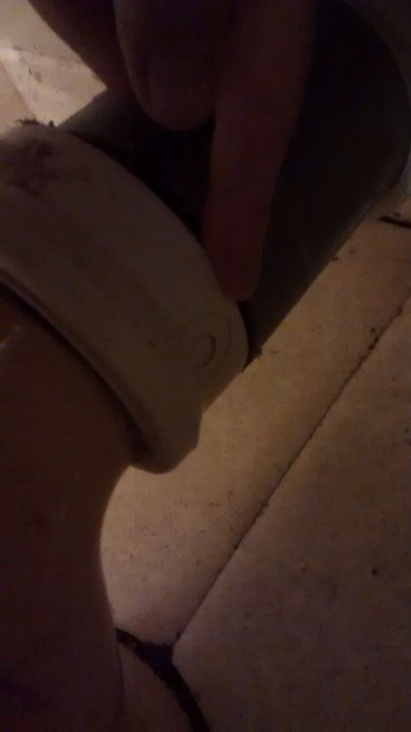

This bit leaked. Not at the front, but where the grey and white meet. Shouldn't that have been glued together? I can rock the whole unit and these parts move all about.

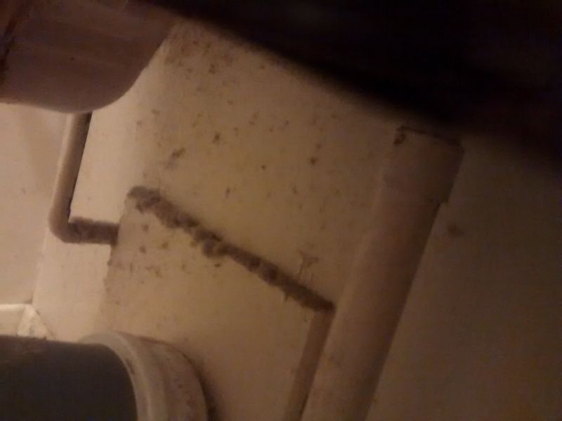

Rigid inlet and overflow.
Never realised it got so dusty under there. :oops:

No, that's the pan connector, there should be fins in there that seal to the inside of the soil pipe. Probably needs replaced if fins are no longer sealing it.

1) The WC pan connector (white thing) is fitted into the soil pipe (grey thing) with a rubber collar - this should be watertight.
2) Nothing should be able to 'rock about' - suggest that you pan need fixing to the floor properly.
3) Check the nearest manhole/inspection chamber - if it's clear then the blockage is likely to be in the soil pipe or stack
If the pan connector is loose in the soil pipe then rodding or plunging will more than likely put more water on the floor - this needs to be fixed first

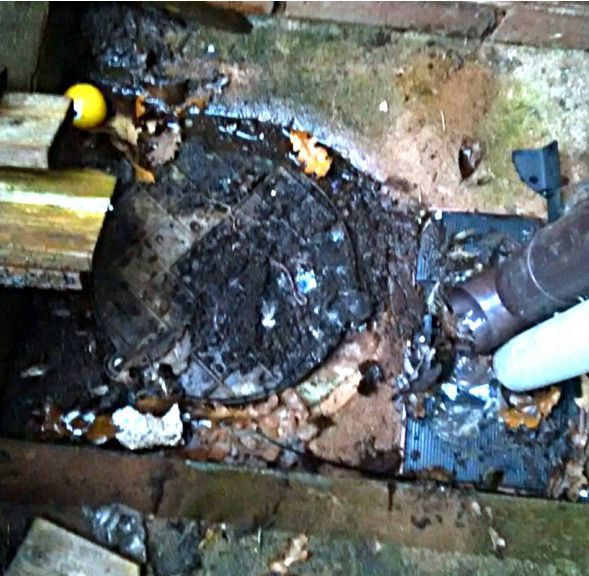

Even more annoyingly, I see that I can't rod the only drain I've got on my patio. It's tiny and it's 4 inches below the patio level in a bloody concrete box!

If it's blocked in the stack or below ground then rodding it from above will not help.
It's either a case of finding an accessible inspection chamber - the one you've found might give a jetting hose some form of access depending on the invert level.
